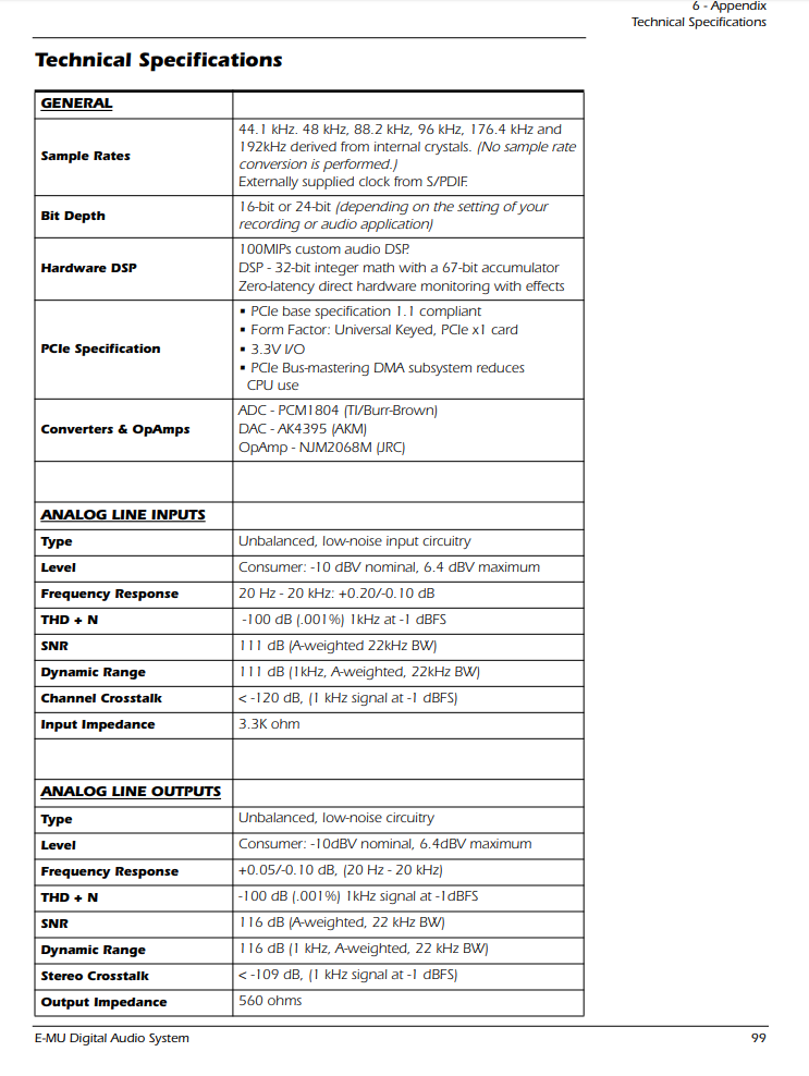

Unfortunately it looks like the EMU0404 PCIe doesn't have the 1Megohm input that the USB version has (I have the USB version) - which allows the use of a 10:1 or 100:1 scope probe as input, and hence to allow direct connection to much higher input voltage levels (so I don't agree with post #13 as a blanket statement).
It also looks like the PCIe doesn't allow 192kHz ?
I do not understand why a lower input impedance would not allow using an input voltage divider. 30k input + 270k in series - 10:1.
If a higher voltage range is needed for measuring amp outputs, the input impedance is quite unimportant since the measured load is single ohms of the speaker dummy load. Tube amps are a different story, but still you can get hundreds of kiloohms at 10:1 and megaohms at higher ratios.

OK, 1M scope probes could not be used. But any voltage divider would do.
Imho there is a significant advantage for newcomers to just purchase a cheap scope 10:1 or 100:1 probe. There is no need to construct a divider that achieves a flat and substantial bandwidth, given some soundcards are now at 96kHz audio range (ie. 192kHz sampling).

Also, 192kHz looks supported based on the spec sheet
