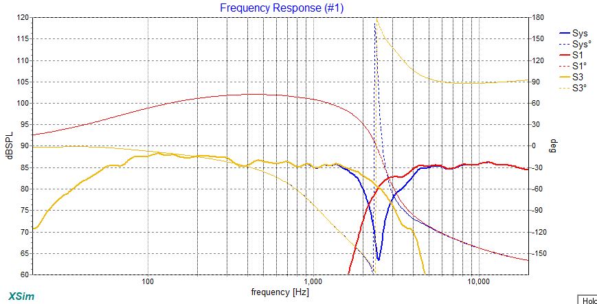

Hi Mark, point taken. It is indeed more complicated to design a 3 way XO as compare the a 2 way system.
Yesterday I found a possible midrange driver candidate and have been trying to simulate a XO using it as a mid driver. It is the Peerless NE123W-08 4" driver. I have the FR curve of the 3 way XO design based on Xsim, if based on this simulated FR curve, do you guys think it will work out? Btw the polarity of the mid driver is inverted for this simulation.
The whole point is, do you correct the data sheet measurements? Because those measurements are quite different from those made when the drivers are mounted in the box.

OK, I'll try to make my point better. This is a Zaph Audio ZA14 as measured by John Krutke on a IEC baffle:
attachment.php
This, again, is the driver mounted in a normal rectangular box:
attachment.php
As you see, rather disturbing differences mainly in the lower region. This is due to the baffle step function. As the differences exceed 5dB, they certainly are noticeable. I hope you see you need measurements of the driver in YOUR box.

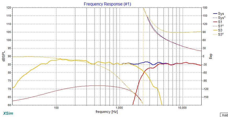

Hi guys, kindly help me out and do a little survey here. If today you are going to build or buy a new pair of speaker, based on the 3 attached FR curves, which one would be your favorite? The one on the left as 1, center as 2 and right as 3. TIA 🙂 .
Wow... that's a nasty difference with and without the box. Thanks for sharing that and now I see why many of you keep advising me to get a measuring mic to do a proper measurement.
Are there not accurate tools to simulate the nicely traced curves on large baffles to ones in small box baffles? Try the "response modeler" to simulate the baffle induced changes and model from there. I also see higher crossover points on the tweeter in most applications. Closer to 3k 4th order.
Which one would you choose?
Your eyes make the choice easy!
But then again....its only a sim, and baffle effects will render any decision made based on those plots, moot.
