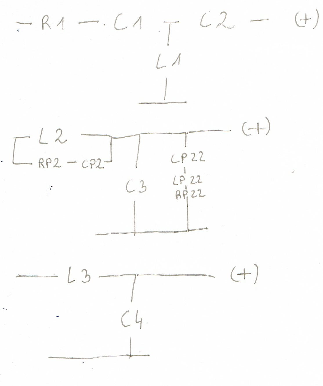

This is the page of Polish 2.5 way design using 17NRXC 8ohm and 26STAC - x-o around 2.1k, one is with sloped baffle, the second example regular coffin.
This one?
R1 - OPORNIK JANTZEN AUDIO SUPERES 2,70 OHM 10W 1% KNP
C1 - MKP 400V 8,20uF CROSS CAP
C2 - MKP 400V 15,00uF CROSS CAP
L1 - 000-1072 Air Core 0,180mH 0,330Ω dr.0,70mm
L2 - 000-1467 Air Core 1,200mH 0,550Ω dr.1,00mm
C3 - MKP 400V 10,00uF CROSS CAP
CP2 - MKP 400V 0,39uF CROSS CAP
RP2 - OPORNIK METALIZOWANY 5W 15,00 OHM
CP22 - BIPOLARNY MDL 100V 27uF
RP22 - OPORNIK METALIZOWANY 5W 8,20 OHM
LP22 - 000-2209 P-Core 1,000mH 0,450Ω dr.0,70mm
L3 - 000-5261 P-Core 6,800mH 0,510Ω dr.1,00mm
C4 - MKP 400V 27uF CROSS CAP
Caps, coils, resistors, ..., etc for x-o - I think it's self explanatory. That one is normal coffin. The first one is for 5deg slopped baffle. I would go with the 5deg slopped - better phase integration and it looks way better. One more thing: the project uses older 17NRX drivers, the new ones require different crossover.
