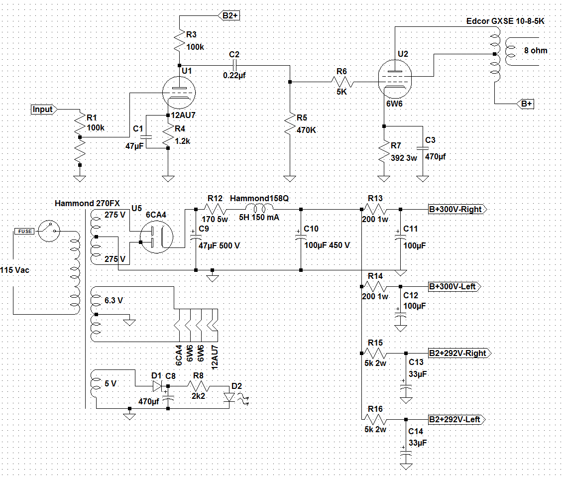

What output tubes? I’ve heard a good things about 300b and 845.
Tube choice does make a difference.
The 845 is an old transmitting tube. I designed and built a single ended amp using the 845 tube and it sounds nice. The 845 does it's best on high voltages, over 1000 volts kind of high. I get 30 watts per channel on 1050 volts. It's over KILL for your speakers and maybe for your health....1000 volts plays for keeps.
The 300B is another good tube. It has such a broad "sweet spot"in its plate curves that it's hard NOT to make a good amp with 300B's. It will give you 8 to 10 watts in a single ended amp, and 20 watts class A push pull, or 30 watts class AB push pull. I have done both SE and P-P amps with the 300B. It's also the most popular tube choice for the TSE board. They are not cheap tubes though. I got some Chinese and Russian 300B's nearly 20 years ago and they were $30 to $50 each. I haven't checked prices lately. There are premium brands that go well into the hundreds of dollars EACH, and NOS Western Electrics are in the thousands! I was present whey we ran a bunch of different 300B's through a TSE with $10,000 Lowther based speakers. Some people could reliably pick out the WE tubes, but I could not.

Thanks a lot for your advice.
I did some reasearch today. I looked through various designs,
Then I measured how loud I usually listen to the music. It turned out that I usually don’t turn it up to more than 85db.
Considering this I think something like 10 watts would be more then enough. Taking into account that 85db from my speakers is about .01 watt.
Now I am torn between SE vs PP design. Though lean more towards SE. I have quite broad interests in music from rock to metal to jazz and classical.
Is there SE design that will give tighter bass response? Lots of the designs I saw use either cathode bias with resistor or ccs for power tube. Would fixed bias help with bass response? What SE design has widest bandwidth, provided that transformer is of highest quality?

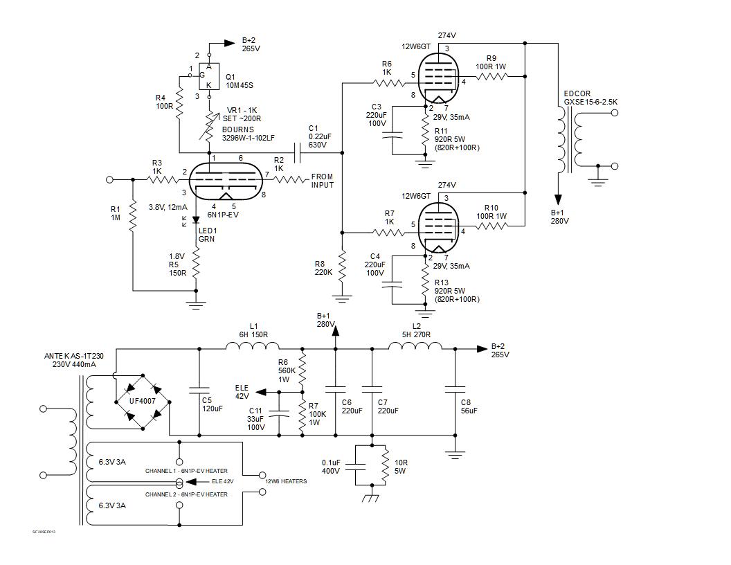

Hi guitarist1977, I just want to share my experience, on the last years I built 3 amp, a 30+30 W PP on RCA schematic, very powerful and I thought that’s it I got a fantastic amp in my system, then came across a schematic of a low power amp just 1.3 watt SE based on TV Vertical tubes 6CY7 and I was blowed away by the sound stage, really awesome capable also to drive my Fostex FE206En Full Range 96dB, then I recently build again a SE based on a forgotten tube also very inexpensive 6W6, total power 3.9 watt x channel, THD 0.80%, again awesome sound stage and power for a little 3.9watt, here schematic, so I really realise for my taste SE are much better than PP, also simplicity is also in my opinion a key point, regarding power transformer and OPT I am very happy with Edcor and Hammond….best regards
Brilliant idea so with two tubes same heater current of one tube but twice the power
I don't think it works that way, but I'll wait for Scott17 to reply.
Good work!
Individual bias for each of the parallel tubes.
The Parallel SE OPT has 1/2 the primary impedance of the single tube SE OPT (also, it must not saturate at the new 2X current).
Individual grid stopper resistors.
Always be careful to design the driver stage to drive 2x the capacitance when you double the output tubes.

Yes thanks. The output impedance of the paralleled driver stage is about 2200 ohms. I don't know what the Miller capacitance of the 12W6GT is, and to be honest I didn't give it much thought with the low impedance driver, but say it is 200pF x 2 = 400pF. If my calculations are correct, the -3dB point would be 74KHz.
The output transformers are rated at 15W so they are OK for 70mA. I read on a Edcor blog that the GXSE are rated at 100mA.
This is one of the best sounding amps I have. Highly recommended to build.

This is the current version of the circuit I am running. The tubes could be run a little hotter by leaving out the series 100R resistor, but I chose to run them at a less current.
For the sake of accuracy:
1. The grid resistor for the paralleled 6N1P should be 330K.
2. Parallel a 470R resistor with the CCS potentiometer for safety.
