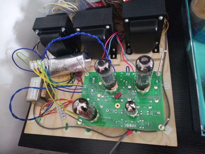

Right now I'm building one using expensive Electra-Print 5K OPTs (got a deal on them) and a Hammond 374BX (Switzerland, 230V) as power transformer. I have another SSE in the queue using all 3 transformers from Ogonowski.eu. Leszek has good credits from other people and attractive prices, 6 weeks delivery, I'm expecting mine within a few weeks so no personal experience yet.
soon to be tested SSE, with EL34, Hammond & Electra-Print, PSU choke and motor-run cap. Yep, the wires are long, but that's only a functional test.

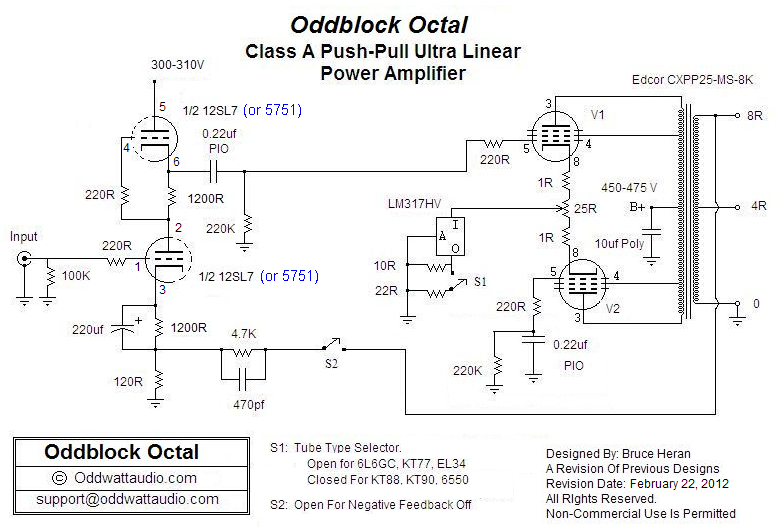

A few more for your consideration. I have built both of these. I prefer the EL84 amp for it's simplicity and surprisingly good tone. The other is quite good and flexible. For your power requirements, the EL84 amp would give you in the neighborhood of 10-15 very loud watts.

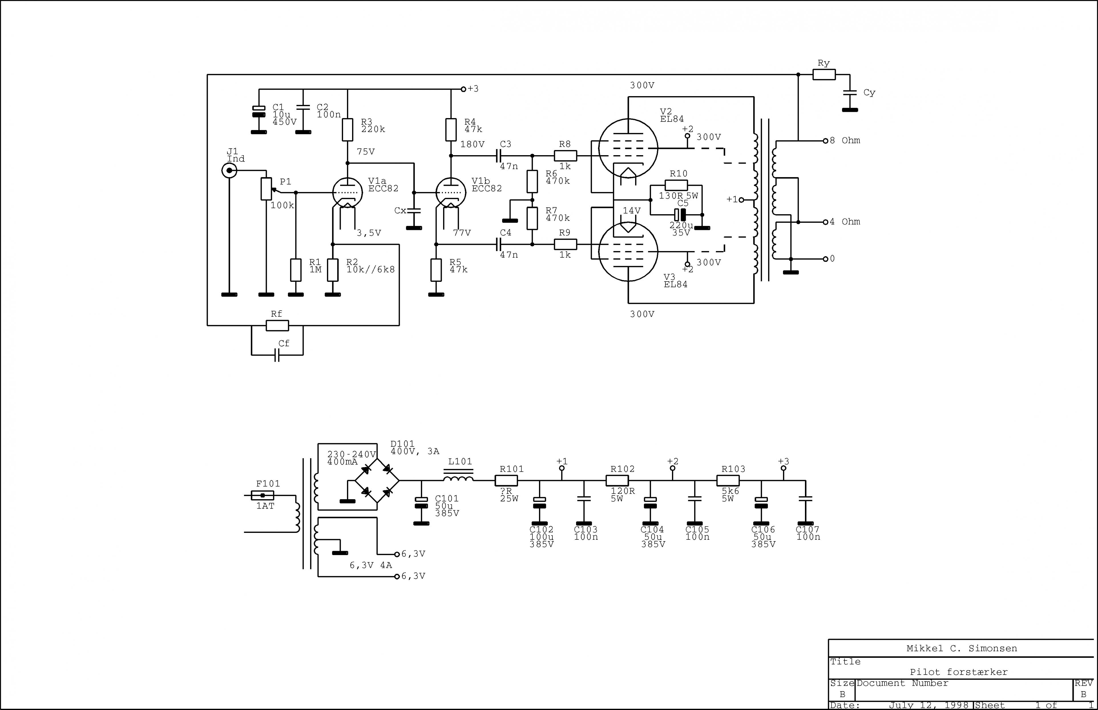

You may find further interesting ideas within your stated budget on the technical informations / schematics section of the lundahltransformers.com web site. Lundahl transformers have a good audiphile reputation. The easy to build EL34 SE 8W amplifier presented on that section had been popular at the time and is still a good design, on my opinion.
