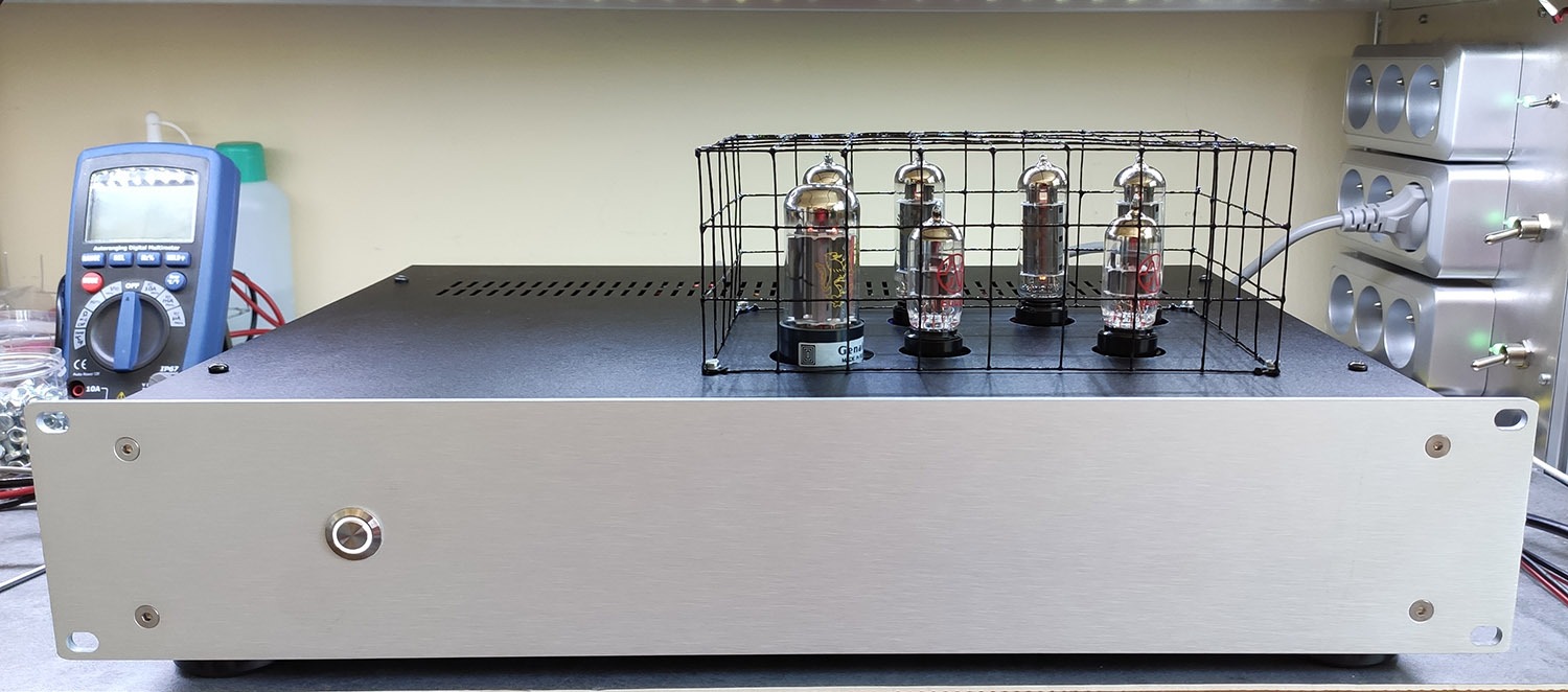

Tubelab Simple Push-Pull EL84.
Proven design, works great and easy enough to build for a valve noob like me.
Here is my rendition:
I have built 4 different el 84 pp the last 30years. The Tubelab SPP are the best! I built mine p2p soldering. Hammond transformersTubelab Simple Push-Pull EL84.
