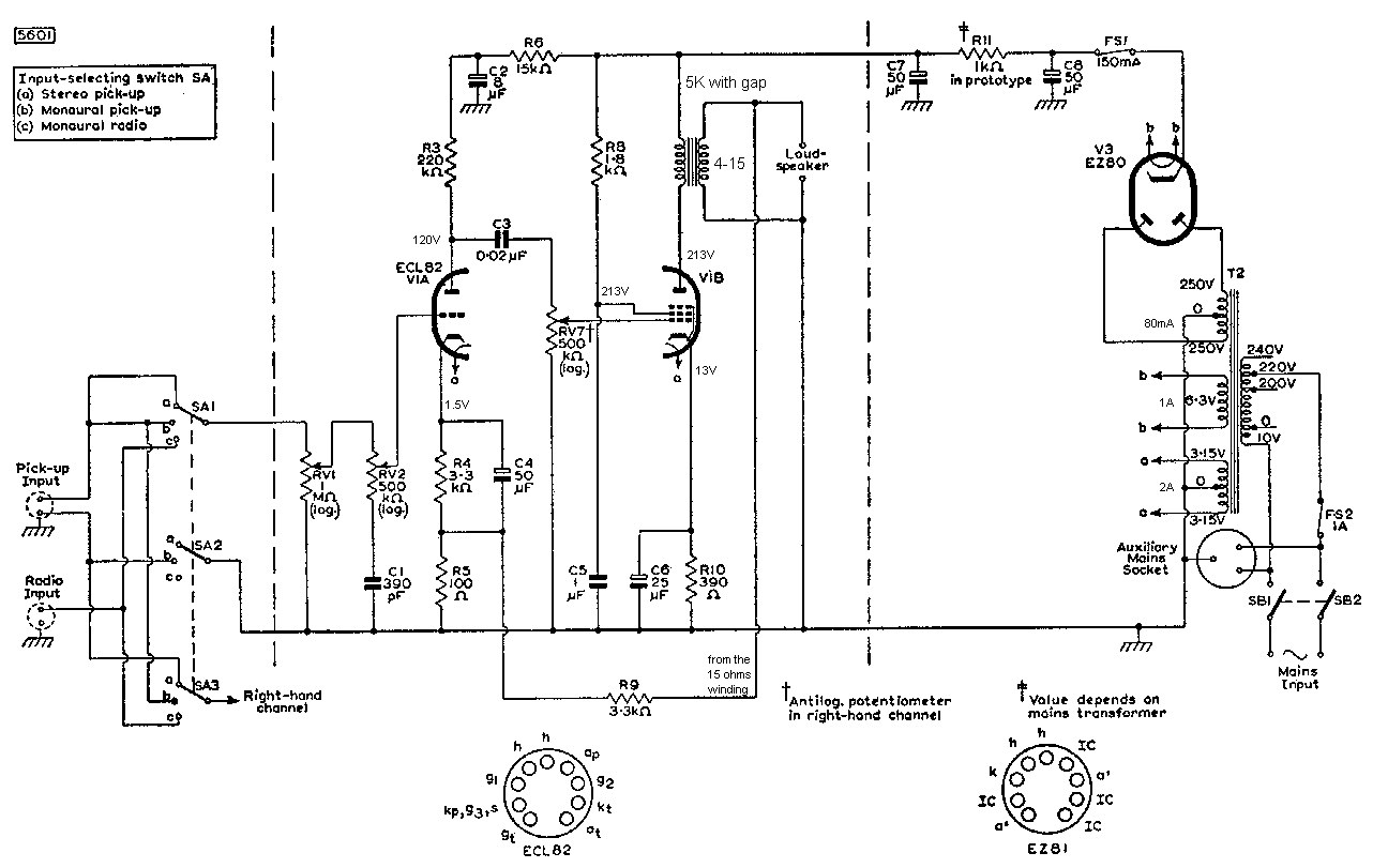

Mullard ECL82 SE
Hi, Wigwam,
Eli got in touch with me to call attention to this thread. Here is the original Mullard ECL82 SE amp.
I'll follow this with the 6BM8 build we worked on. It sounds very good and is inexpensive.
--Jeff

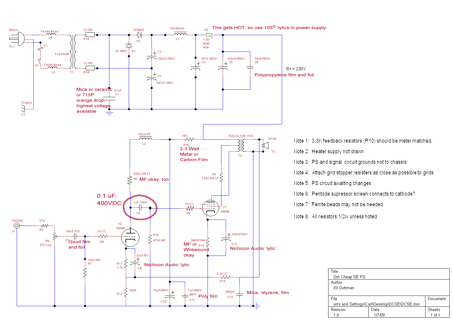

"Dirt Cheap SE" -- 6BM8 amp
Hi, again,
Here is the schematic for a 6BM8 SE amp based on the Mullard ECL82 idea. We added a UL tap with the Edcor output transformer, and modified the feedback with a cap. to ground to produce a cutoff at a couple hundred KHz. A resistor in line with the VC pot at input helps broaden control and saves from overdriving.
This version of the schematic supplies a few additional or corrective notes on components and values.
This design yields an amp that is easy to listen to. It can fill a medium sized room with sound, but it doesn't go super loud with most 84 - 87 dB/W/meter speakers. Nonetheless, I find it most satisfying. YMMV, especially if you try it with more efficient speakers.
--Jeff

Thank you! This is quite understandable except for C5. Not clear on what it does?
C5 decouples R8, the screen resistor. It functions as a part of the screen power supply source. R8 drops the screen voltage to a value less than the main plate voltage, and an RC network helps filter and stabilize the voltage.
Eli's suggestion to run this in full pentode mode (given your output transformers) means keeping that screen supply in place, where the 6BM8 schem pulls the screen supply from the Ultralinear tap on the output transformer. I also second Eli's suggestion for the input capacitor. That way you can crank up the volume a little more without sending so much bass through the output transformers that they saturate and/or distort.

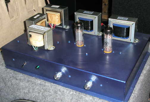

Here's my version of the 6BM8 Dirt Cheap SE, using an inverted commercial cake pan for the chassis.
The OPTs aren't all that big, either. I like to build with dual volume controls to assist with fine tuning balance in my rather unsymmetrical listening areas. Sounds great with a subwoofer, too. Also, I reduced the value of the first input resistors by about half, and have not run into overdriving concers.
Whatever you end up building, I'm sure it will sound great.
--Jeff
