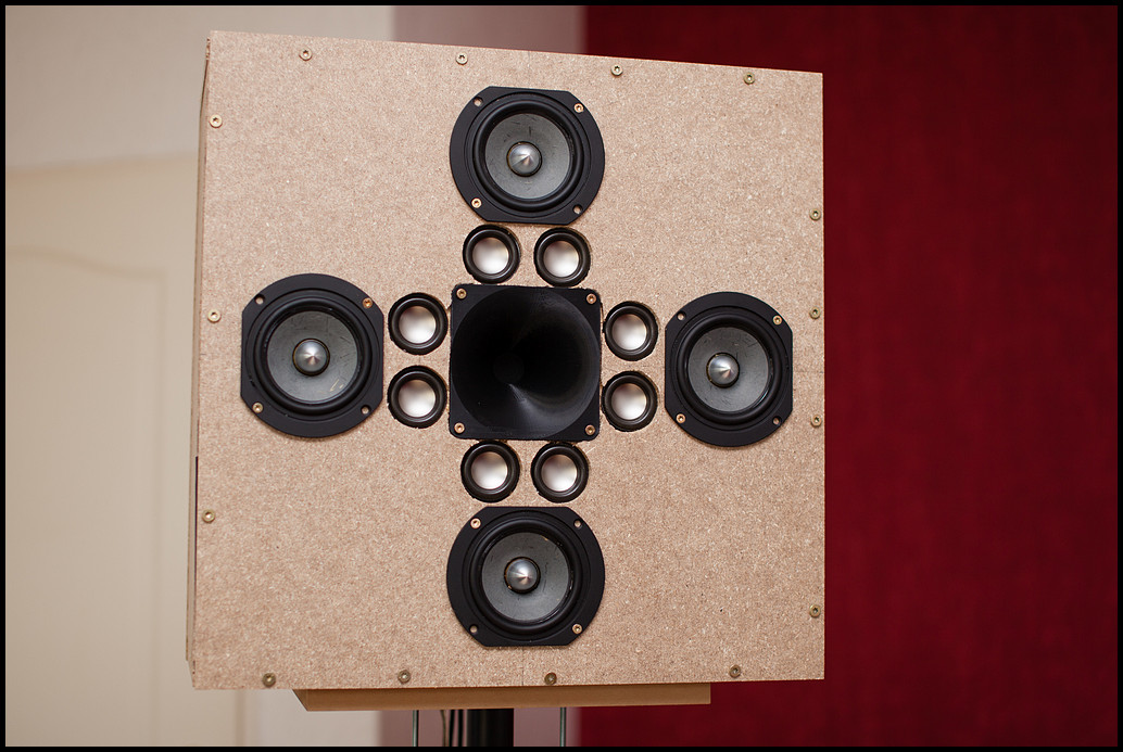

I've mentioned before that I thought the treble on Bill's "small syns" is superior to the SH50 by a little bit. I'd always assumed this was because Bill is using a SEOS waveguide and Danley is using a conical horn.
Better horns sound better. This is not a fluke in my experience.

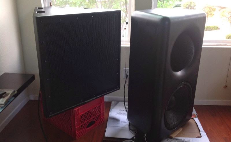

Is WAF (wife acceptance factor) an issue? You can buy about five pairs of Danley SH-50 for the cost of an average divorce. 😀 I can at least lay claim to having heard a pair ... very briefly ... at the factory.
An older, and about 4x cheaper option is the older Yorkville Unity U15. Not all the way to a Synergy, but cheap and loud and even nearly 20 years later, I doubt you could build anything equivalent for much cheaper. Rather than a few pathetic clones I attempted (I am carpentry-challenged), I lucked onto a pair of used U15 and am quite pleased with them. I don't claim Synergy like performance, but mine are actively EQ-ed so I am fully responsible for how lousy they sound 🙂
