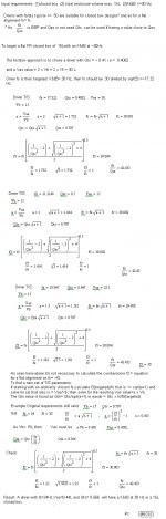

Sorry Tinitus, didnt mean it to look like that, I just heard they sound v good ! Yours and Mayhems post were good reading actually, all interesting and very valid points. My only reason for going small with the volume is for aesthetics . My goal is an f3 of 30 hz
then you should be fine with a closed design
only make sure Fs is low, and Qts not too low
most likely have -6db at 30hz
Agree:Here is a reuse of a recently posted picture:
http://www.diyaudio.com/forums/subw...rs-music-only-sealed-cabinet.html#post2360009
b🙂
