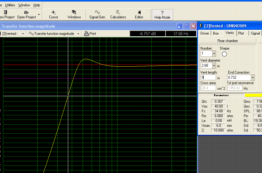

]UPDATE
I've simulated the frequency response by raising the resonance frequency of the box to 43, show is the Graph below. I also did this with my test box and my current driver. Efficiency increased a little. But as an experiment i've tried also to tune the box to 25hz in order to see if i can extend the low frequency response. But turned out increased excursion and distortion from the driver. And also port noise is audible.
This system has low end boost using SUBWOOFER EQ from ESP project (sound.westhost.com) P48 and with 30Hz high pass filter protection.
I wonder if i can increase box size a bit more(maybe 45 L max) in order to extend low frequency response and at the same time increase efficiency by using some equalization at the passband. thanks
