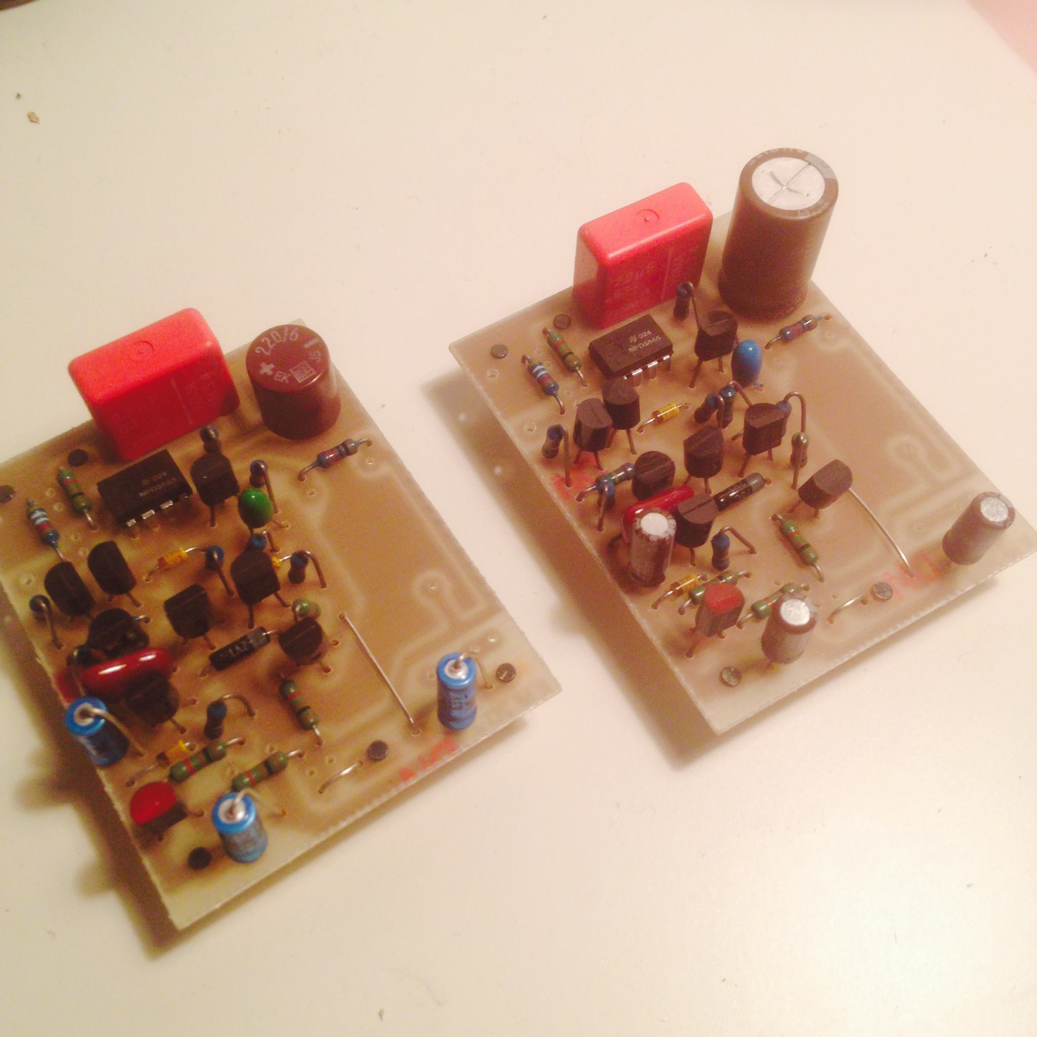

Recommandations for electrolytic capacitors / preamp recap
Picture of the line-level preamp modules,
left with the old caps (roderstein EK - philips blue axial)
right with the new Elna Silmic II caps
