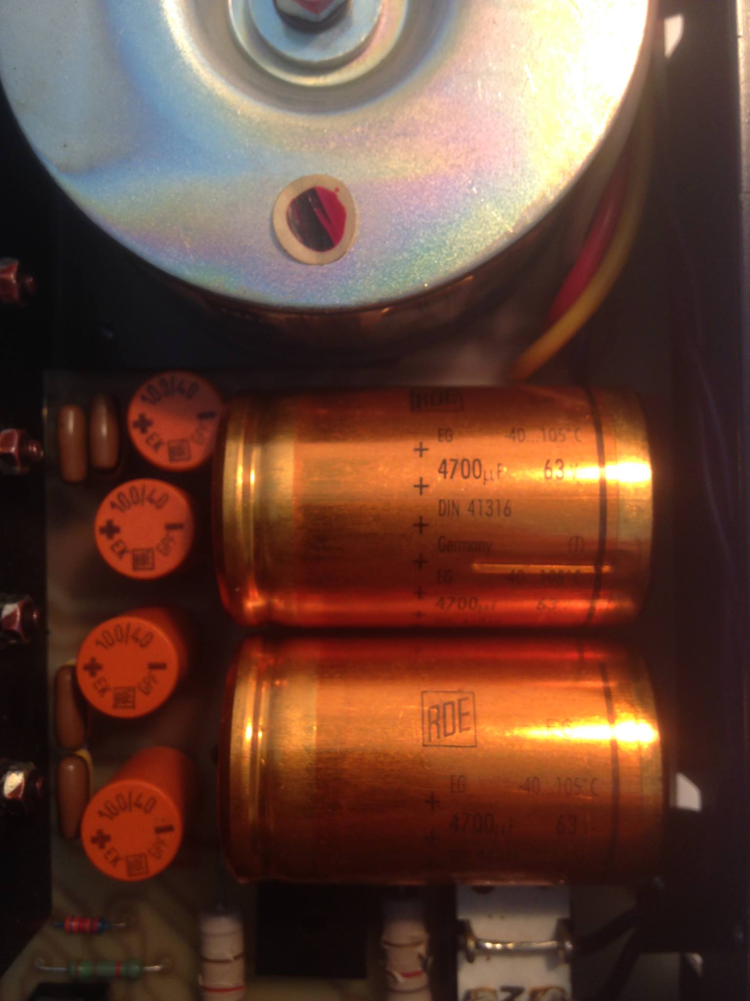

I'm about to recap my Korn&Macway preamp.
I've just replaced the main PSU caps and the change I hear (for the better, and not by a small margin) encourages me to change the smaller decoupling caps as well.
I'm considering Elna Silmic II, seeing the good results I got from using those in my CD player, but maybe there are some options I'm not aware of, open to suggestions!

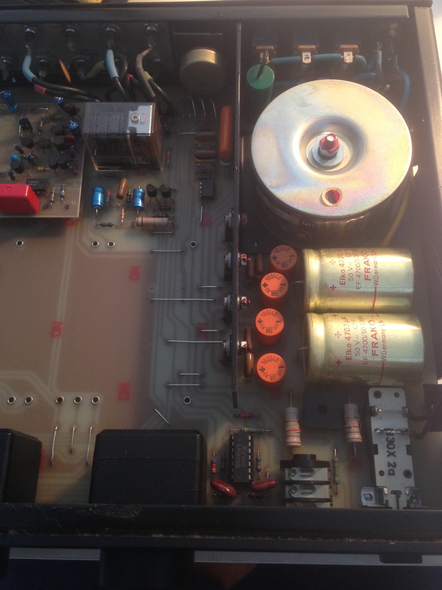

I've already changed the two 4700uF
I need:
100uF / 40v x4
1000uF / 10v (?) x4
220uF / 6v (?) x2
2,2uF / 63v x18
10uF / 63v x2
values based on what i read on the original caps, there's no schematics available for that rare made in Belgium preamp.

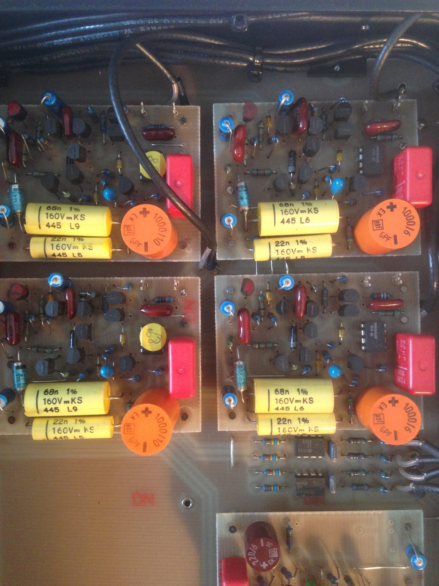

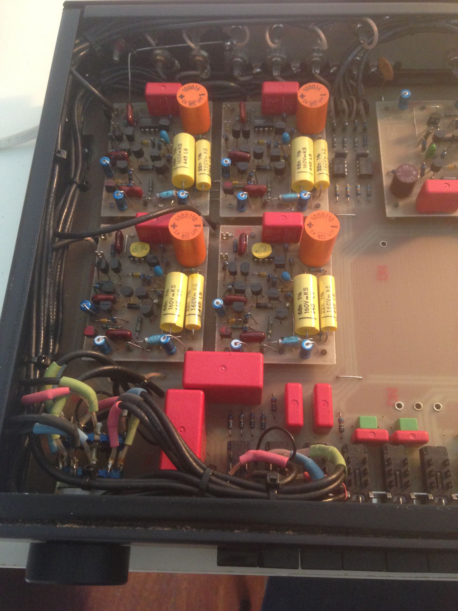

some pictures

Well, so far I've had two full recaps done: first was an SAE Mark 1B (1976) preamplifier, recapped by professionals ; second was my revox B226 CD player (1987)
both recaps transformed fully functional, not noisy or humming, but mediocre-sounding units into very good sounding equipment...
On this KM preamp I'm about to do now, nothing except age (1980's) would let anyone believe it's in need of a recap; yet just changing two caps already made a significant difference.
I will therefore consider that any device older than, say, 20 years must be recapped if serious evaluation of its sonic capabilities is expected.

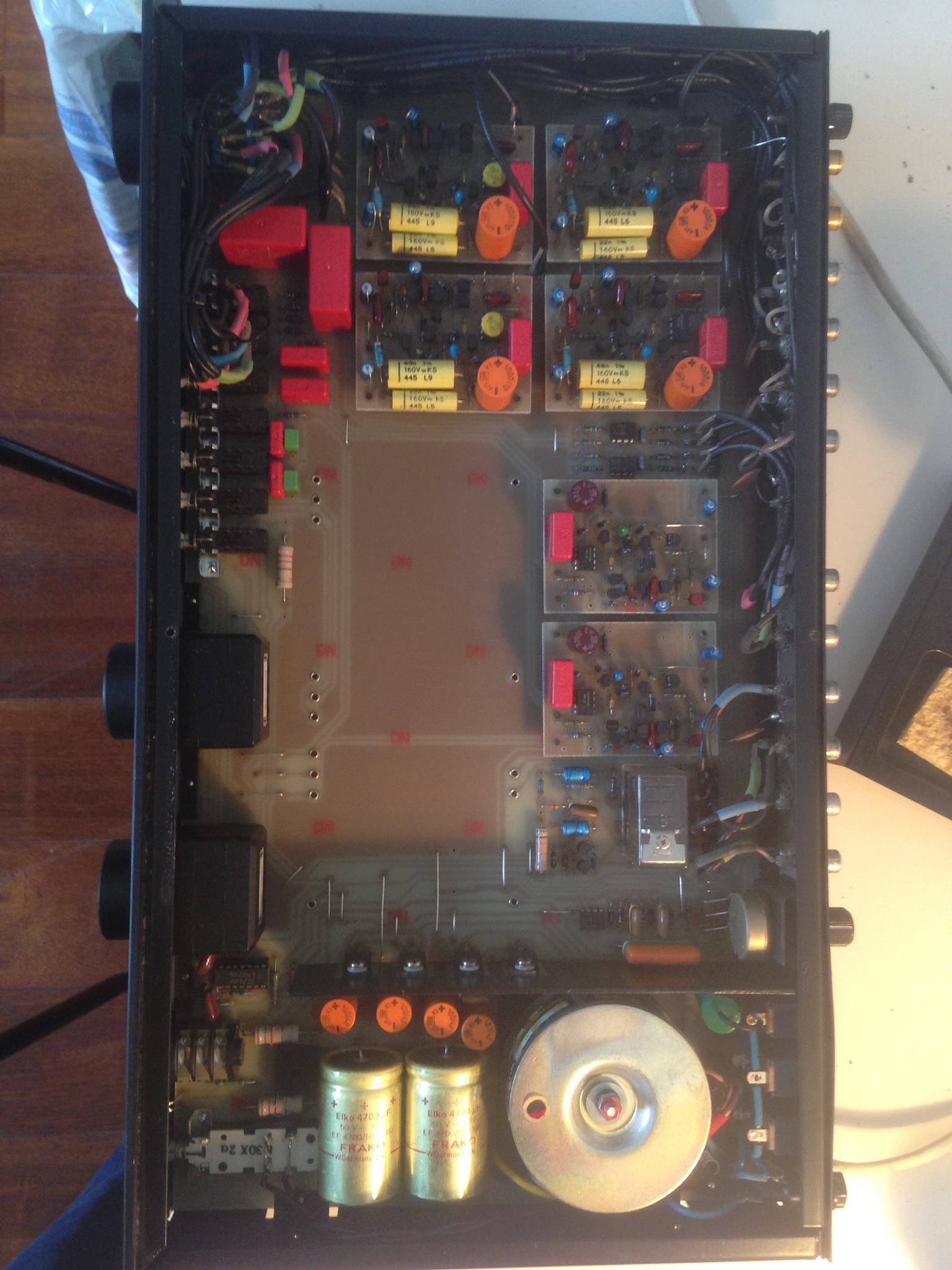

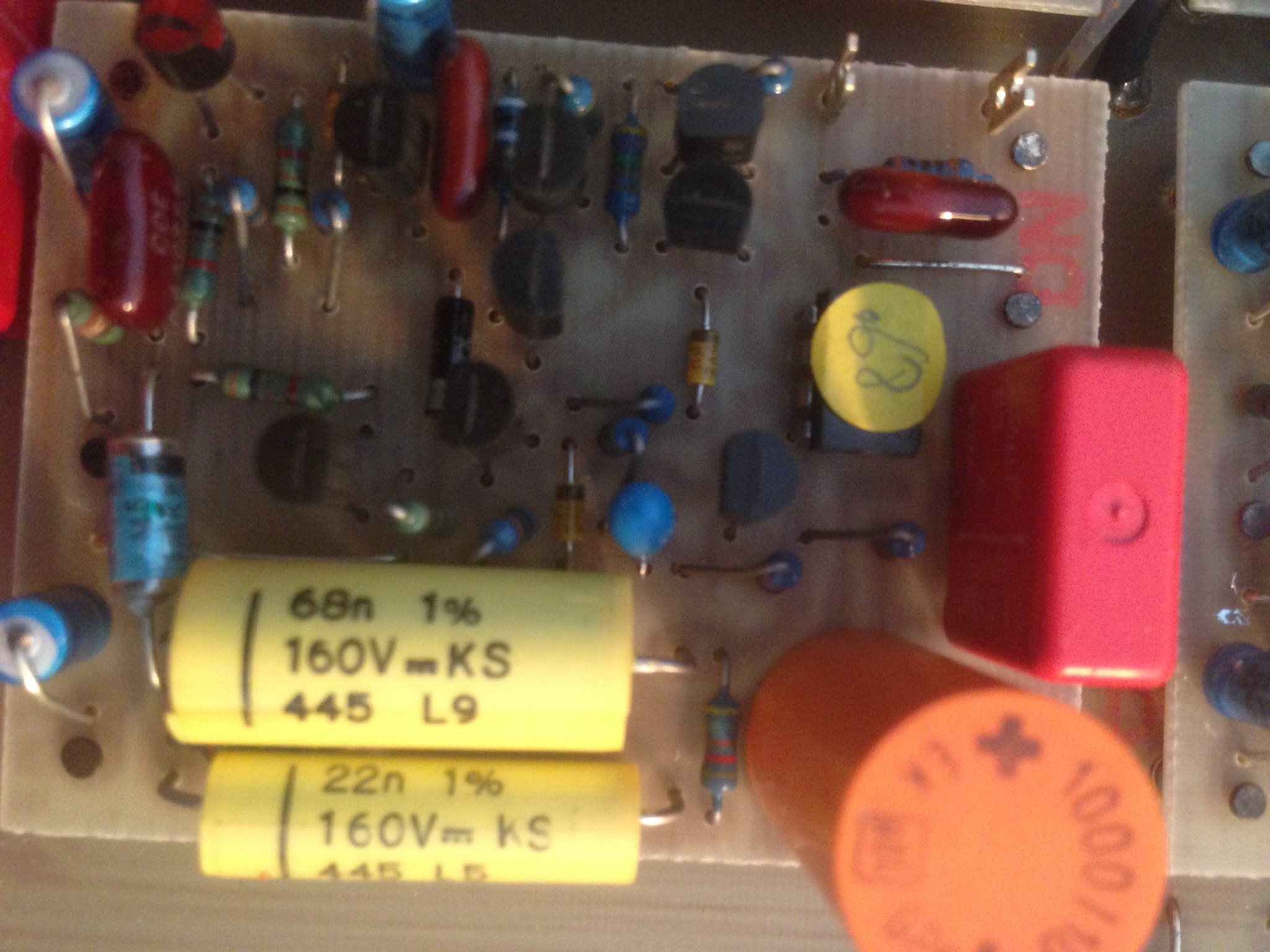

There's 18 small 2,2uF electrolytics in my preamp
for those I consider elna silmic II, but browsing around I see that I can buy the same Roederstein shiny blue axial caps as the originals, new old stock, would that make any sense? do small caps have better or worse shelf life than big caps?
same goes for the 1000uF 10v on the MM and MC modules, they are originally Roederstein bakelite caps, I'm tempted to replace with Elna Silmic II or Nichicon KZ, but both might prove too high for the slim case of the preamplifier; the original bakelite caps are much shorter.
I can buy those "new old stock" as well, but again?..

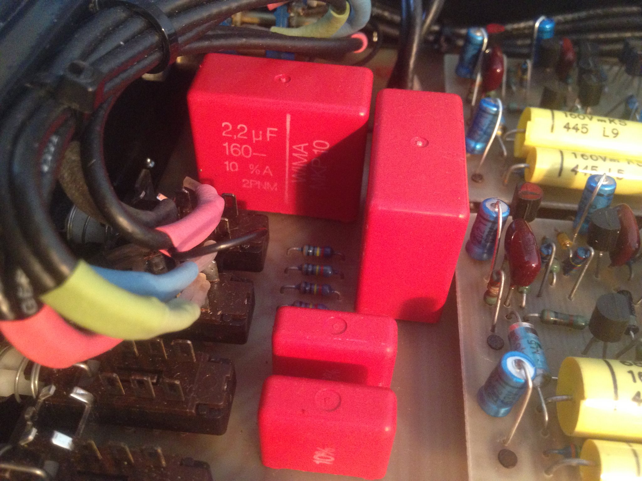

2,2uF >> WIMA MKS ?
those would fit!
mkp please....
MKP is four times the size and won't fit. There are 18 of those 2,2uF, and not much space! Isn't MKS better than electrolytic?

I've ordered everything in Elna Silmic II. The four 100uF 40v that are on the PSU board just after the two 4700uF I've ordered NOS Roederstein "golden bullets" EKM series. The two 4700uF are NOS Roederstein and they sound soooooo good, I wanna give these a try. I will compare between that and Elna before recapping the rest. I don't dare to use tantalums because I don't have the schematics and I'm not good enough in electronics to always see wich caps is on the signal path and wich cap isn't. Tantalum dosn't have such a briliant reputation (I guess?), even tho Naim uses them a lot in their gear...
For the best results, replace like with like. NOS are old are will need reforming before use, if they can be reformed.
Performed the recap last night.

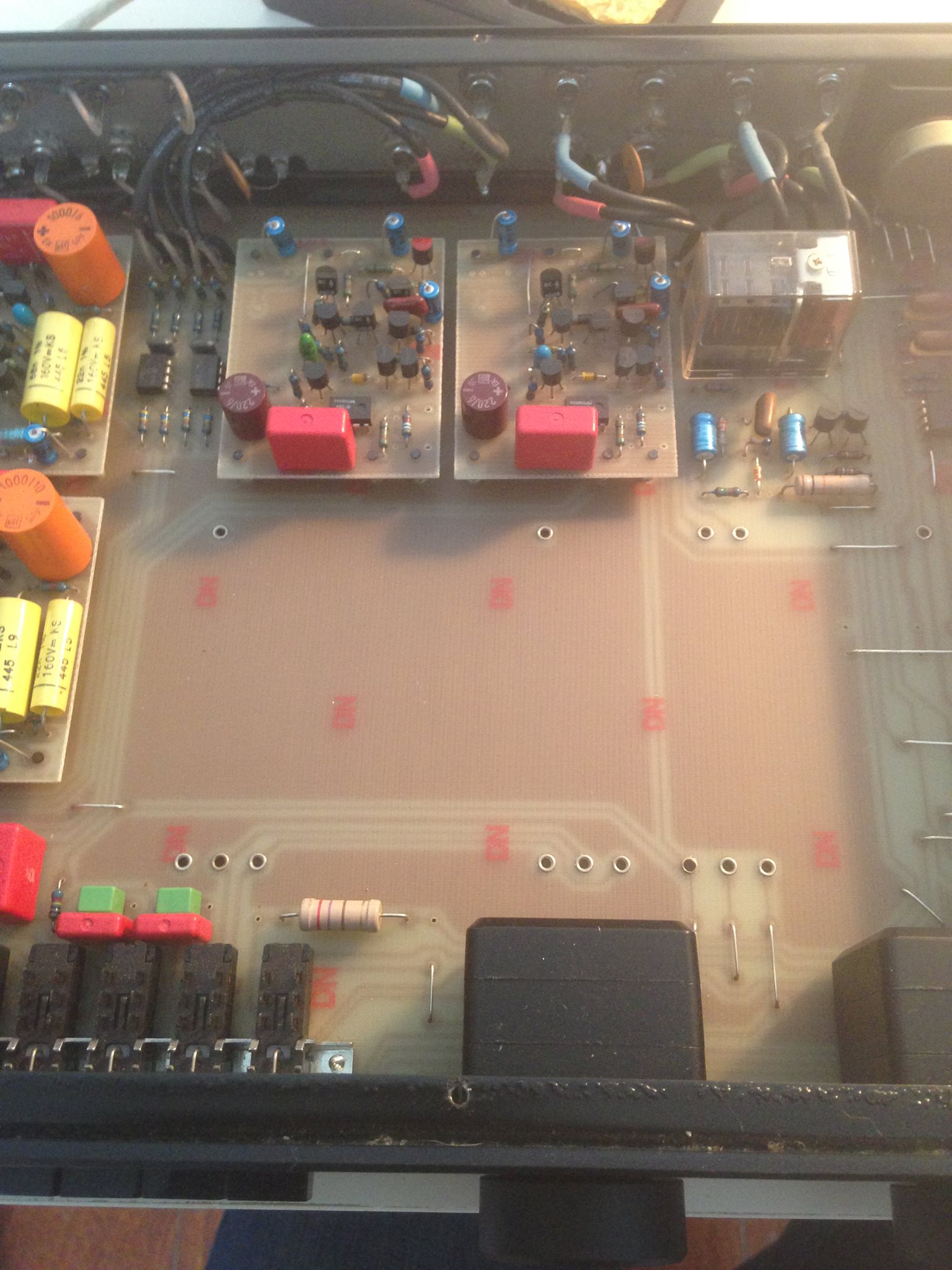

Due to the difficulty of taking the unit apart (line level preamp modules on separate PCBs, a half inch above main PCB/ground plane, soldered to it), I had to do all caps at once. The MM and MC phono pcbs I will tackle later, as I'm not using vinyl as a source for now.
Well... right now the sound is quite disappointing; extreme frequencies are bloated like an amplifier trying too hard to impress (entry-level NAD style 😀 )
BUT I experienced similar result when recapping my Revox B226. Silmics II take a long time to bed in and open up greatly after between 50 and 100hours. These have seen only 5 hours of music so far.
I'll wait at least one week before making a definitive judgement on the sound.
