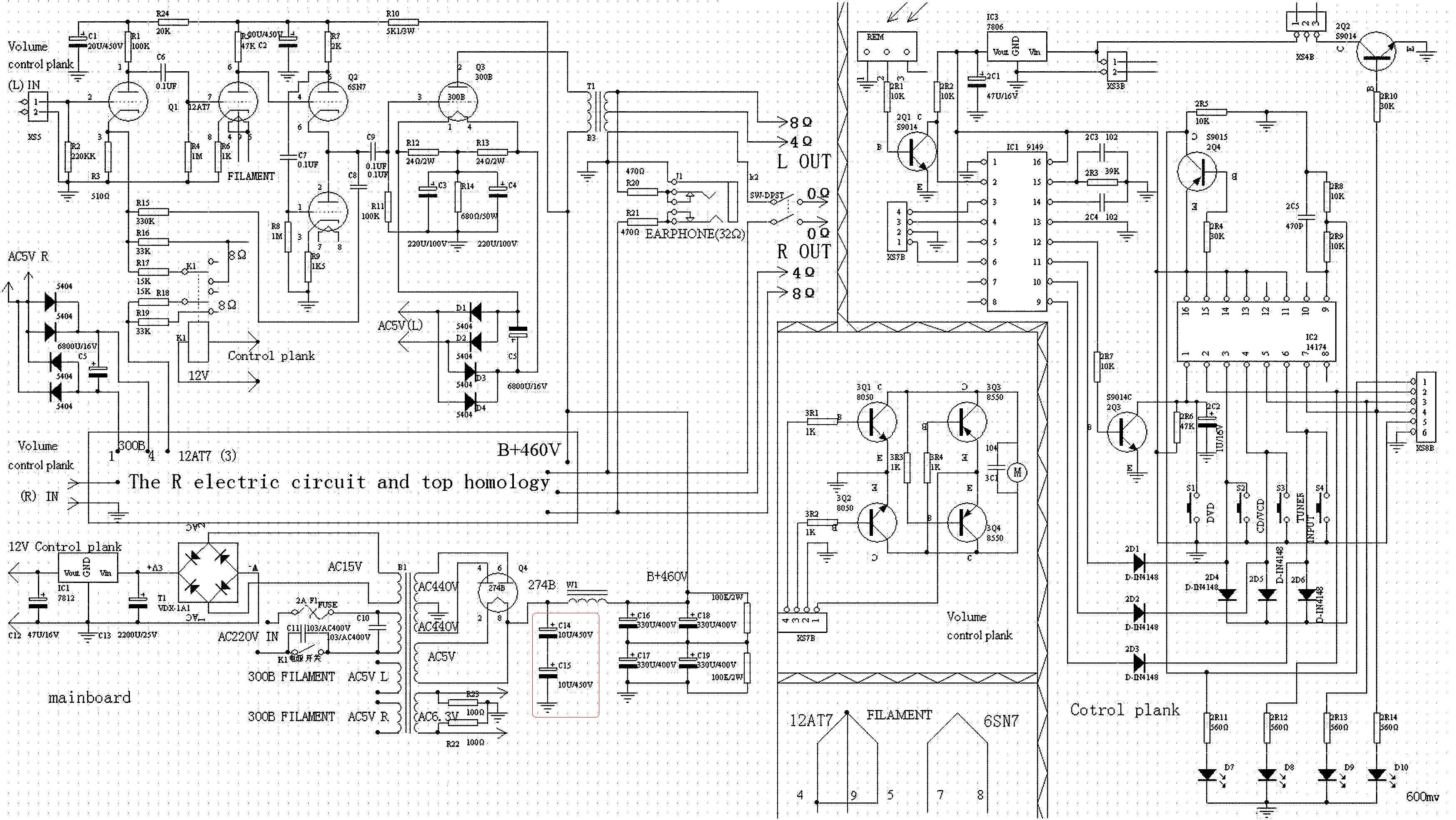

The schematic for the 300B is attached here with my notes on recommended changes by folks who know way more than I ever will. Some of the changes bring the 300B closer to the 300C (supposed to be better). Other changes dial down B+ on the 300's as they are running at or above spec... Besides the notes, im trying to figure out the best way to get some filtered DC to the heaters...
Have any other ideas where improvements could be made ?

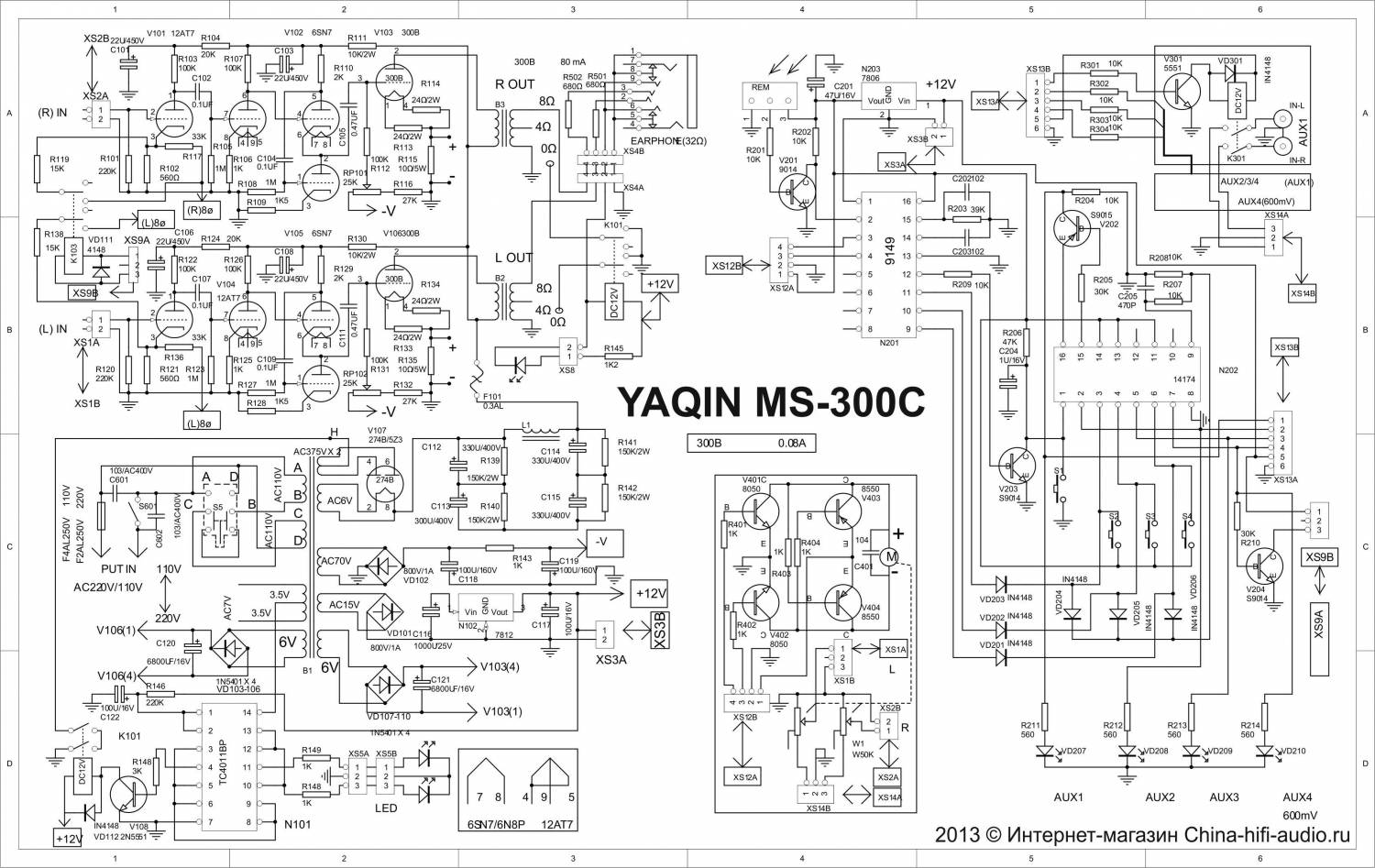

The B+ dropping resistors on the C version are rated 2 watts. One of them failed and I replaced both of them with 5 watt parts.
On the B version that would be resistor R10 on the channel shown. It is a 3 watt part but if it were mine I would replace it with a 5 watt part.
Steve
