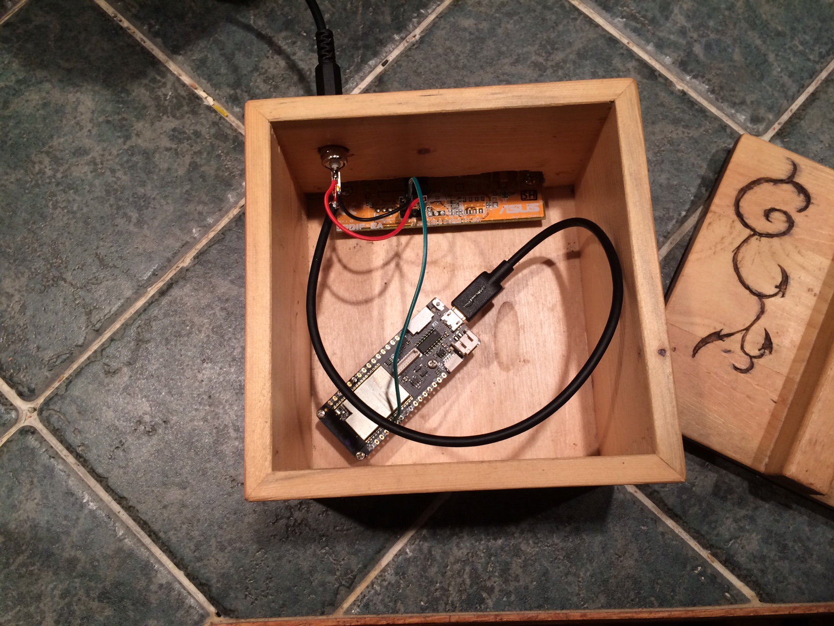

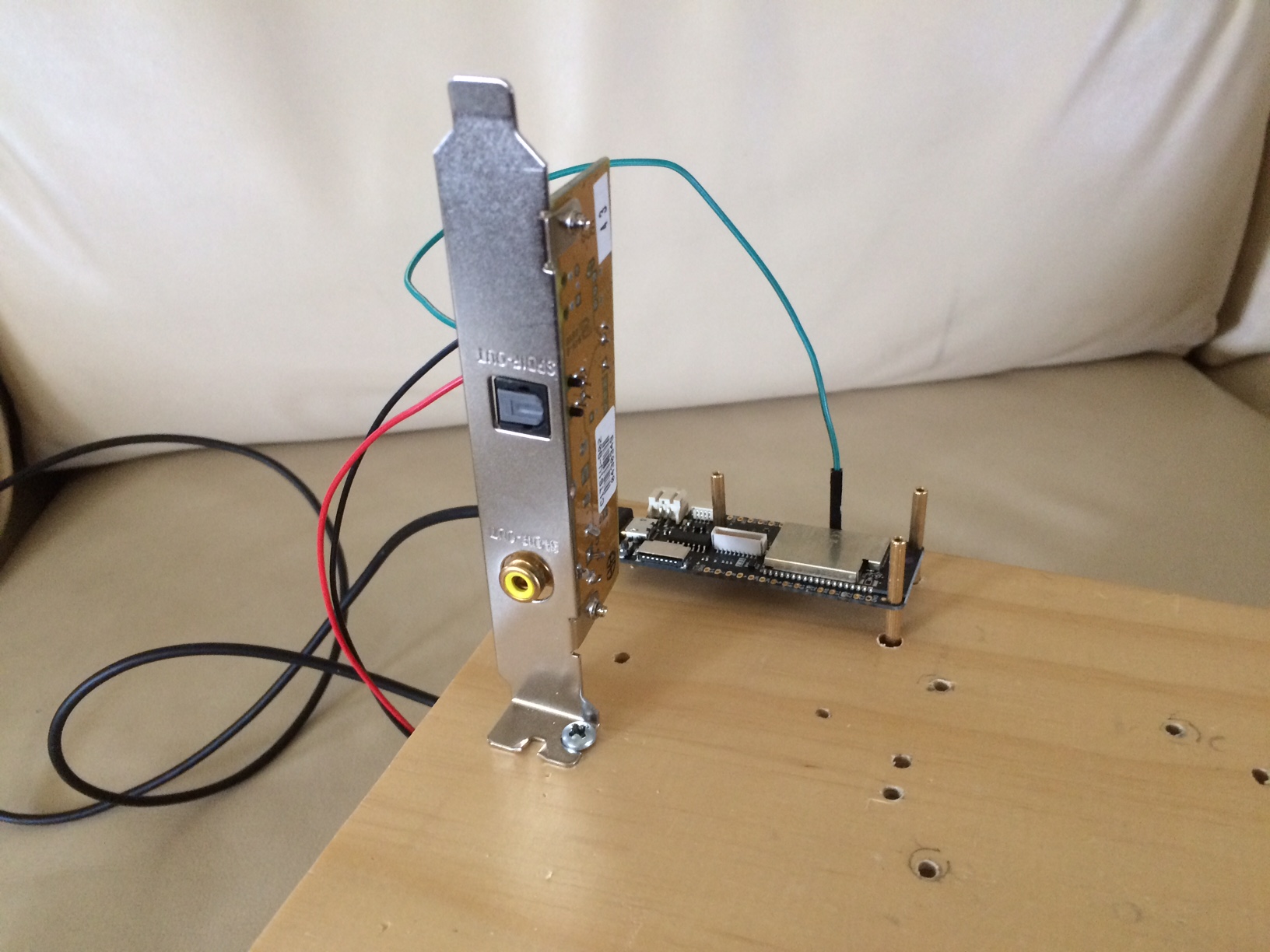

I must be really cheap! Here's my ESP32 board connected to a PC motherboard header bracket. Then stuffed into a small wooden box. Running Squeezelite-ESP32 and streaming wirelessly from my Windows 10 PC running LMS. Can connect via toslink or coax to my DAC and stream Tidal, Spotify, Qobuz, Pandora, ...
So, which ESP32 board is that? I did some searching and didn't find a board that looks like it.
Or is the board unimportant, because you're just "abusing" the I2S port to make S/PDIF come out of it?
see AudioOutputSPDIF on:

Never mind; I looked for WROVER and found "WEMOS LOLIN D32 Pro V2.0.0 WiFi Bluetooth Dev Board ESP32-WROVER NodeMCU" on ebay.
Squeezelite isn't lite enough to run on an ESP-01; it needs at least 4M of flash and 4M of PSRAM.
Sorry I missed your question, but that looks like the same board (I got mine on Amazon for $18.50). If you don't require optical, a simple capacitor/voltage divider circuit will get you coax out to your DAC.
