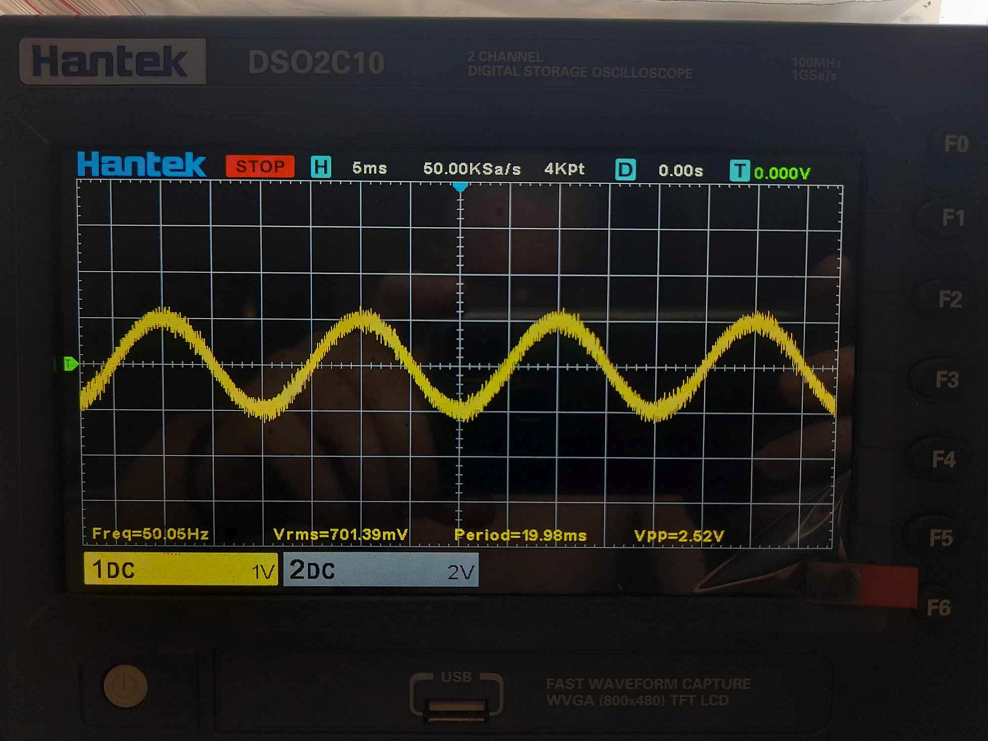

Amplitude do not look high, if scope is right 1,2v peak to peak, so its not power supply related ,probably oscillation. Can you check output of ic103, ic 303 , also their power supply? Also check if ground to their circuits is not broken.

Clean at 15v dead on, but if you ground the rca shield - there is the same noise like at the speaker terminals on the aux +-15vcc, at the rails...everywhere.
It does, but the sinewave is a distorted ....like the noise is riding on the wave...i'll take a picture...give me a sec.
If you ground the scope probe with the short grounding clip to the non-bridging speaker terminal for the channel you're testing, do you still have the same level of noise?
Same. It's the same even with main gnd....but if I ground the scope probe directly at the rca shield I do have a clean sinewave and my current draw goes back to normal 0.5A.
