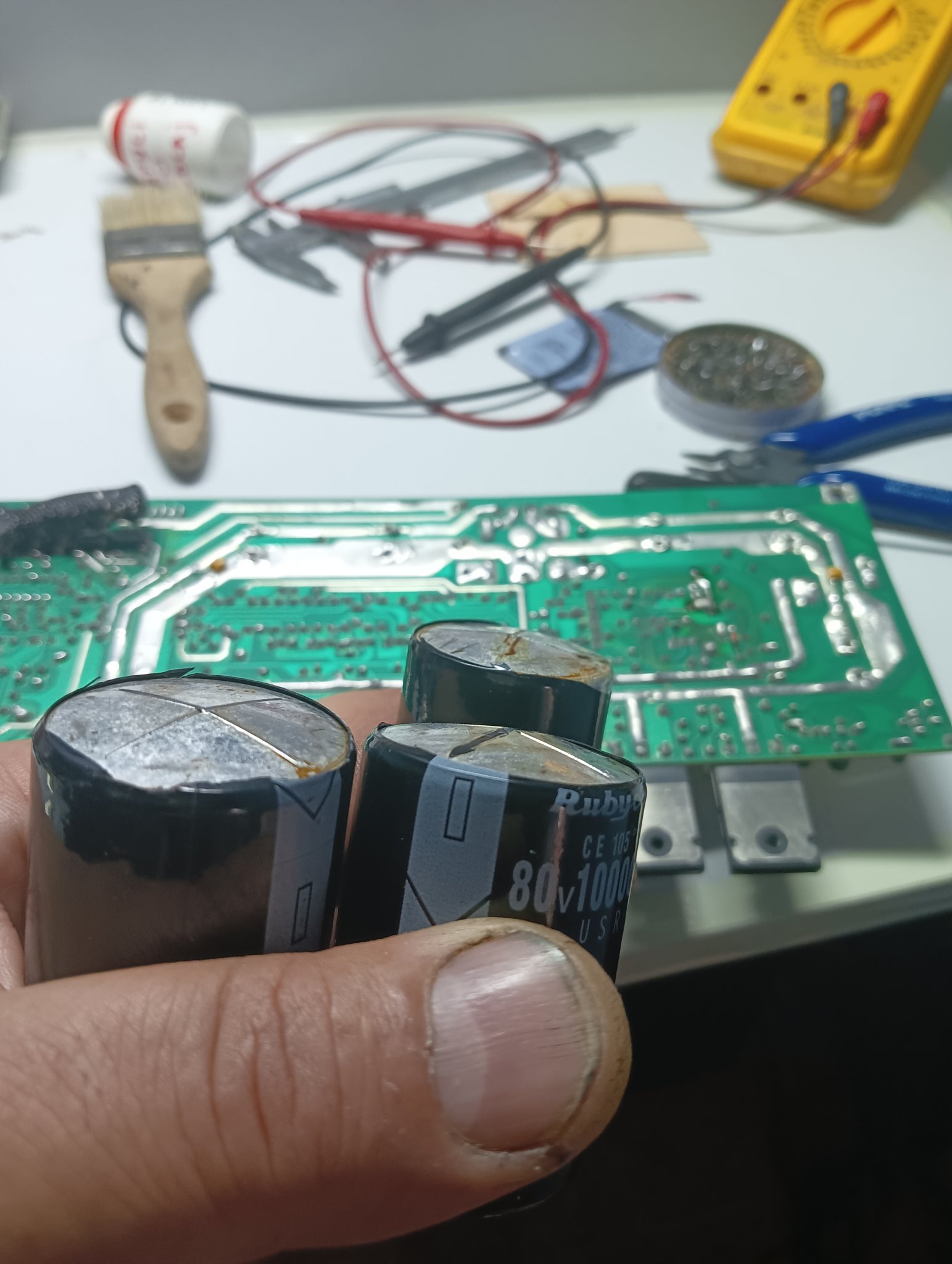

Hello everyone. In my opinion this amplifier is something common, nothing from another world as they speak here. The six 10,000uf capacitors are pirated, not original Rubycon. Mine are already swollen and I have to change them.

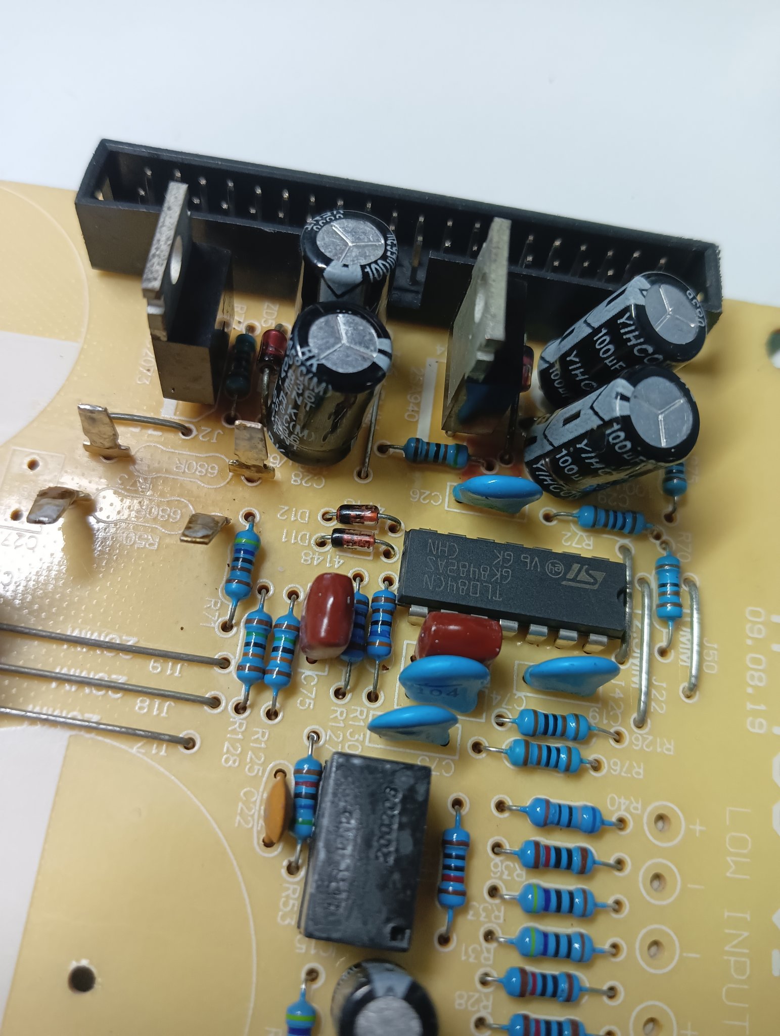

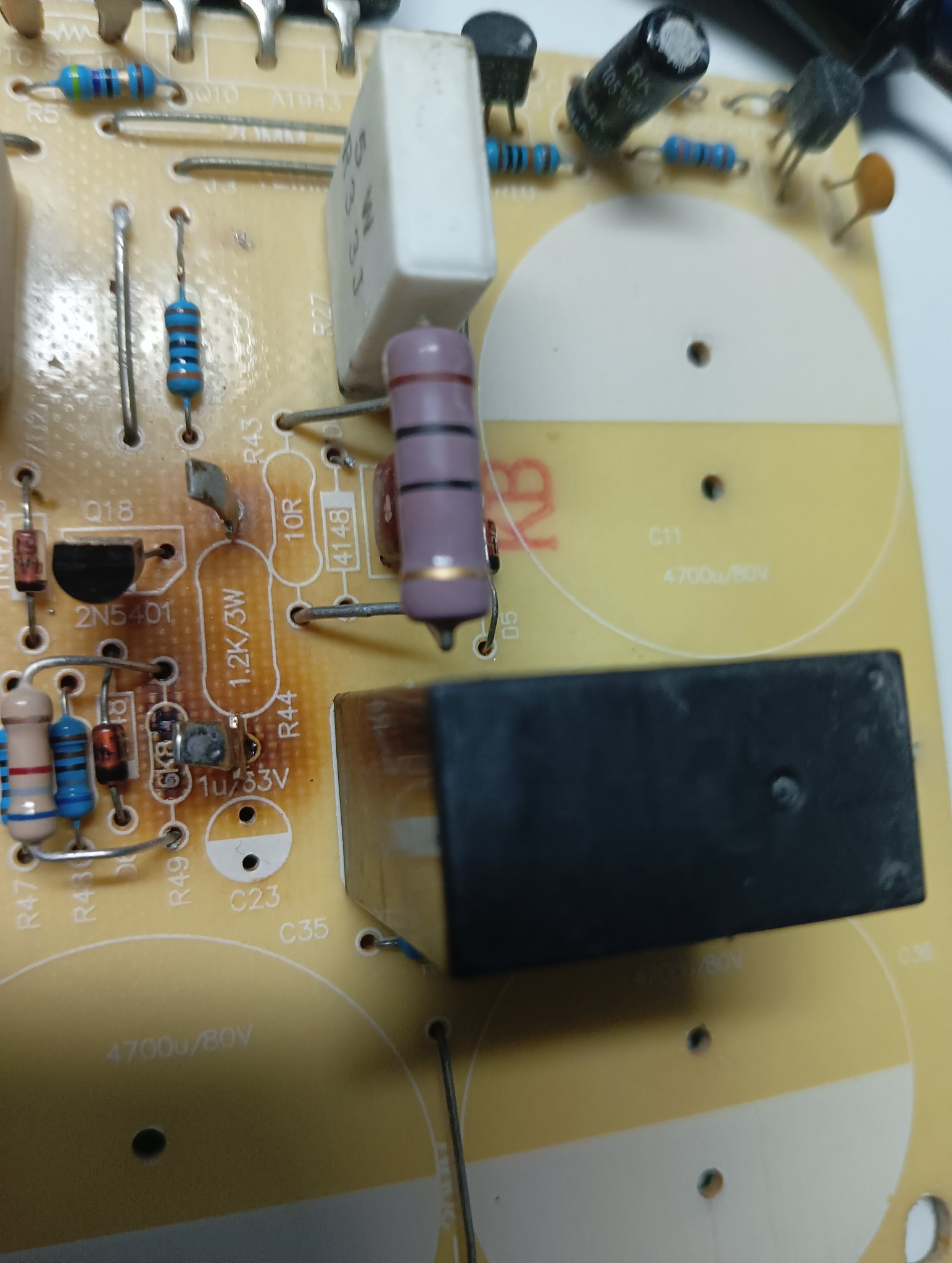

The printed circuit is of poor quality and some components are poorly calculated. For example, you have to change the two 680 ohm resistors, from the power supply part for the ICs, for ones of 1k and 2-3W. (R50 and R73). Also the 1k2 resistor R44 must be changed for one of 1k5-1k8 and 3W so that the relay voltage is around 12V. There are models that use 24V relays.

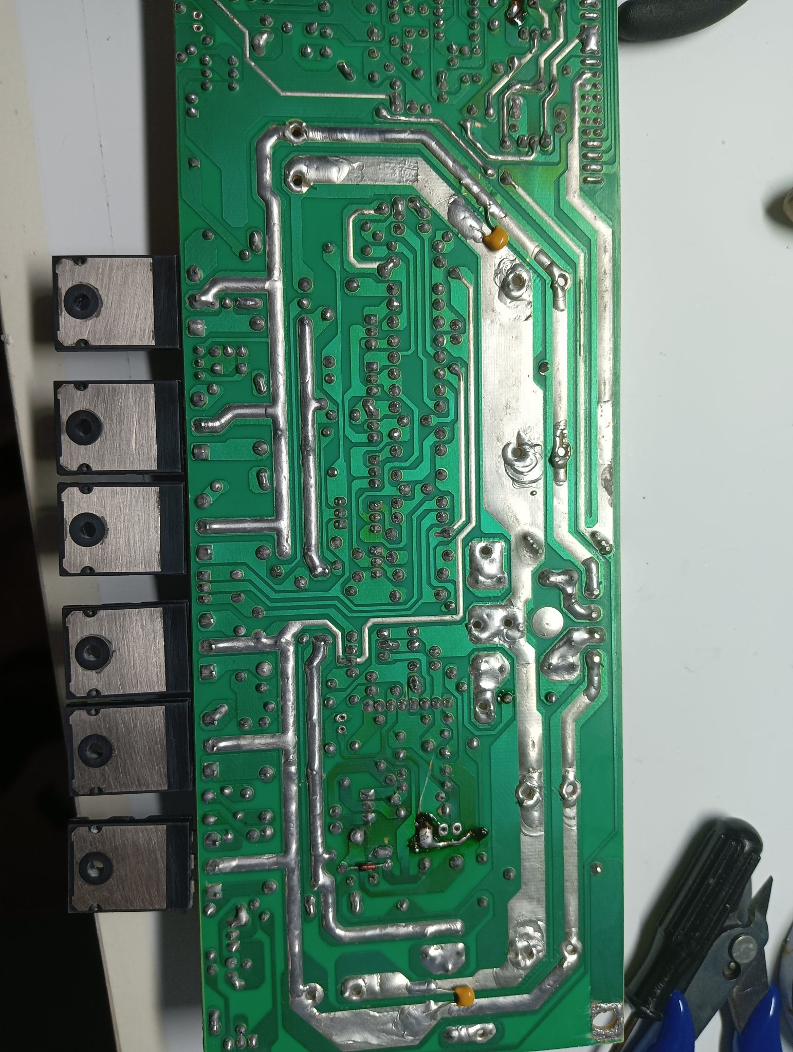

Transistors Q13,Q14, Q24, Q25 and bridge BD1 could use a small heatsink. You also have to redo all the welds because I found many cold welds.

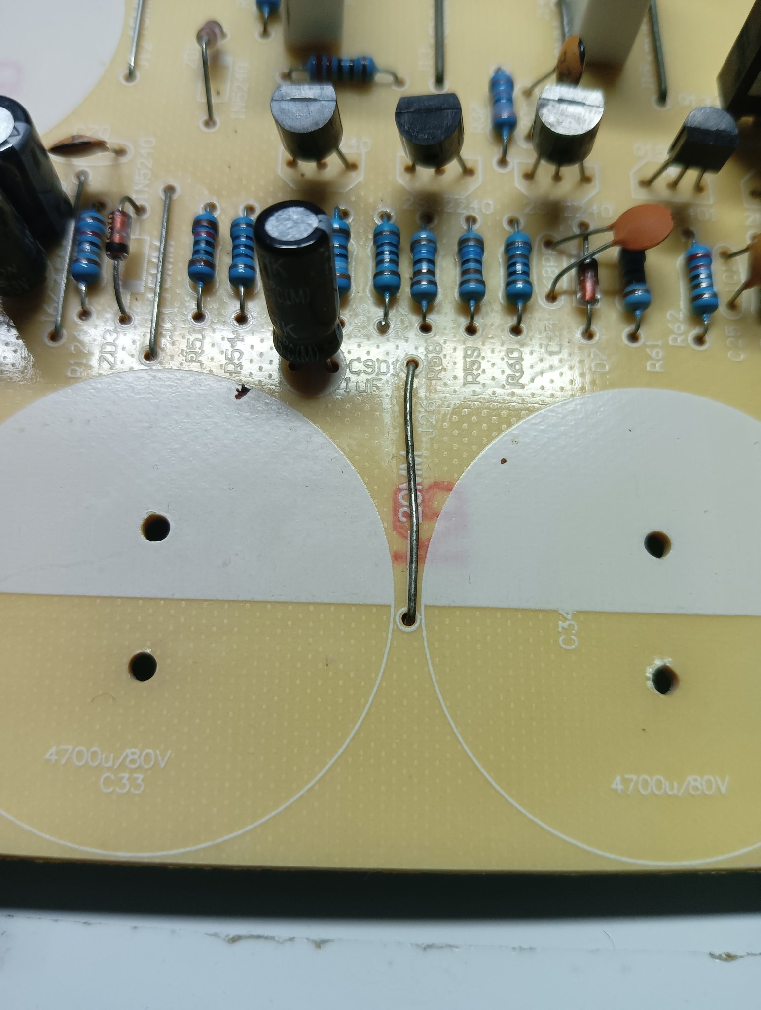

On the plate the filter capacitors say that they are 4700uf/80V. In this case, 6800uf/100V or 8200/100V can be mounted. I don't know if at 10,000uf/100V there are 35x50mm ones to fit into the casing.
Photos made after cleaning and re-soldering the printed circuit. Mount some terminals on the board to be able to test with various resistors without having to disassemble the printed circuit each time.

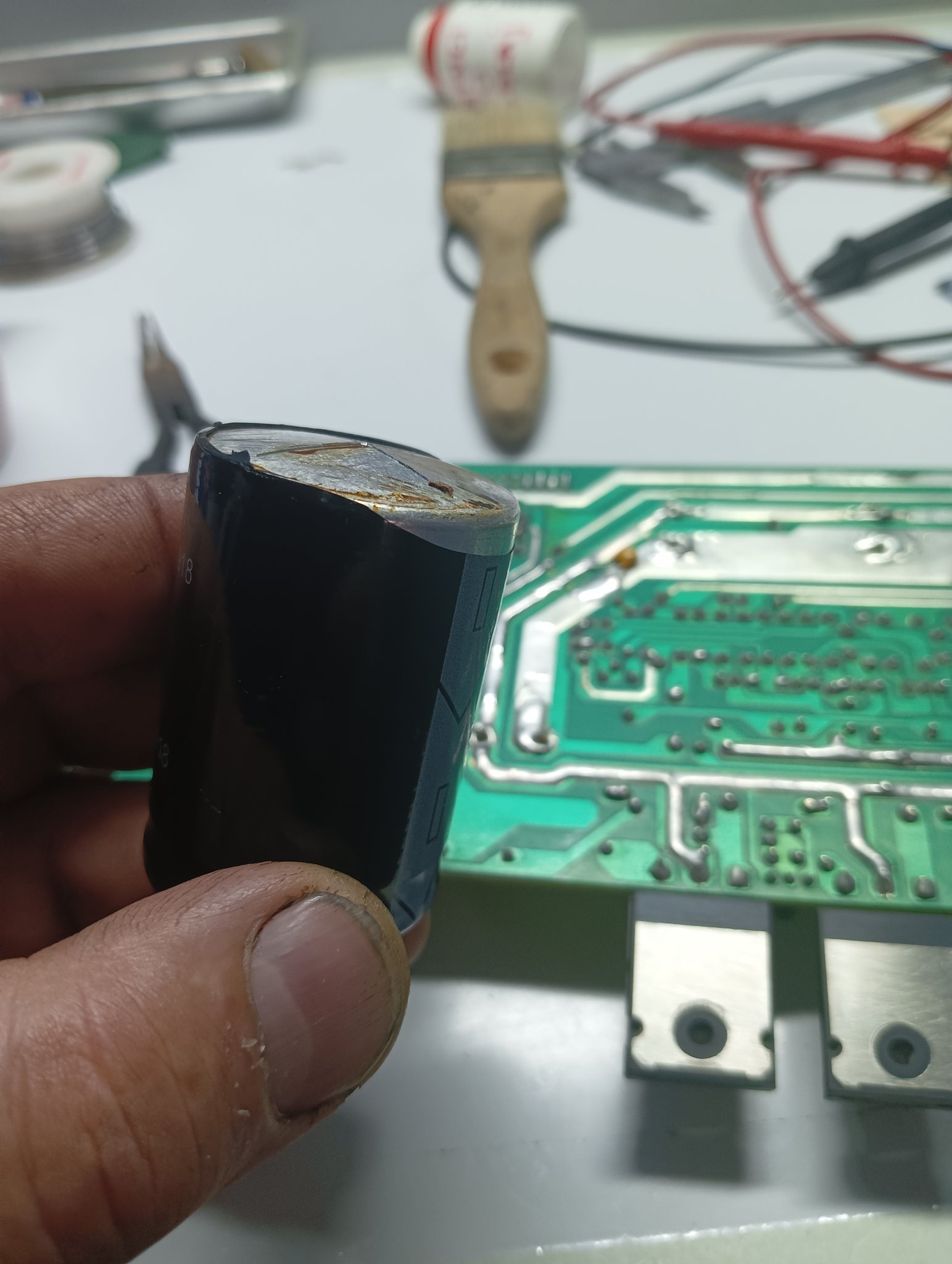

As I said capacitors are pirates. None measure more than 5200uf and surely they are not for 80V. You can see in the photos how they are swollen.
