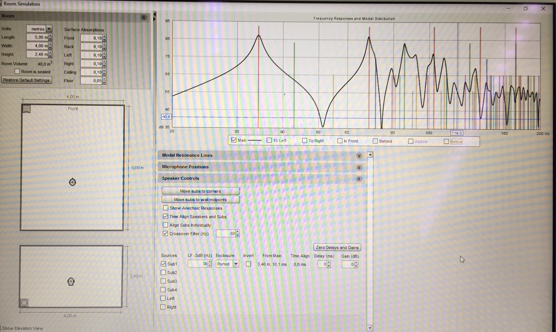

Are you missing the point? The sim is simply a mathematical cousin to the Reciprocity Theorem and can't be "tested" except empirically. These sims will always reciprocate perfectly. As the previous posts show, it is fair to raise questions about the assumptions. But the sim does not raise questions about its own assumptions!

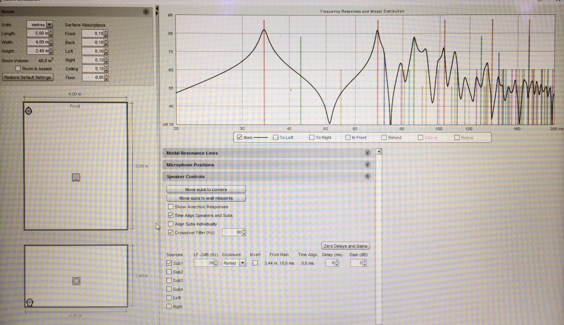

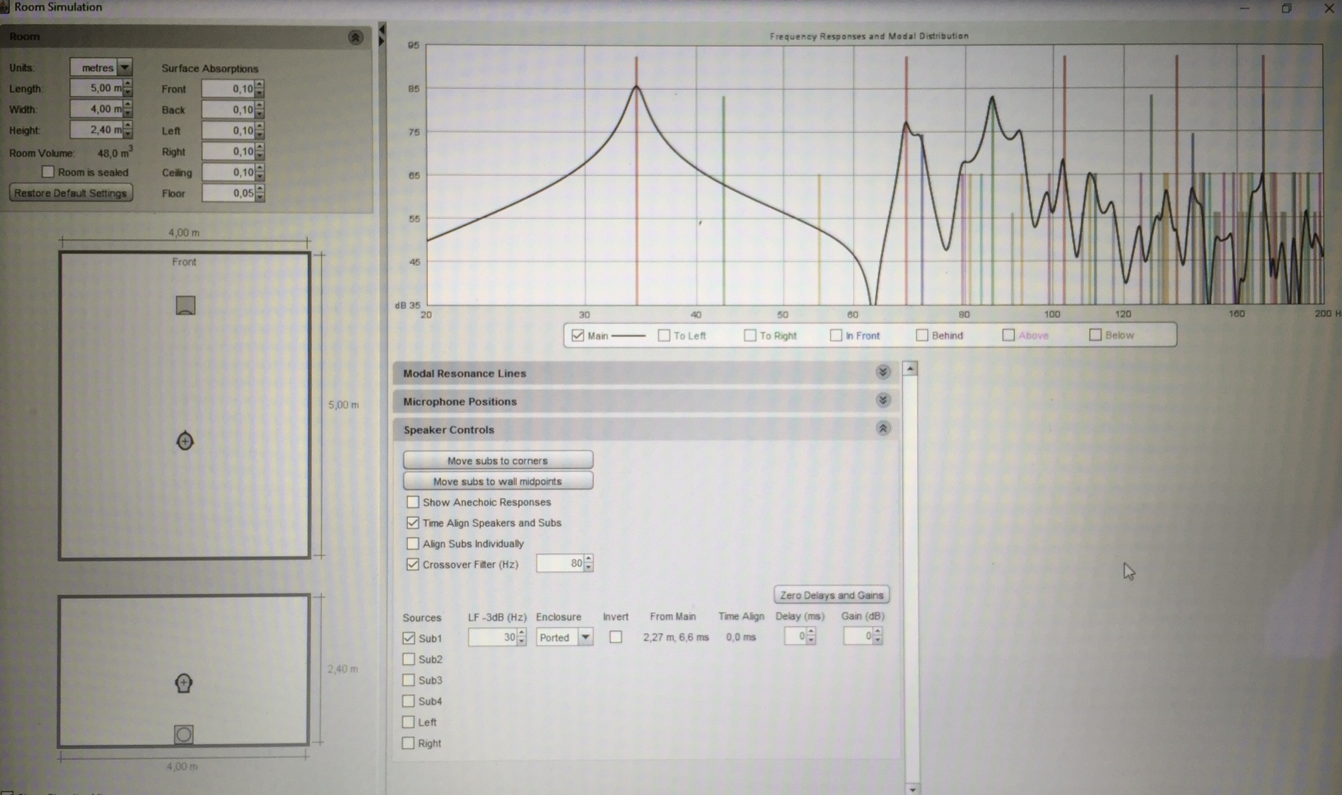

http://www.diyaudio.com/forums/subwoofers/280236-simulation-sub-corner-placement.html#post4465835
Post #16. Look closely at traces below 75 Hz. Quite different. Sure is better with the door slid open and all my winter motorcycle clothing soaking up some of a mode or two in the perfect location. This also illustrates why good methodology leads to stable results.

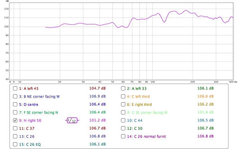

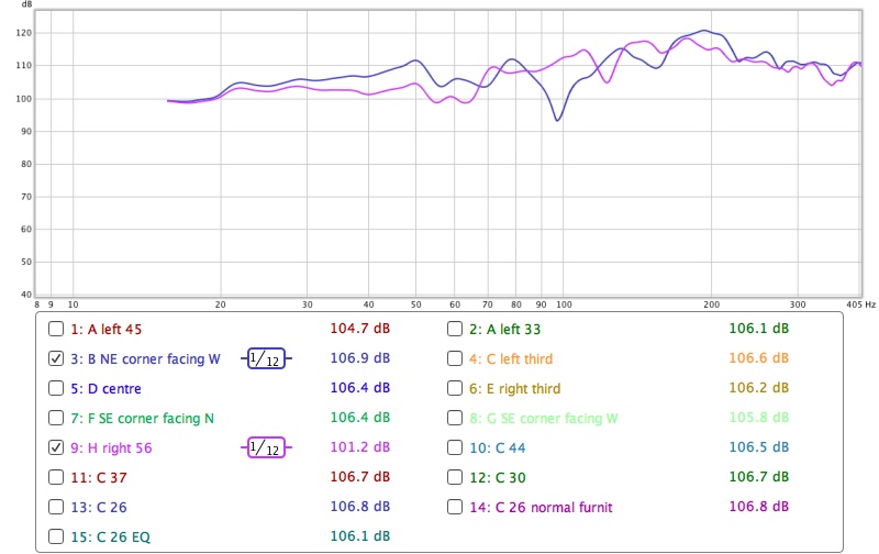

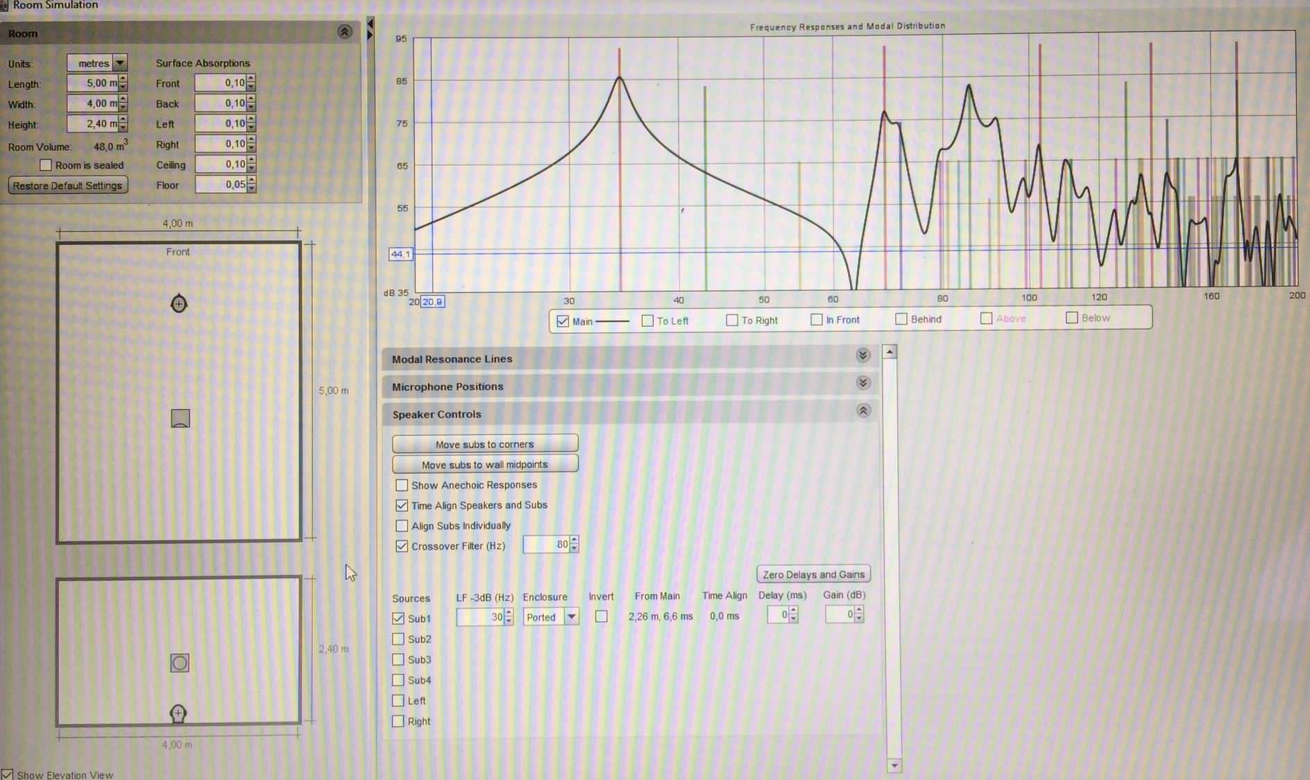

I had a little time to burn tonight, so I decided to try this reciprocity theory out. I don't have a lot of time to post a detailed write up at this time, but I will do my best. The equipment used was REW with a calibrated mic and a 10" powered bass reflex subwoofer. I tried 4 different locations around the room and the 5th or common location being one of my theater seats. When placing the mic or subwoofer in the locations around the room I made sure the mic was exactly where the cone of the subwoofer was and vise versa. If it helps, my room is 15' wide x 24' deep. The front of the room is 15' wide.
The first image is with the subwoofer or mic in the front left corner of the room and the mic or subwoofer on one of the theater seats.
The second image is centered on the front wall on the floor.
The third image is in the same spot but raised off of the floor 3'.
The fourth image is centered on the right side wall.
Hope this was helpful.
Matt

That's immensely helpful. Wonderful. Clearly Helmholtz spoke the truth in proposing reciprocity theorem (not that anybody doubted its theoretical truth).
My impressions (and responses to Matt's traces are inevitably different among people and purposes):
1. big differences among those four locations and clearly you'd want to test various locations before deciding where to locate your sub; if choosing a location was your primary goal, the reciprocity method is pretty good for a big-picture of your bass sound, as long as you work as carefully as Matt. Maybe not a perfect as the sims predict, but pretty good.
2. the first graph, in the corner, looks like the best prospect to me; but looking at one of the traces (not sure which test it represents) you might say, "umm, this needs some help at 37 Hz and 48 Hz" but you could be preferring another location (in error) if you were working with Matt's reciprocal test; of course in your home, you wouldn't know which is which unless you tested the old way after positioning your sub and then applied the EQ.
So, looking at Matt's data, the reciprocal method is helpful as a gross test but it might be wrong in the fine points and in another room very wrong. Some rooms might show better agreement than Matt's but some may show worse and lead you to a sub-optimum sub location.
If it were simple enough to move your sub, that sure is the way I would work rather than accept an unknown degree of uncertainty. If not, looks like the reciprocal approach can be very helpful.
The degree of smoothing Matt used seems about right to me. But it would be instructive to look at the same traces with one increment less smoothing, when Matt has the time.
