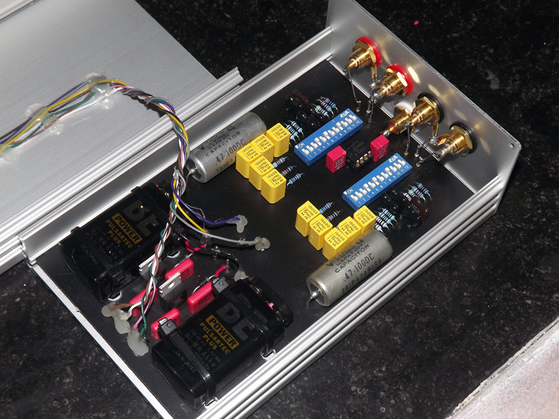

I’ve just finished a Boozhound step up and currently have it powered by 2x12V standard batteries with a simple switch. I plan to add another stack of 2x12V for increased playtime.
However, I’d like to be able to swap them out (or recharge them) before they get too depleted.
I’m looking for examples of power supplies (24V via 2x12Vx2 ideally to avoid chassis reconfiguration) that use rechargeable batteries, which switch to charging mode / mains power only when the battery is low. Maybe with LED indicator?
Should I just use regular lead acid batteries? Lithium ion?

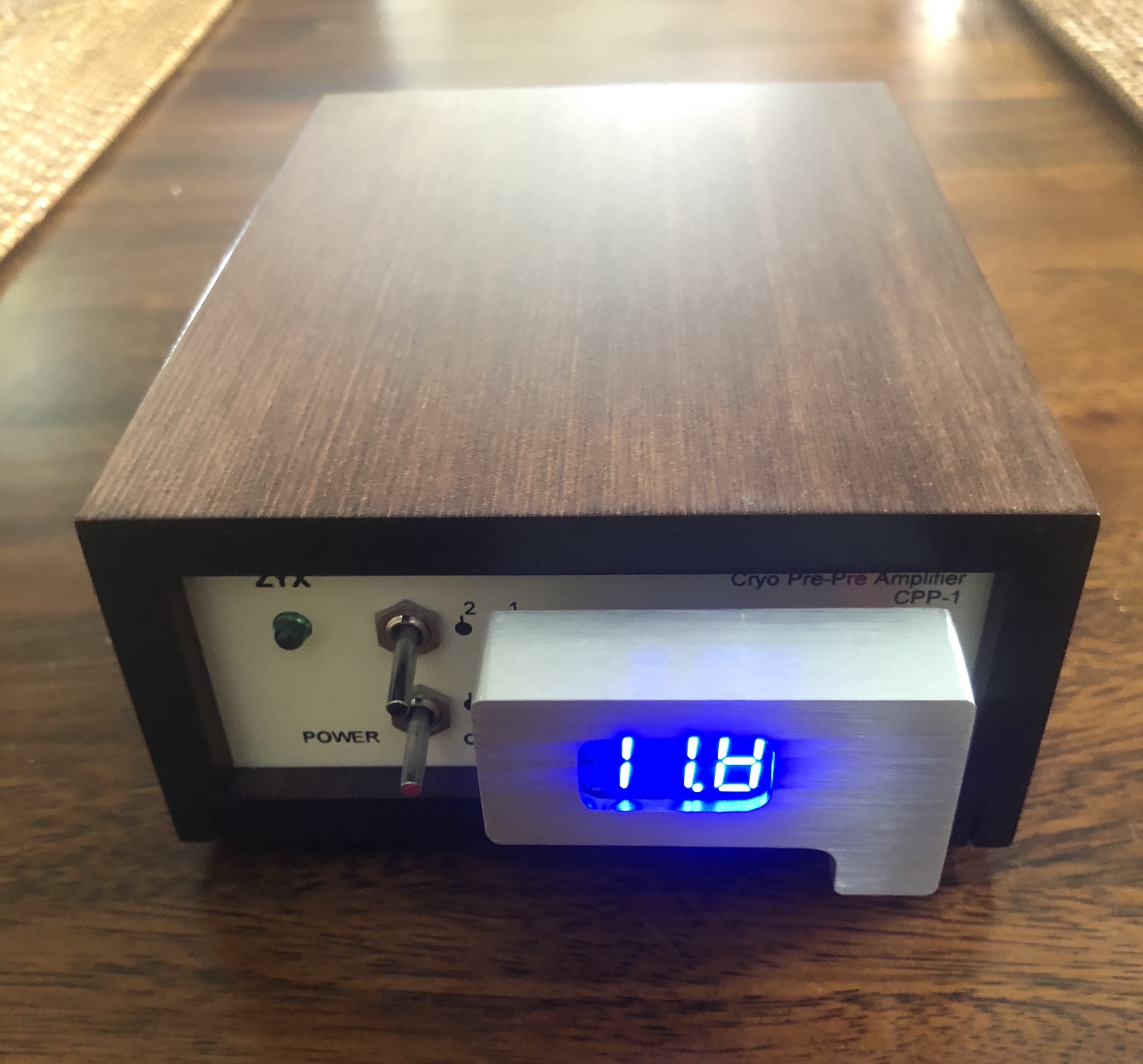

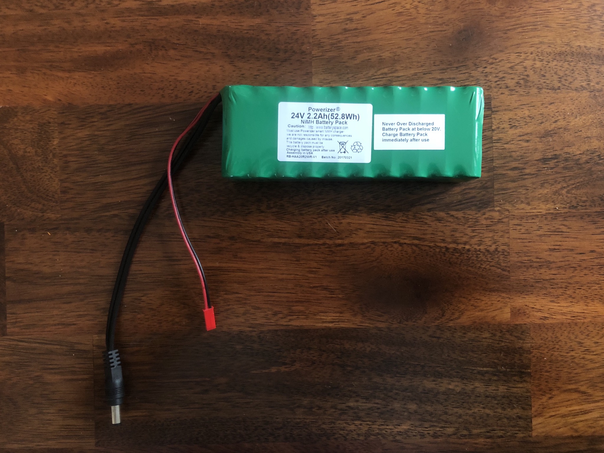

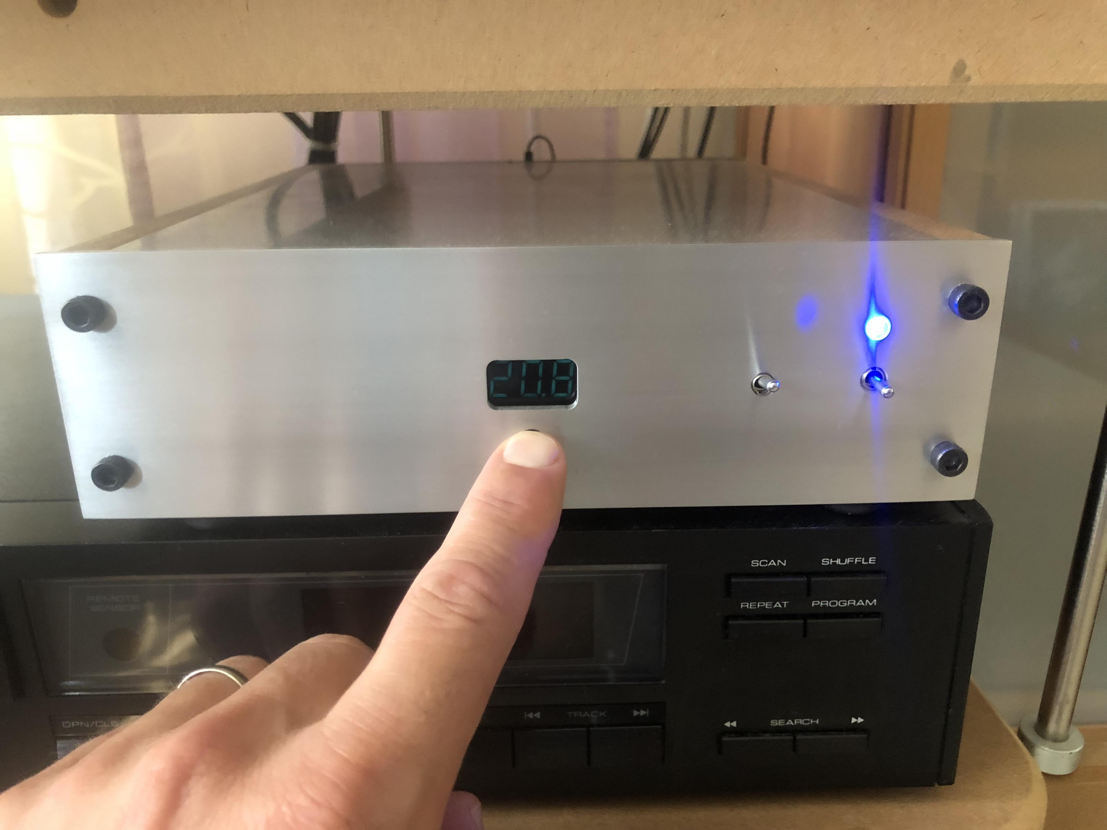

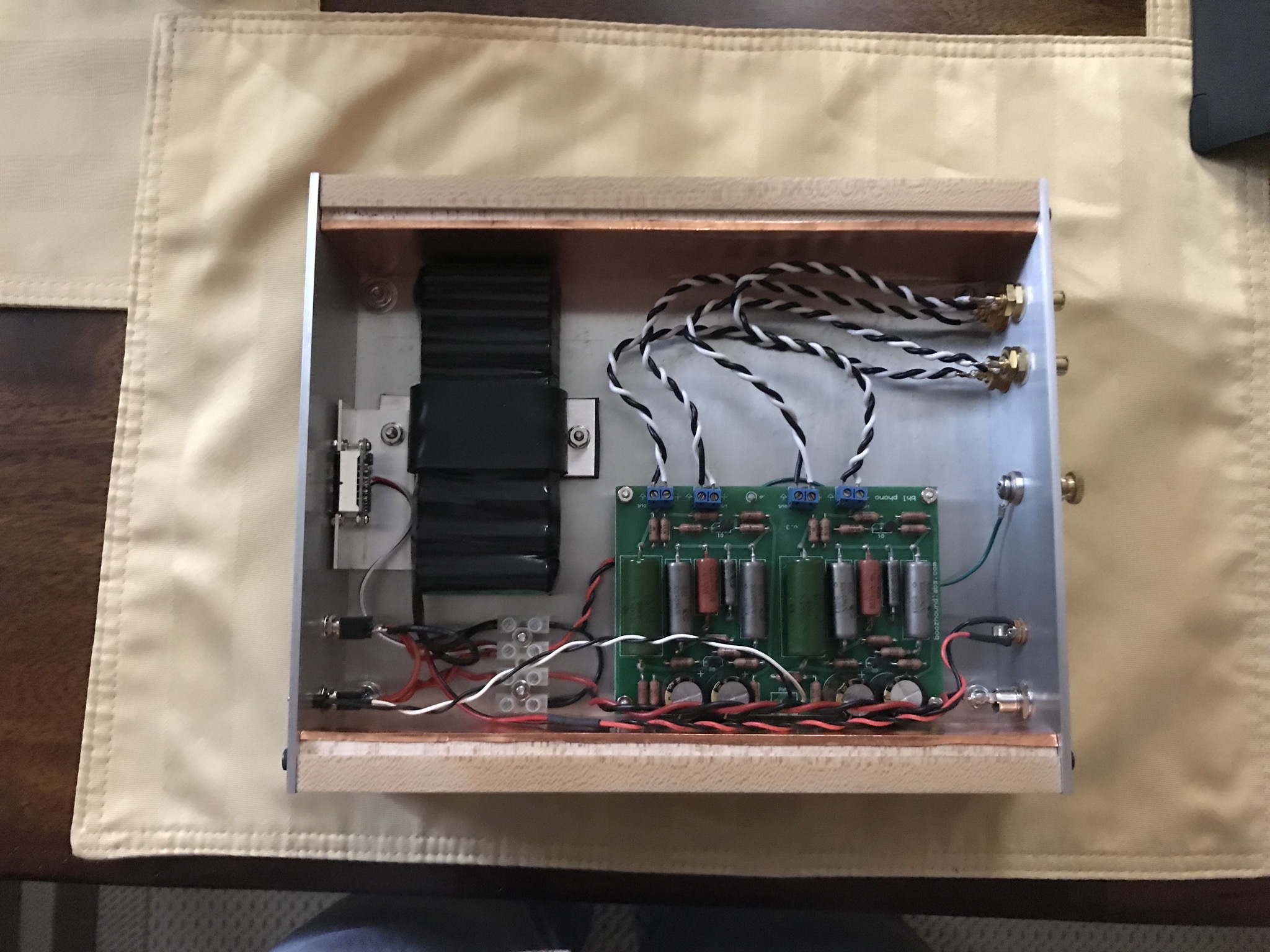

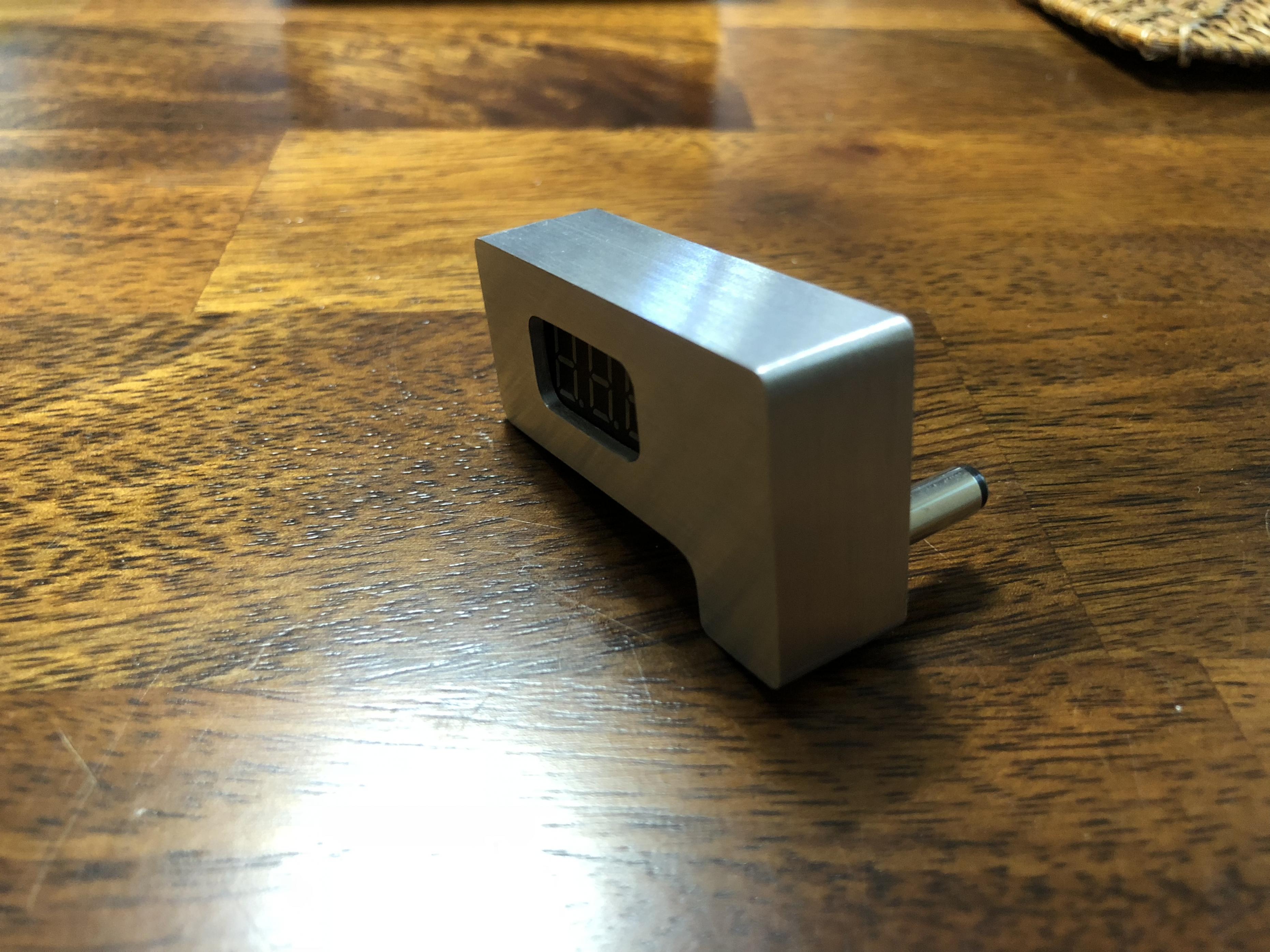

I’ve been through exactly what you are describing. I built the Boozehound standard MM phono stage several years back and went through many stages of trying to resolve a quiet power supply. I did not implement a system that automatically charges, but it is rechargeable and monitor-able. I also recently went through replacing the rechargeable supply in my ZYX CPP-1 in the same manner.
I had what I thought was a quiet laptop supply for a while but it crapped out. Ultimately I ended up with a couple 24V NiMH supplies from Batteryspace.com. I have no affiliation with them, they just had a good selection of battery supplies and chargers at reasonable prices.
I’ve attached a pic of a supply as they came to me as well as few pics of my solution.
Ultimately, I felt the 24V supply was over driving the circuit as the charger was bringing it up to about 26V on full charge and I was hearing distortion. I was plugging the supply into the 5.5X2.1 jack on the back of my case that I installed for the laptop supply. I wanted to integrate the supply as you mentioned and control charging as well as monitor the state of charge without having to use a multimeter and etc. I sort of used the ZYX as a model.
I opened up the 24V supply and removed two cells to bring it’s full charge capacity down to about 22V. The charger I bought still works with it as it can be used with anything from about 19-24V. Even the thermistor monitoring circuit still works properly. I simply had to bridge the last two cells on the altered pack with some wire and reinsulate the pack by completely rewrapping it with electrical tape. You can just buy a 22V pack to start with if you like.
I also used a multi switch system that has a center off 2 position switch to select between sending voltage directly to the battery for charge or using an external power supply to directly power the circuit. The battery charging supply is not appropriate to power the circuit. A secondary single pole switch controls whether the battery is connected to the circuit. A single LED indicates when power is reaching the circuit. I also integrated a momentary switch that activates a voltage meter I sourced off eBay so I can simply push a button to monitor the supplies voltage level. The voltage meters circuit was too noisy to be left running all the time.
I came up with a solution to use the voltage meters (since I got 3 for like $10) on the ZYX as well without modifying the unit. I machined a removable pod that plugs right into the power inlet on the ZYX. When the charge switch is activated it displays the battery supply voltage level. When it requires a charge I simply remove the pod and plug in the charger I bought for the 10.8V NiMH supply I installed in the ZYX (sourced from the same supplier).
I find these supplies are dead quiet and have over twice the capacity (in the case of the ZYX) of the original NiCD packs that were used.
Wow! Beautiful work!
I’ve been looking at Rod Elliott’s design here:
Automatic Charger for Battery Operated Hi-Fi Preamps
Ideally I’d prefer to have the charging seamless and not require removal. The likelihood I will be able to make such a neatly machined pluggable charging pack as you did is low.
But I will definitely take a closer look at you implementation, and get back to you with a more fleshed out response.
Thanks!
Thanks!
Thanks. Took me a while but I like to build things.

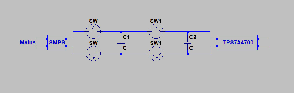

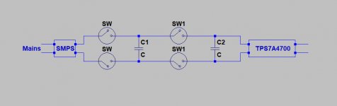

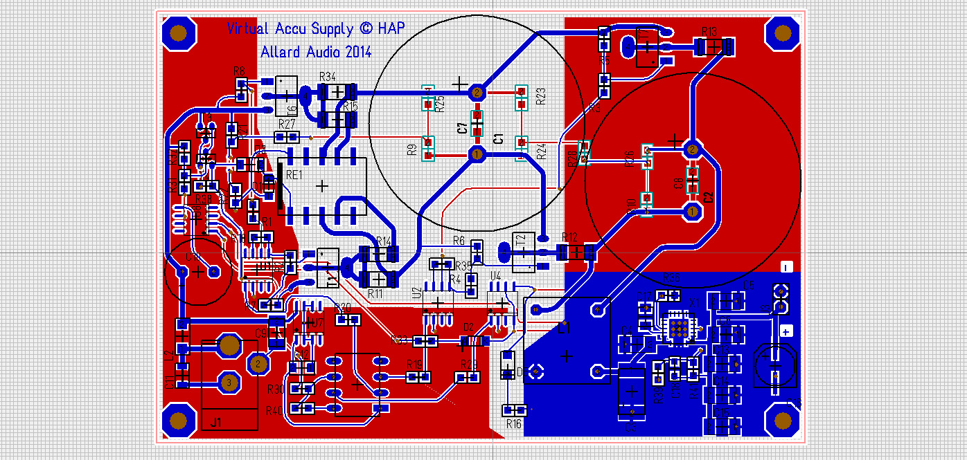

I also have very positive listening experiences when comparing a mains connected power supply versus a battery supply.
However a battery has a relatively high output impedance, so it could even be improved.
That's why I took a different road with very positive results.
I started with a SMPS wall supply delivering a DC voltage.
Two switches SW connect this supply to a large electrolytic cap C1 for 45msec, with 10 Hz switching frequency.
When the switches are open, a second set of switches SW1 transfer the load from the first cap to a second cap C2, interleaved and also during a period of 45 msec at 10 Hz.
At last an ultra low noise LDO Voltage regulator provides the wanted DC voltage.
In effect, there is never a connection between mains and the output voltage.
The caps acting as batteries provide the power for the equipment to be supplied.
The switches in my case are mosfets.
I have several versions working permanently for almost 4 years, equaling ca. 1Giga switches per supply so far, without a flaw.
I have called it a VAS, for Virtual Accu Supply. Maybe it's a bit complex, but it's a hobby after all.
Hans

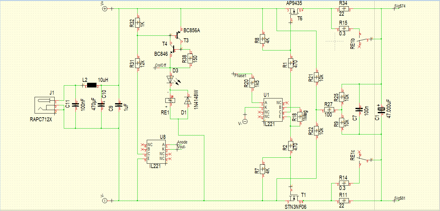

Could you possibly explain in more detail this implementation, for the less capable among us (myself included).
It sounds very interesting.

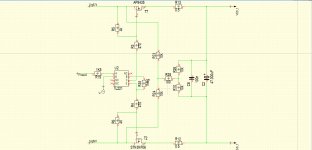

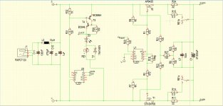

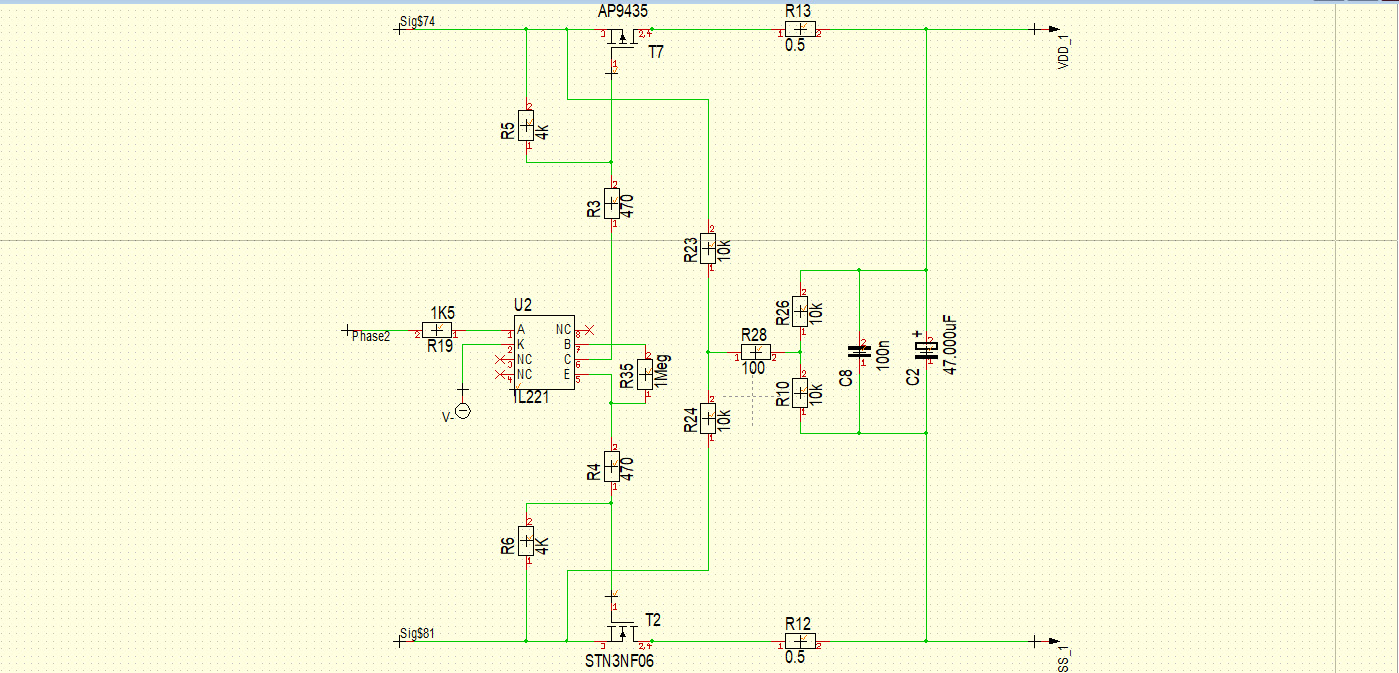

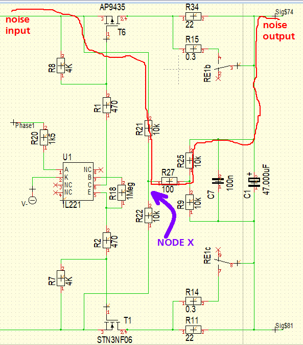

Here it is in detail. Switching is performed by means of the Mosfets T1/T6 and T2/T7, steered by opto isolators with 10 Hz interleaved 45 msec signals Phase1 and Phase2.
The Caps to be charged are C1 and C2.
R11/R34 are used at start up to prevent large inrush currents. When the voltage on C2 has passed a border, U8 caused a relay to place R14/R15 in parallel.
To give you a better idea, the PCB is also shown.
Values of several components depend on the input and output voltages and the amount of current that has to be supplied.
Hans

I use solarpanels for charging.
See.MM phono preamp with accu and solarcells
You can change schematic for 2x12v.
Thank you very much for posting your schematics, Hans! May I inquire
why not install a large bypass capacitor between Node X and quiet-ground?
there seems to be a pathway (red) allowing input noise to make its way to the output, no matter which way the switches are connected; is it silly to worry about this pathway?
Hi Mark,Thank you very much for posting your schematics, Hans! May I inquire
Resistors R9,21,22,25,27 force Sig$74 to stay Below V+ and Sig&81 above V-.
Any noise coming in at Node X from the input, will appear in Common Mode on Sig$74 and Sig&81.
And you are right, a bypass cap between node X and some quit ground could be beneficial, good point.
Hans
