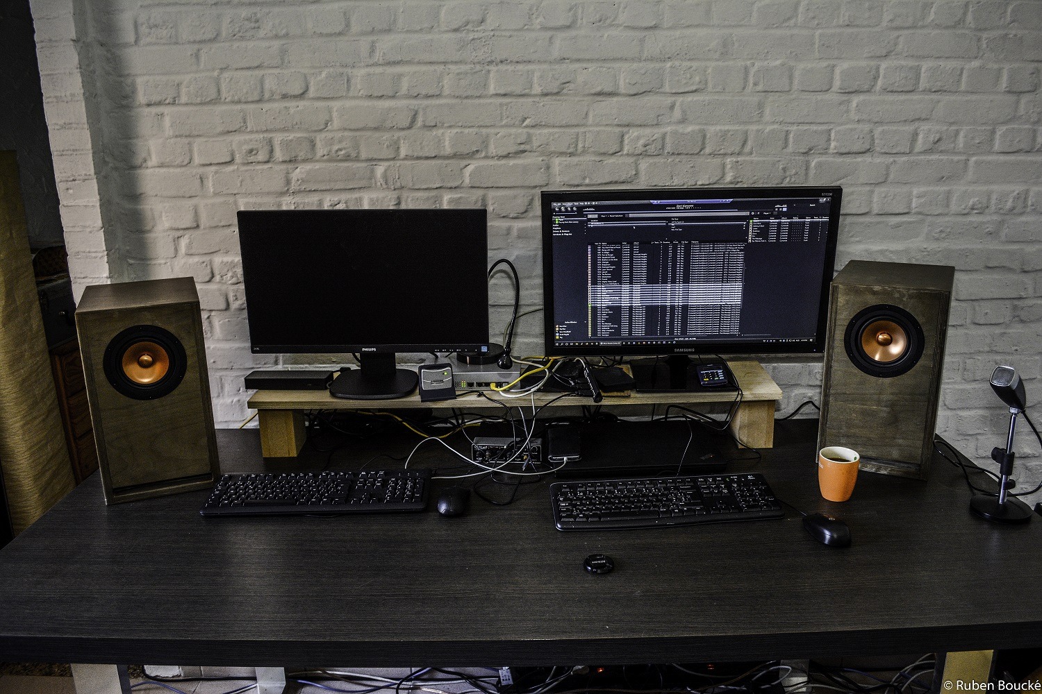

Mark Audio drivers are indeed what i also would recommend. I use an own design bookshelf in a similar room. I now use it with a transistor ab class amp, but i did run it with various amps in the past (also high output inpendance) and those drivers work with both. 2W is little altough so only fit for close listening. But if you want high volume from 2w, you will need huge horns anyway, no small cabinet will do that, with any driver.

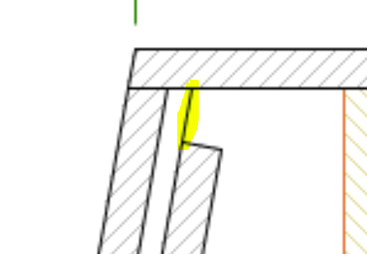

One question on the dwgs, can you please clarify what the highlighted line represents? It is shown in both dwgs of this design family and I cannot figure it out.

The little bit you hi-lighted is the vent spacer reaching all the way to the back of the box.

I build it with the Alpair 10.3, simulations say that the Alpair 10P would also work. The other Mark Audio drivers not.
The notch filter is to tame the driver resonance in the treble. I like it more like that, altough it's not mandatory to sound good. It's an classic passive notch filter, nothing special except that it's tuned to the driver's response that i measured in a sealed cabinet i build before (and had measurements of). The difference of cabinet does not matter, as that won't influence that notch filter.

Excellent, makes sense now on the spacer. Is the spacing itself a tuning element (recommend to tune) and or should this in the end be fully glued and seal in place during the build?
As for the extra pair.....are you will to part with them? And if not, what other driver options should be tried now that the end is near for the A7P?
I keep the width of the vents the same. That gives a maximum vent exit of the height of the loudspeaker. That is too high for almost all drivers so its exit are needs to be decreased. The vent spacers fill the unwanted space (FF125wk & A6p in millSize box are perfect without a spacer).
But what drew me to the Onken vent structure was the naturally braced multiple iBeam wall which is very stiff. on its own. So the vent spacers can be considered braces as well.
If you find a miniOnken to have to have bass adjusted it can be damped down by introducing open cel foam as additional aperiodic damping into the vents. This is useful sometimes when adding woofer support, and we found it necessary in our first miniOnken for the FR125 when used with an SE amp with high Rout.

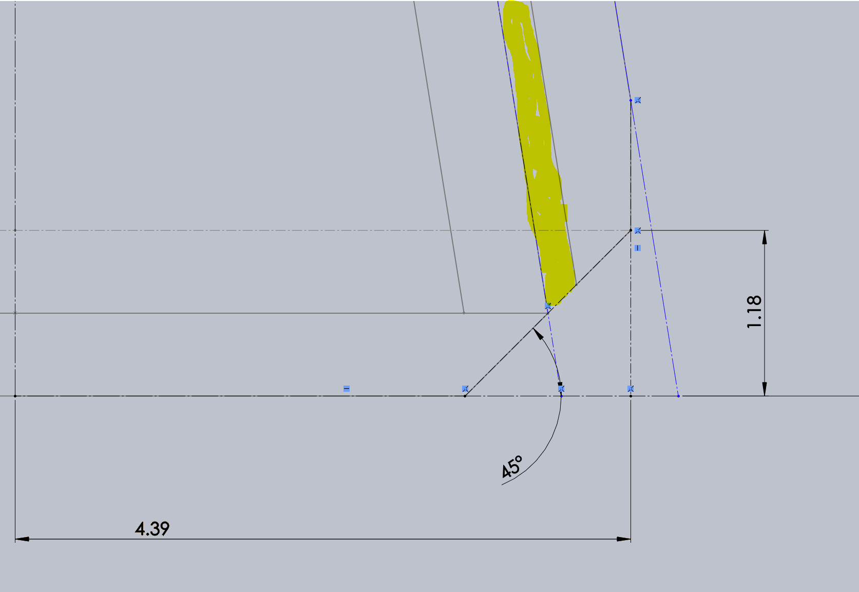

BTW - I just did a 2D layout....are the vents intended to be ~6mm opening (vent spacer thickness)? This is sort of eyeballed since the length of the flat sides do not seem to be as big as your layout. If I try to match your layout to have "bigger" flat sections, the vents obviously get narrower. The yellow highlighted are is the opening thickness now shown just under 6mm.
And then what should the vent opening heights be, looking from the front? The top and bottom vents look to be about 1/2 the 2 middle vent heights?
I don’t think i have used 6mm on any vents. 7mm on the µSize, 9mm on larger size bookselves (like the one for A7p), 12, 15mm in the moster miniOnkens and some of the CGRs and milliSize.
Those drawings are readily available with full dimensioning (i’ll toss in the planset with the drivers i have left ($25 bonus).
Your other dimensions suggest that you have scaled the box down not quite to half.
