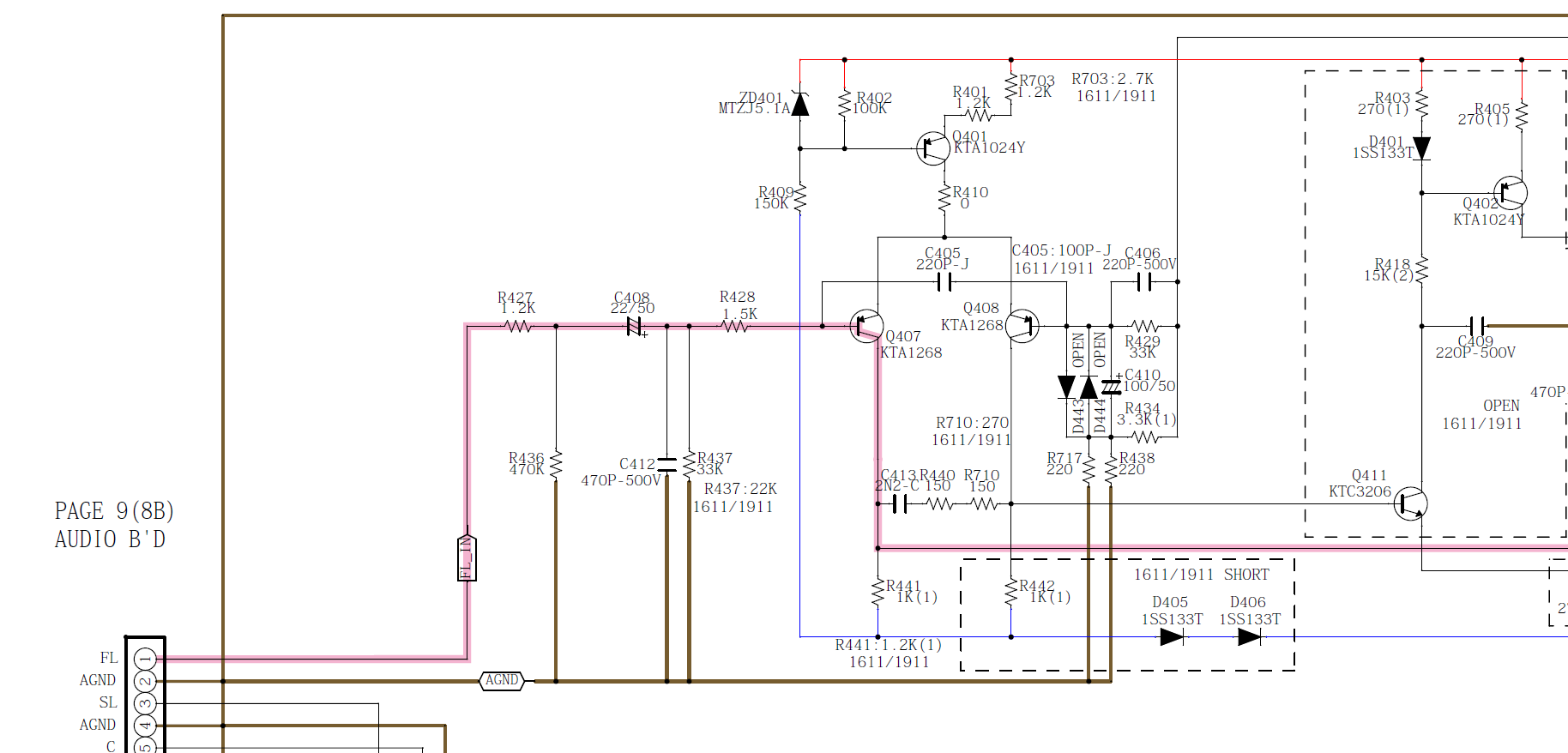

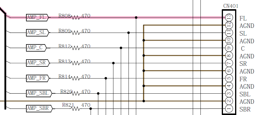

Just to inform, I found the service manual of this receiver.
Will be easy to put the pre-amp output in the rear panel.
May I just take the wire from this connector and connect into my external power amplifier?
I would like to continue with the original amplifier for some channels, like surround for now.
And the possibility of quick change between external and internal amplifier if I need to fix or change something in the external power amp.

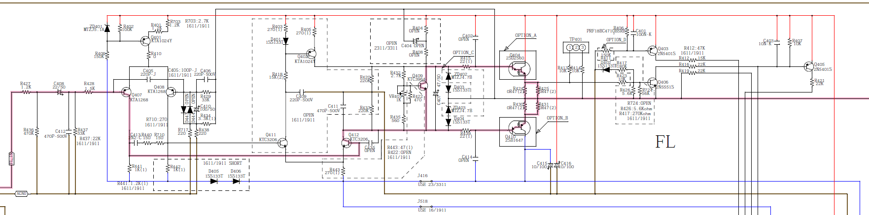

Attached you can check the circuit of one channel of this Denon AVR 591.
That doesn't look like a bad amplifier design to me and should be capable of good results; there may be some improvements that can be made by yourself depending on the goal.
I modified my amplifier to increase the feedback factor which made for punchier bass and cleaner sound overall. But it was borderline whether the sound quality coming into the power amplifier was good enough, the DAC and signal chain before the power amplifier was a limiting factor. I also thought about making pre-amp outputs for an external amplifier but I realized that a better quality amplifier could not be justified in my case without a better DAC and signal chain feeding it. You may face the same bottleneck.
One thing to note, your receiver may have protection / mute relays on the amplifier outputs that allows the sound to be muted when the receiver is first turned on and when it is turned off to prevent weird or nasty noises reaching the speakers during power-on and power-off.
You might be able to gain some improvement a different way - by building a strong well designed external power supply and using it to feed the power amplifier inside your existing receiver. Such an external supply could be used for other projects in the future, or for any future HT receivers you own. This is something I am still considering for my own HT receiver. I would begin by looking for a large power transformer and a nice chassis to put it in; I might add a soft-start module which I'd buy from eBay for $20 or so.

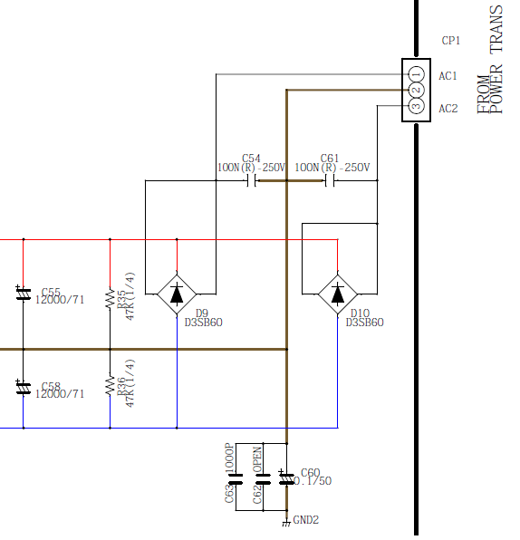

Attached you can see the schematic of power supply.
But in my case is just 6800uF/75V, not 12000uF like in the schematic.
I think that 12000uF is for the 7 channels amplifier, because the service manual is the same.

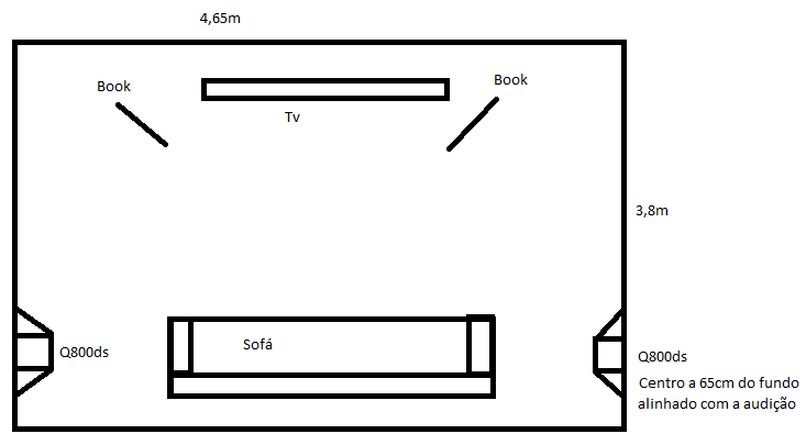

Other problem that I´m facing is the fact that I bought KEF Q800DS for surround (bad idea after read about it for my room).
In my speakers disposition in the room, the surround, sound like dead sound.
For now I can't change the speakers until I sell this one, so I put more gain in this channels... but a lot more, like +7~8dB over the audissey preset, and this means more power from the receiver...
I will try to fix this with another speakers placement in the room but I have no idea right now.
I will share the drawing of my room with KEF guys and see if someone can help me.
Attached you can see a ugly drawing that I did in paintbrush with disposition of the speakers.
Anyone has some idea about it?
Thanks!

I agree with you but it not necessary need a big heatsink.
For instance, I´m not using full power at all time, just want more power for dinamyc sound.
You think the engineers that design these units don't know that? Heat sinks are notoriously small in consumer products. Engineers know that they can get away with it for the same reason you give.
I would at least monitor heat sink temp (remember die temp is much higher) if you go this route. You might get away with it, but you're really pushing it.
My observation is that AV receivers can't even deliver full rated power (not even close!) with all channels driven. The better ones can deliver full power with two channels driven.
Reread my post about the power supply collapsing and how it keeps the output devices within safe temps and SOA limits. This is by design! It may be cheesy, but it works.
