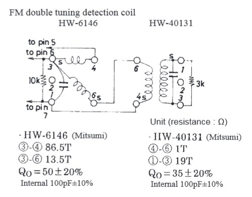

I have problems with L102 shattered his ferrite so that it can not adjust. His mark is NF LF 4061 / 75C, I do not know which is the European label?
Best Regards!
That is the likely cause of your problem.
Can you find a similar ferrite slug from an old receiver?
The types shown in the service manual are:
L101 = NFIF-4060
L102 = NFIF-4061
I don't know who the manufacturer is.
From the LA1266 (Q103) datasheet, the L101/102 coil specification would be similar to:
