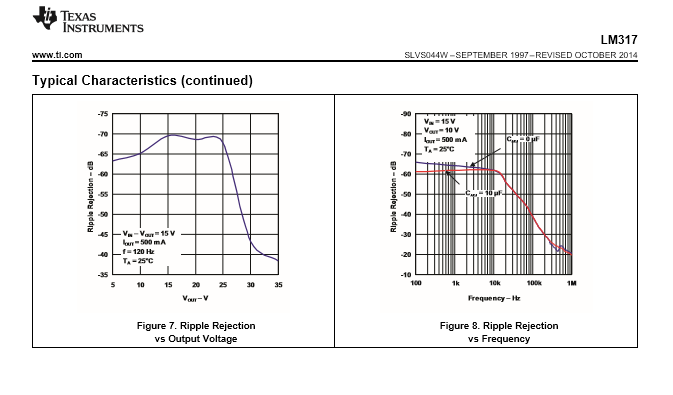

I'd def. recommend a DC output type of wall wart for lowest noise and use a LM317 mounted inside the foot pedal.
i'd use one like this "(PS) 102269 from Nebraska Surplus sales" 22VDC 140mA and design the LM317 for 18V out
needs about 3-5 VDC across input to output for best sound.
just make a foot pedal box like in your link and install a DC power jack on the side (put a reverse diode across the pins to protect), then u can use an 'outboard' wall wart type of supply or any kind of batteries you want.

you don't need that program for a standard full wave rectifier into a biggish cap.
rule of thumb is 2200 uF per Ampere gives 1V RMS 120Hz ripple.
Voltage regulator knocks that right down ~ 60 dB and any good op-amp has PSRR another 50-60 dB.
small EI transformer will sag the average voltage ~ 7-10% at rated current. but I don't recommend operation past 1/2 rated anyways depending on poor cooling of potted devices
so design for 0.2A use 470 uF at the bridge, now the output of regulator is -60dB down or 1/1000 ~ or 1mV RMS at full load. The opamp knocks that down another 1/1000 or 1uV or 2.8uV p-p. design under loading ( V regulation) make sure the lowest level seen at the bulk capacitor is ~5V above the LM317 Vout. note use >10uF cap at the adjust pin and another at the output for better noise performance and dynamic stabilty.
V regulator heat sink needs to dissipate ~ 1.1 watts = 0.2A * (Vin-Vout)* (RF) where RF = regulation factor at light loads

see circuit 9.3.2 here http://www.ti.com/lit/ds/symlink/lm317.pdf
that regulator design, and one of two the XFMRs in my other link above giving 22.5V DC will work very nice for 18V
