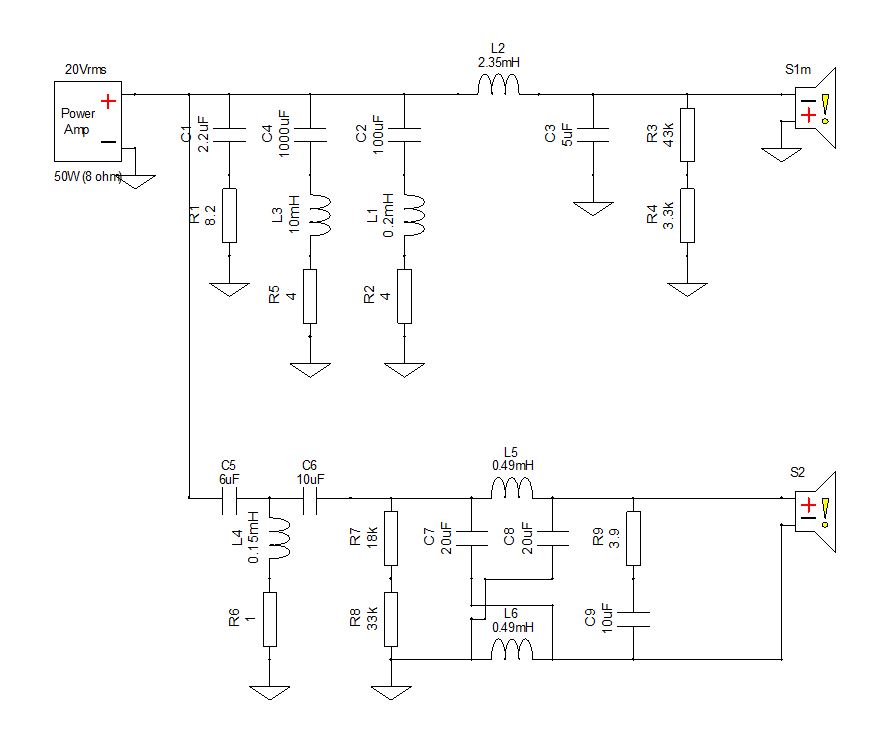

I looked at the schematic you attached. Maybe someone else will chime in here, but those big caps aren't even needed if you are running a solid state amp.
It seems they are all part of an impedance moderating circuit, and should be safely removed completely. This is why they overheated as well. Reducing impedance means they were subject to a lot of current.
Of course, you should still check your amp outputs for evidence of DC, but I would be very much tempted to run without them. If you want to see what happens without them, I'd suggest getting DATS or Room EQ Wizard (free but need a jig) and measuring the impedance of each driver, and simulating it all in XSim. You'll better be able to tell what's going on when you look at the transfer function and the impedance charts.

Hey K!
Well, it seems to be "optimized" so they can play very well with tube amps. To do this they attempt to flatten the impedance curve. There are three sets of components that run in parallel to, and before the filters. A Zobel (CR) and two resonant circuits (CLR).
The tweeter circuit also has a time-alignment component. That's the pair of 0.49uH inductors crossed with 20uF caps. Lastly, there's a protection circuit, which has the diodes, relay and transistors (I would probably remove this entirely).
Also, the drawing order is quite odd. Inputs on the right, but then flow left before coming back right.
The filters themselves are extremely simple.

So did a little plugging around. I used the default 8 ohm perfect drivers to stand in, and I examined the power dissipation of the 3 impedance lowering circuits. Sorry I did not keep the same part designations, but you'll see them in the top left of the attached schematic.
attachment.php

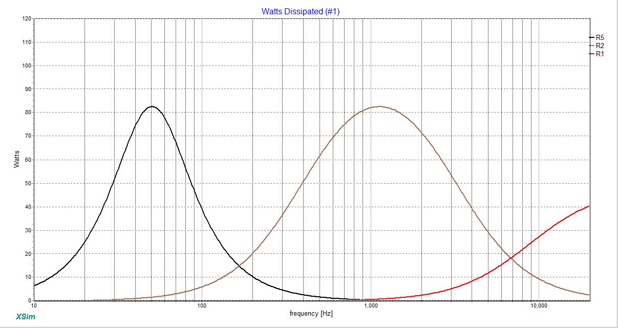

I then set the amplifier to 50 watts output. Obviously, continuously this is actually a lot, but it's helpful to see what's going on. Look at the power dissipation of R1, R5 and R2.
attachment.php
This seems almost careless. Due to the resonant nature of the circuits they are attached to, R5 and R2 (on my schema) will have almost 30% more power through them than input! The original 11 watt rating was WAY too low. What I suspect happened is that the heat from the resistors fried the caps. So you are left with a dilemma. You should probably use about 2x that (minimum) but.... the problem is they will still dissipate that heat! Meaning, you have to find some way to keep the resistor heat away from the caps or you'll repeat the problem.
I really would not rebuild these as-is. Leave all three out, and measure the impedance using DATS or Room EQ Wizard (or whatever your impedance measurement tool of preference is) before thinking it is worthwhile. It may very well be that these three circuits don't do a thing for you.
Edit: After further analysis, it may even be possible to rethink the circuits, and come up with values that dissipate much less power, but again, not sure these circuits are worthwhile for solid state amps.

Not awake yet. 80 W / 50 W = 60% more power! So basically with about 7 watts of power you will fry those resistors.
The lower resonant circuit is tuned to 50 Hz, where there is a great deal of energy in the bass. I'm honestly surprised these speakers lasted as long as they did.
