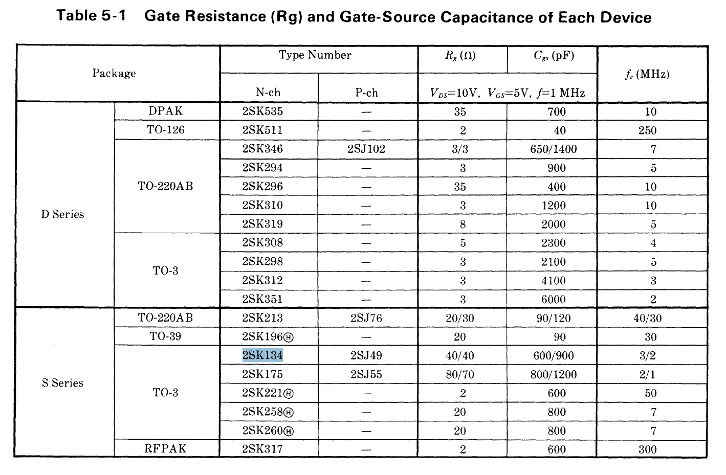

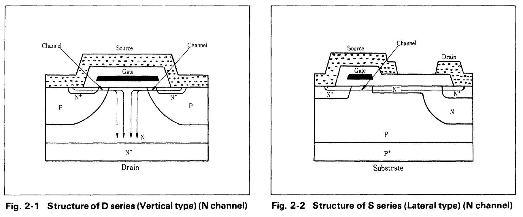

As not everyone agreed I was a bit confused between vertical and lateral mosfets.
Luckily it is all clearly explained in the 1985 Hitachi Power Mosfet Databook (link here).
In a nutshell:
D-series are vertical mosfets (e.g.2SK346-2SJ102)
S-series are lateral mosfets (e.g.2SK134-2SJ49)
See attached figure and table for more info.
