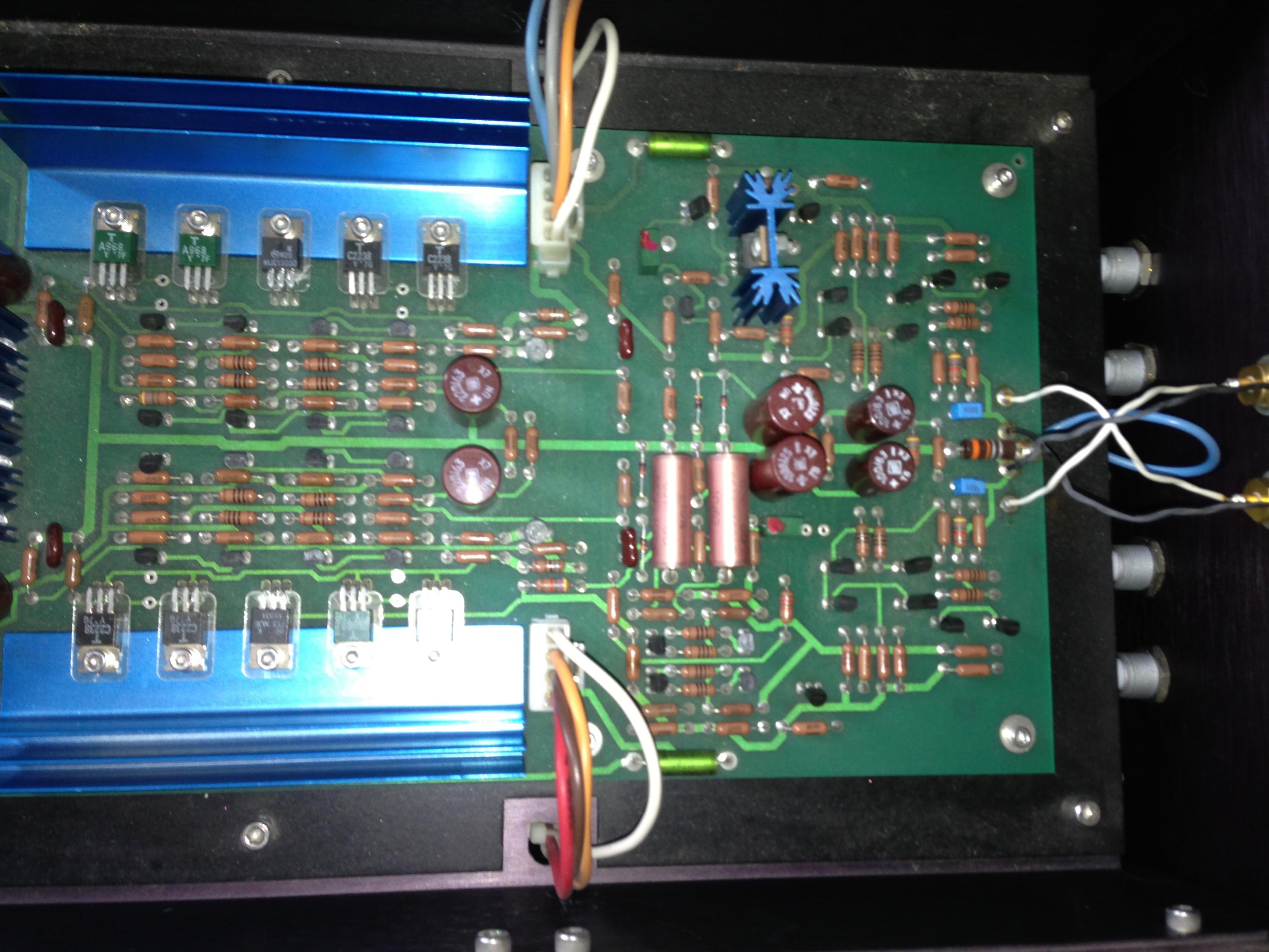

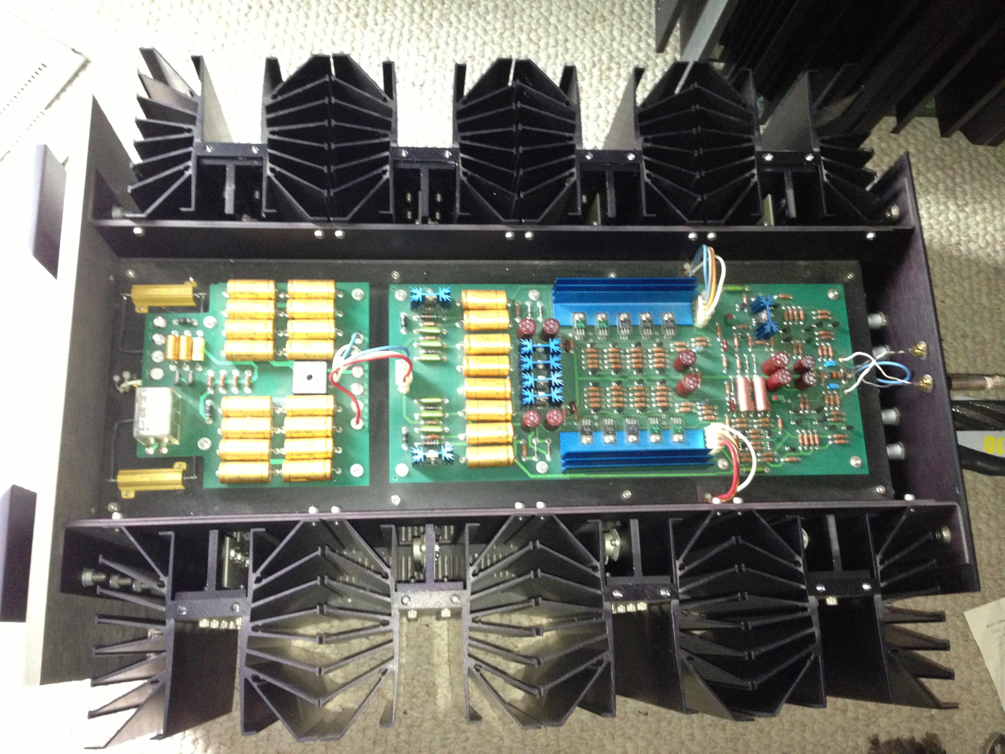

Hi LS
attached are two shots of the KRS 200 with top removed. Hope they are of some value

Thank you for taking the time and effort to post pictures of the internals of your KRS 200 amp. The circuits and PCB layout appear very clean and well thought out when compared to my antique KSA250. Attaching the output transistors directly to the BIG heatsink is much more efficient than the indirect double-interface on the KSA250.
I was hoping to see an obvious trim pot for your DC Servo circuit, but I could not clearly identify it on the main PCB picture. If one of your KRS amp channels has <1.5mV DC offset, it seems logical that all of your amp channels should be capable of approaching this low level. This might change your final plans.

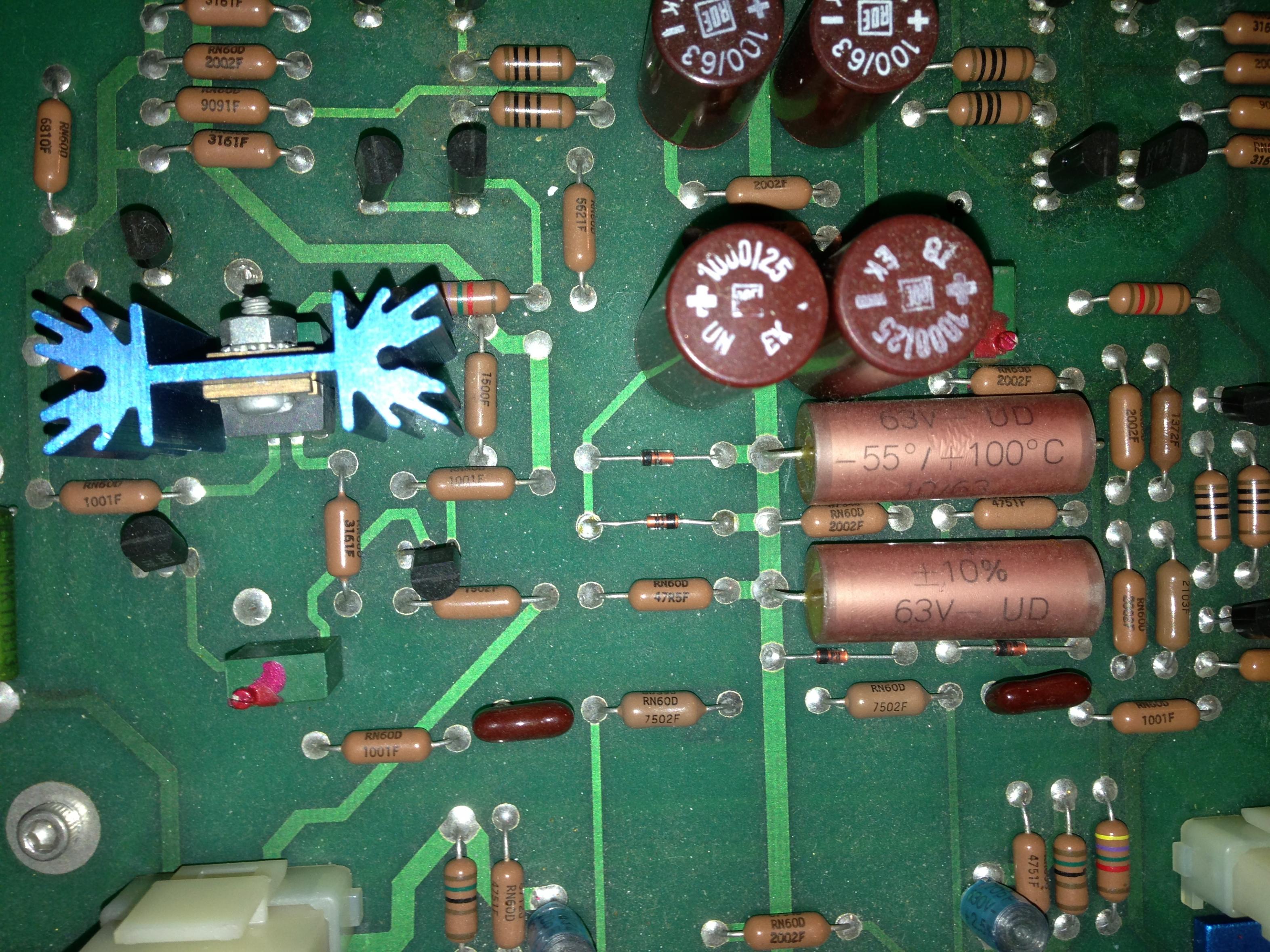

ive attached a close up of the back of the driver boards. i can only find two small components that have a trim feature. you can see the in this picture.

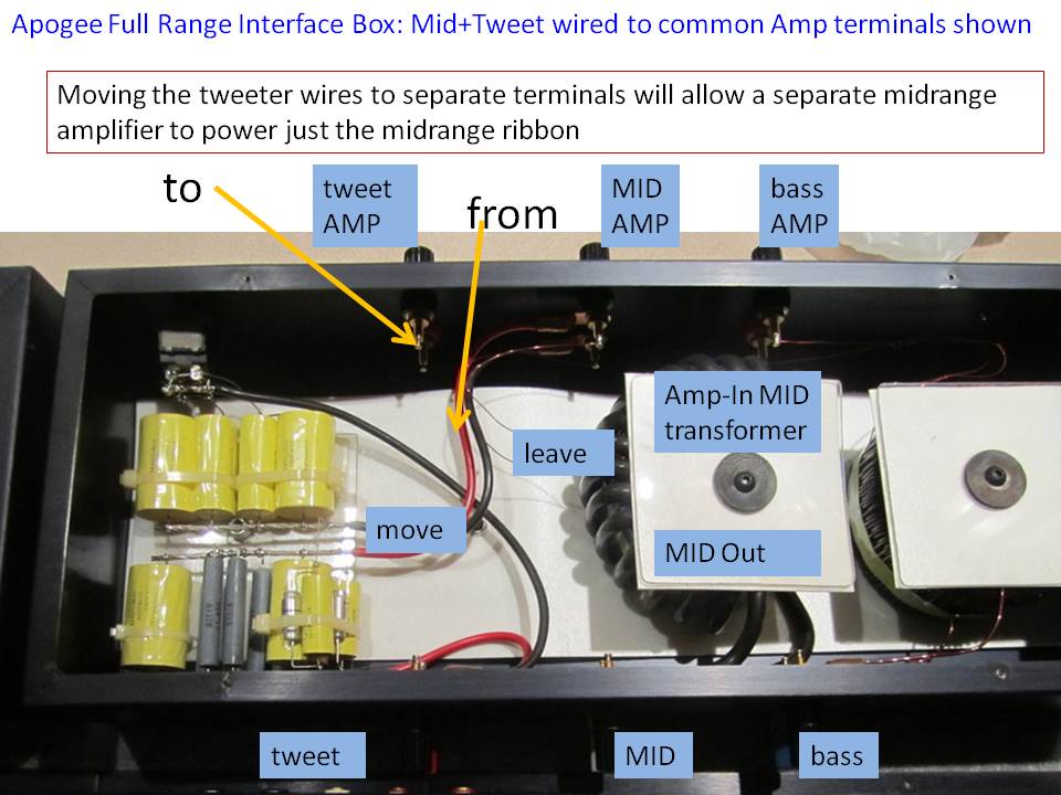

I believe most Full Range interface boxes provide additional terminals on the amplifier side in order to support the option to direct drive each of the three ribbons with Tri-Amp. From the Factory, it was common to have the mid_transformer wires PLUS tweeter Xover passive component wires connected to the same amp terminals for Bi-Amp. If you move the two tweeter wires onto the unused terminals on the amp side you can use the box for tri-amping.
You could always drill extra holes for these amp terminals if your interface box only supports Bi-Amp connection.
If you ever want to experiment with re-wiring your current midrange transformer you would need to:
1) calculate the new turns ratio for the input primary (easy.. just re-measure resistance of mid ribbon as a double check before calcs.)
2) unwind the thin primary wire. NOTE how it is wound. Single-wire? Double-Wire(2x fold)? Tri-Wire(3x fold)? 2x and 3x folding is sometimes used to reduce inductance, but this is less critical with a modest number of turns.
3) Purchase correct gauge wire for: length = 1 ohm
OR you could purchase a new core and have 2 transformers to experiment with. Study the simple, modest turns on your mid transformer to gain confidence.

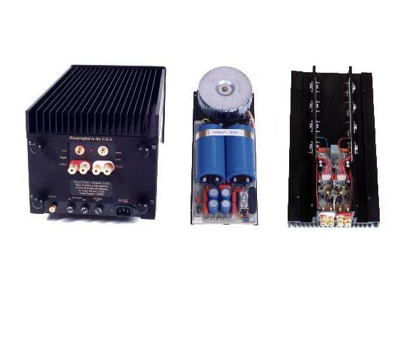

direct drive the TW should be easy - can either just use series capacitor to block dc (Clayton s40 amp should handle the 1 ohm load ok)
I do not recognize any of the pictured circuits as a DC servo. I just do not see the large non-polarized caps used for DC integrators that I normally use. Perphaps another reader will know how to adjust the DC offset level. Your DC direct ribbon experiments prove how important a 1-2mv DC offset is for optimal direct drive safety. I would not personally put a DC servo on the RELAY PCB on the rear panel, but Krell engineers might have selected that location because of access to the output signal.
Your Clayton S40 amp only has 4 output transistors per channel. Your owner's manual would likely spec the maximum continuous power into 1.2ohms. My DIY ribbon amps have 20 * 180-watt outputs/channel for a 1 ohm ribbon. You may end up using the Apogee 4-ohm tweeter interface to avoid damaging the Clayton S40.
