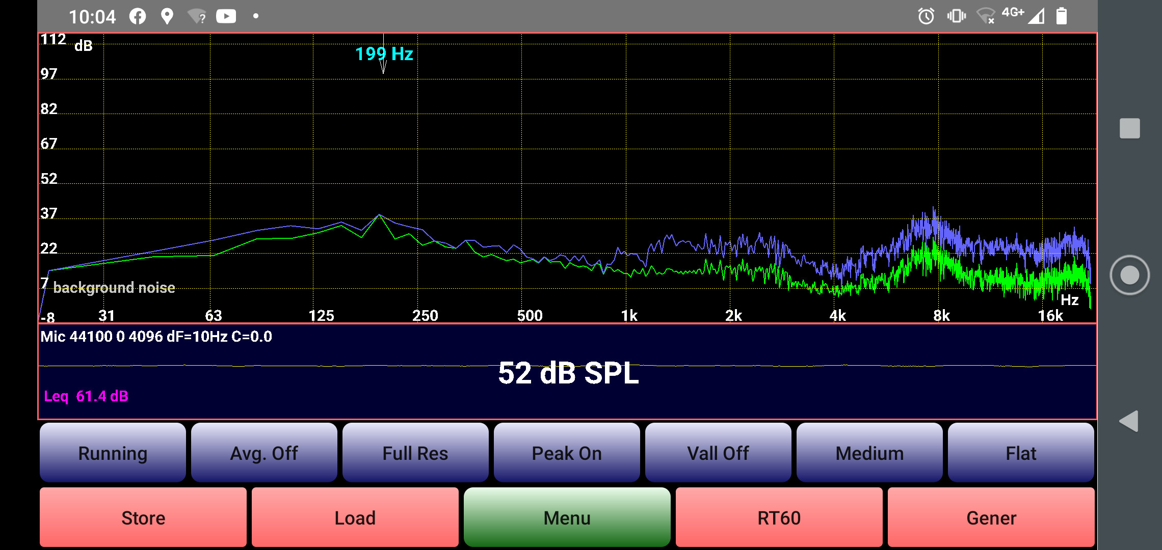

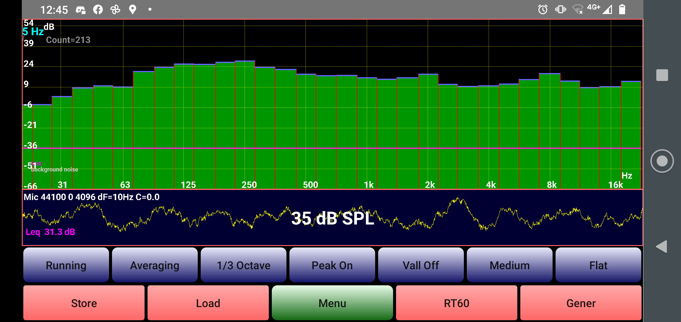

"I don’t say I am looking for ultra-tight measurements of that (or looking to spend the money that could need), but as close as I can get for a reasonably amount of money is what I am looking for."
You get as much or as little detail as you want.
Attached are two screenshots (just measurements of ambient noise) as examples. One is 1/3 octave, the other is "full res".
If you want more detail, or to display the info differently, or to compare minute differences in two tests, you can export the raw data to a computer and plot it (with Excel or whatever).
