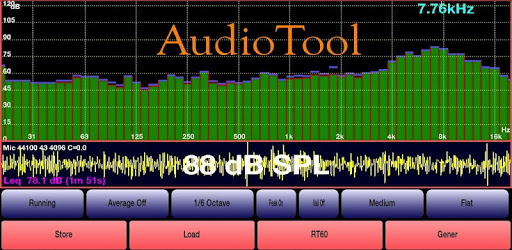

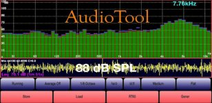

This is what I'd consider essential:
1a) get a measurement mic, e.g. Dayton Audio iMM-6 Calibrated Measurement Microphone for Tablets iPhone iPad and Android.
$20
1b) get an app that works with this, e.g. Audiotool.
$8
1c) get a 3.5mm to RCA adapter that has a fairly long (3+ metre) cable

If you want to try rebuilding the crossover, I'd suggest:
- giving part numbers and/or detailed photos (e.g. that Peerless driver is probably well known, but I can't read the model number).
- give FR plots for the system and individual drivers.
For example, for the Peerless mid, you could hook the driver directly to the amp (no crossover) and play gated noise through it (e.g. 200Hz-20kHz) to show what its raw response is like.
For the tweeter, you'd do the same thing, but play noise an octave higher (2kHz-20kHz)
$20
$8
