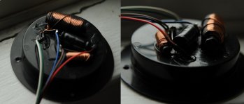

The prob is those crossovers. Each of them consists of only 2 coils and one 4.7uf cap, all glued to the back of the terminal cup. The coils appear to be hand-wound iron core jobs. I have no idea what their values might be. I've sketched what I think is the circuit diagram, but because most of the connections are covered in black glue, it's hard to tell what connects to what.
I've attached the circuit diagram and a photos of the actual unit. Questions:
1. Does the diagram as sketched even make sense? The tested electrical resistance of the woofer is 5 ohms, 10.8 on the midrange (if that tells you anything). Tweeters are 6 ohm nominal.
2. Notice on the photo that on each of the coils, the two leads are twisted together before proceeding to their respective connection points. Would that not effectively bypass those coils?
3. Can induction coils go bad? I plan to test the caps and replace them if they're off-spec. But apparently testing coils requires an oscilloscope. So do I need to worry about them?
Something caused those tweeters to fail, and I'm wondering whether it was a failure in the crossovers.
Yes it makes sence, its not very nice as the midrange and the tweeter play all the high frequancies.
The glue can come loose and they start to vibrate. I imagin providing they dont get hot, glue on the outside might help, I think thier are many other tweeks to do before this.
Most likely some a low powered amplifier "clipped".
