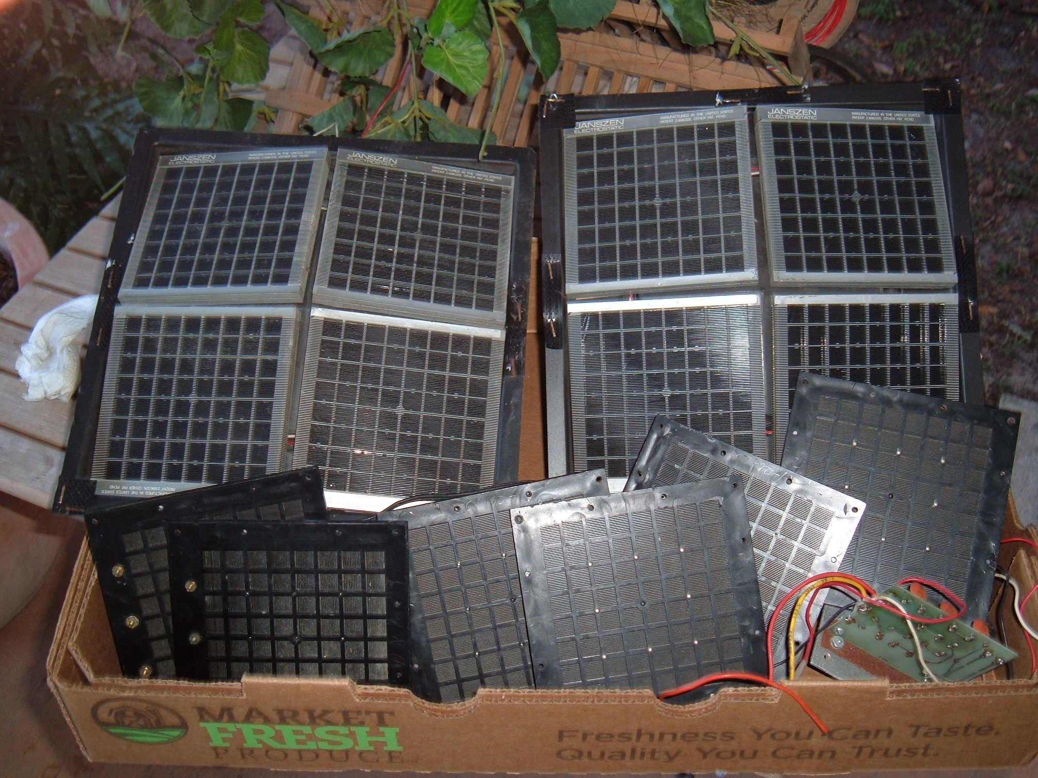

Hi, I have 8 janszen panels that I would like to rebuild. The first one came apart pretty easily and is ready for a new membrane. Since it will not be used below 1800 or so I'm thinking a thinner, 3 micron? The panels are only 5x5 so would heating be enough to tighten the membrane? Would window tape work for attaching the membrane? Spacers?
Hopefully someone can give me some guidance.

The last panel I made, I used a wooden square with holes in it, taped string to the membrane, and threaded the string through the holes in the wooden square and attached small weights.
For the next panel, I will get some washers, and tape these to the membrane, then poke holes with soldering iron, and use fishing swivels to clip the string to the membranes attached washers.
I don't think the tension is terribly critical, as the first time I did it I just taped the membrane to a square and pushed the stator down so the wrinkles where gone.
This said, I have yet to got for matched stereo panels, thats later in my investigations.
the trick with the Janzen's (iirc) is that they used graphite for the coating. this works well for a long time, but when it doesn't, the cells cease to function.
The ones I had did NOT want to come apart cleanly. :(
When I could still hear above 20kHz, I found these panels annoying up there, but that may have been a function of the amplification, not the cells. I don't really see any reason that they could not be done with thinner membrane, but there may or may not be a real advantage. Perhaps the thing to do is to repair one, but clamp it together for testing, and measure to see what the change is. Doesn't need to be pretty.
They have a rather noticeable limit for both SPL and HV bias. Above a certain bias voltage they start to "sizzle". Maybe less in a dry climate? Also they have a definite LF limit.
It's not obvious from the outside, but they are actually a series of edge-to-edge vertical cells, not little square cells all together. The HF dispersion leaves a bit to be desired.
