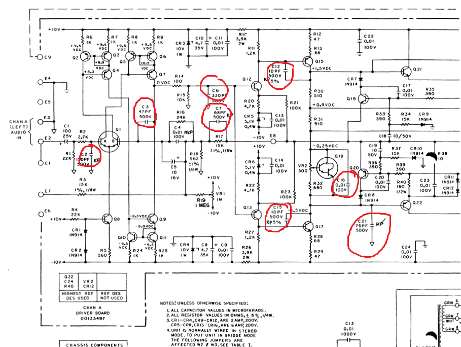

OK then, I'll take a look at the circuit and see what I can come up with. A lot of the stuff to check will seem basic and perhaps unnecessary but it all has to be covered. Depending on the outcome of that we can possibly look at running the amp without the full output stage and drivers.
Administrator
Joined 2007
As the amp has been worked on you need to confirm the following,
1. That the caps marked in red are fitted correctly and have the correct values. Also make sure that the print they connect to goes to where it should (no breaks or hairline cracks).
Also check that C1 (0.1uf on the speaker output side of L1 is present and correct.
2. Confirm all the transistors are the correct type. Have any been replaced ?
3. Confirm that the voltage across the four zeners CR3, CR4, CR5 and CR6 are as marked within 20%
4. Confirm there is around 0.7 volts across R5
That's probably plenty to start with... and we have to start somewhere :)
The ceramic caps on the driver board are all the correct value (and appear to be stock). The traces on the circuit board seem to be fine and pass continuity tests.
All the output transistors on the heat sink are original RCA's with matching codes. Q1 and Q2 on the heat sink also match. I am unsure about the transistors on the driver board, but they appear to be original.
I will check this as soon as I can when I get the amp back together. I did replace CR3 - CR6 diodes with 2% tolerance types in both channels, so the voltages should be okay. I will confirm soon.
I will check this as well when I check the zener diode voltages.
Thank you! I'll keep you posted.

More thoughts, we may as well cover all bases...
You mentioned ceramic caps. These can be troublesome (generally), particularly if they are the small "compressed disc" type. C12, 15 and 21 would be prime suspects due to the voltage they see across them.
C1 I mentioned earlier is also a vital component for stability.

If you link Q15 collector to Q18 collector on the PCB you effectively short out Q11 (which is used as a thermal sensor) from the circuit. Try doing that and see if the bias adjustment behaves any differently. We just need to find a way into the problem with not having a scope to see whats really going on.

I'm also wondering if there could be a problem with one of the driver or pre driver transistors. If one was open circuit base to collector yet still had continuity base to emitter in some form then the amp would still "work" but could behave like it is doing. That might be worth a quick investigation. You could check the volt drops across the base and emitter junctions of the working amp and also of course check the transistor junctions on the meter. The transistors are Q1 and Q2 and Q21 and Q22.

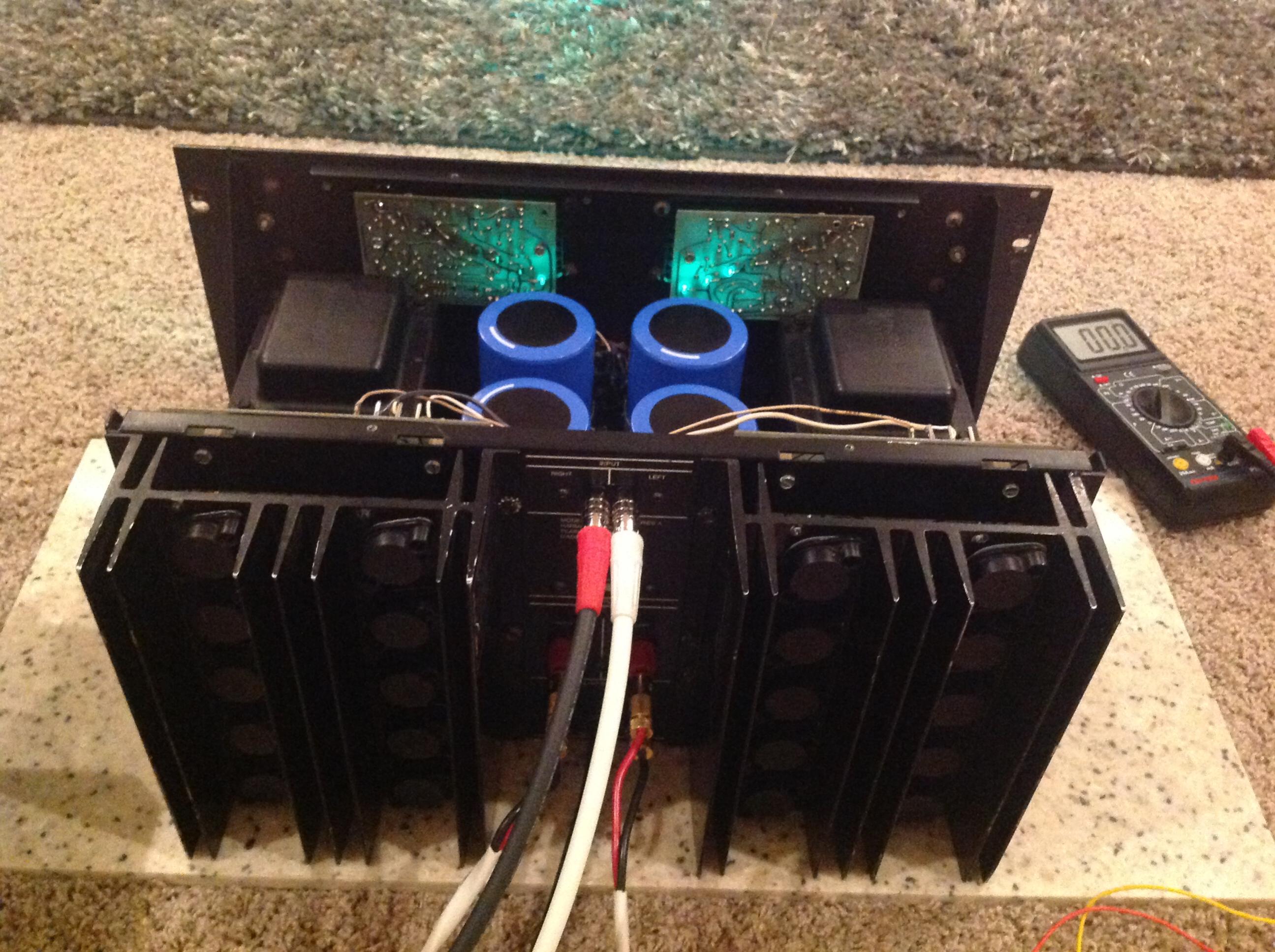

Today, I received the silicon transistor pads so I could put the amp back together.
I carefully cleaned all the power transistor sockets with deoxit; I thought maybe one of those had a crappy connection. I'm not crazy about the transistor sockets -- I don't trust they're making the most secure connection. However, they are stock (and convenient) so I just cleaned them.
I fired it back up with the 300w bulb limiter, and everything seemed better but still not right, at first. I could get the bias reading down to 140mv across an emitter resistor on the bad channel, but below that, things started to go crazy again (the light bulb got brighter and the amp shut itself off and on). However, the idling voltage was smoothly adjustable (just too high).
The other channel was fine.

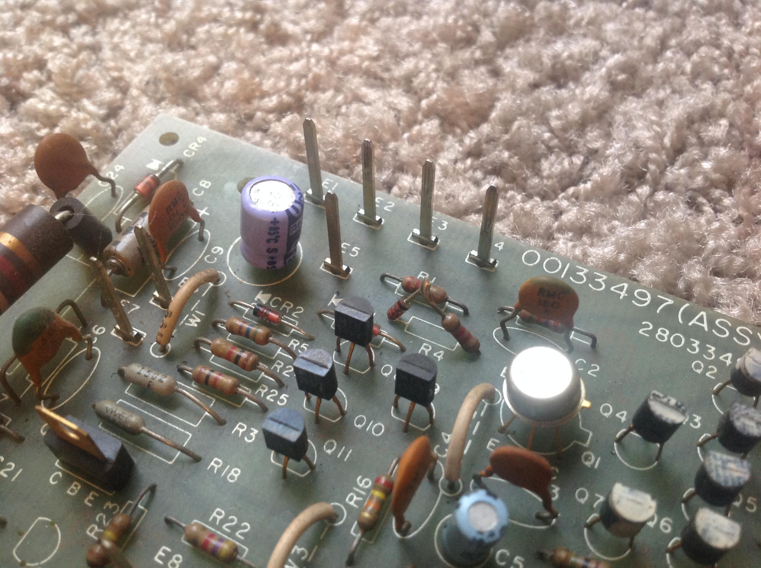

Since I was out of ideas at the moment, I put *back* some seemingly changed components (according to the service manual schematics) because others have suggested these were changes in the production run of the amp. I thought maybe they were done by a tech, but maybe not.
The two changes were (maybe you can explain these to me, because I don't know why they may have been made):
Instead of R4 being 22K (according to the service manual schematic I attached in the first post), there was some type of diode and an 8K resistor in series placed in this spot (see attached picture).
Instead of R32 being 680 ohm, it was 470ohm.
Both channels had these changes when I got the amp, and when I recapped/replaced the diodes, I replaced the parts with what was specified in the service manual.
So, seeing how the changes may have been done by Harman Kardon, I put the 'odd' components back in. This seems to have fixed things (don't know why...but I'm crossing my fingers)....atleast for now -- I don't trust it yet.
However, I can get both channels to around 0V offset with no problem, and I can get both channels to idle at 50mv across the emitter resistors. Distortion in the bad channel seems to be gone.
I didn't change the components in the 'good' channel back to the original values (R4 and R32 and it seems to be stable), but I will if all stays well.
I really hope this is fixed... What do you think of this outcome?

R4... what this does is supply a constant bias current to Q8 which is configured as a classic current sink. Lowering R4 allows more base bias current. That in itself has no impact on the operation of Q8 unless Q8 gain is on the low side and the bias current from 22k is insufficient. The diode (ordinary diode or zener ?) may be to improve switch off behaviour when the amp is powered down.
R32 alter the range of the bias current preset. Lowering it means the transistor is able to be turned off even more at the "maximum bias" end of the pots travel.
If it all sets up OK then that's promising. Any lack of current in Q8 would alter the whole state of the amp and could cause all kinds of issues so R4 is critical in that sense. Once sufficient base current flows then lowering R4 any further has no effect... if that makes sense. And if you had a really high gain transistor then R4 could be much higher and it would all work correctly.

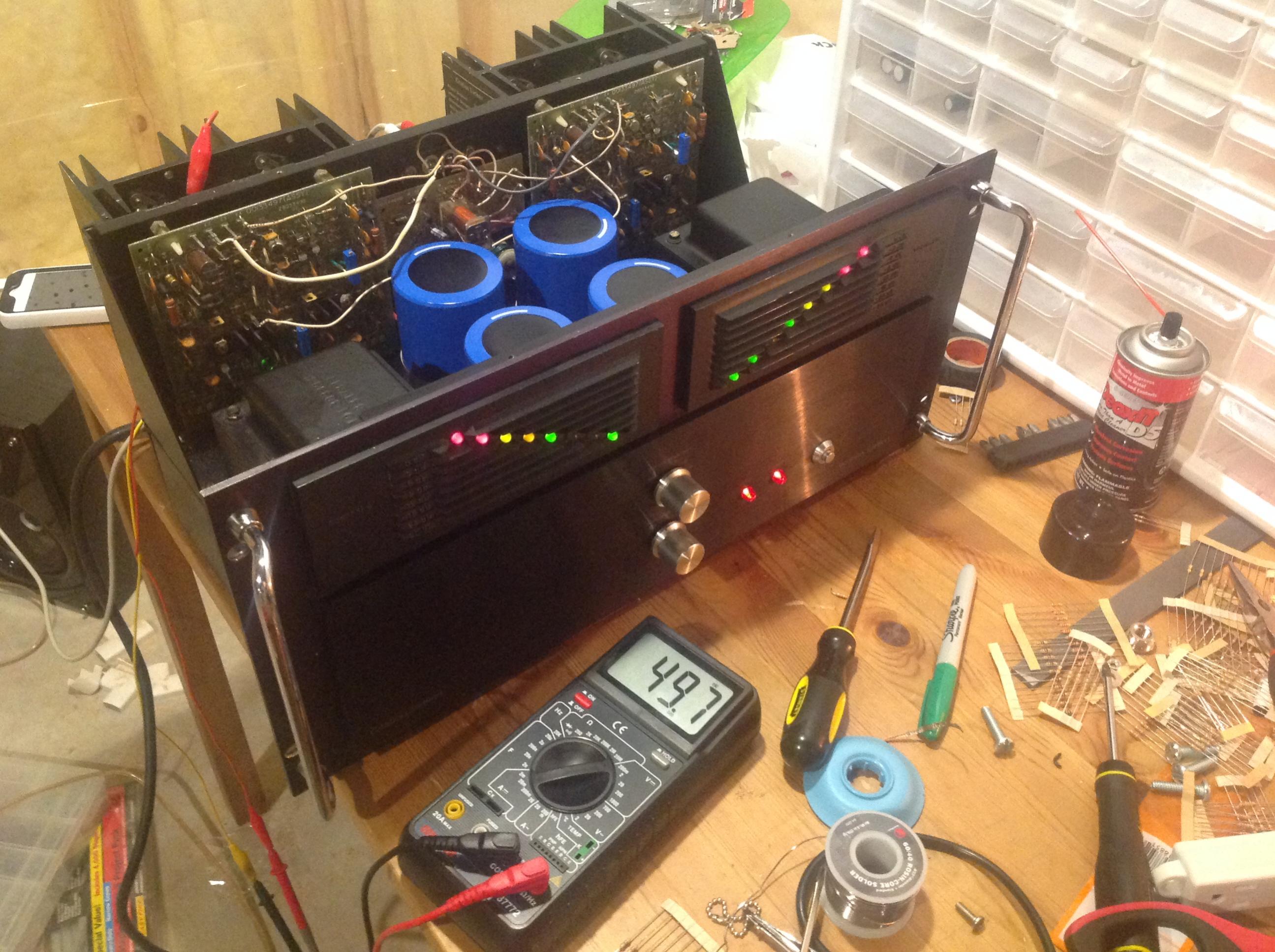

Well, all is still good. Amp is stable at around 1 or 2 mv of offset and the bias is fairly stable at 50mv.
Sounds excellent in my system!! Runs quite warm...
I put bright LEDS in the meters .... this was a terrible idea. (see pics) LOL I need to change them back to normal ones or be blinded.
Thanks again for your help!
