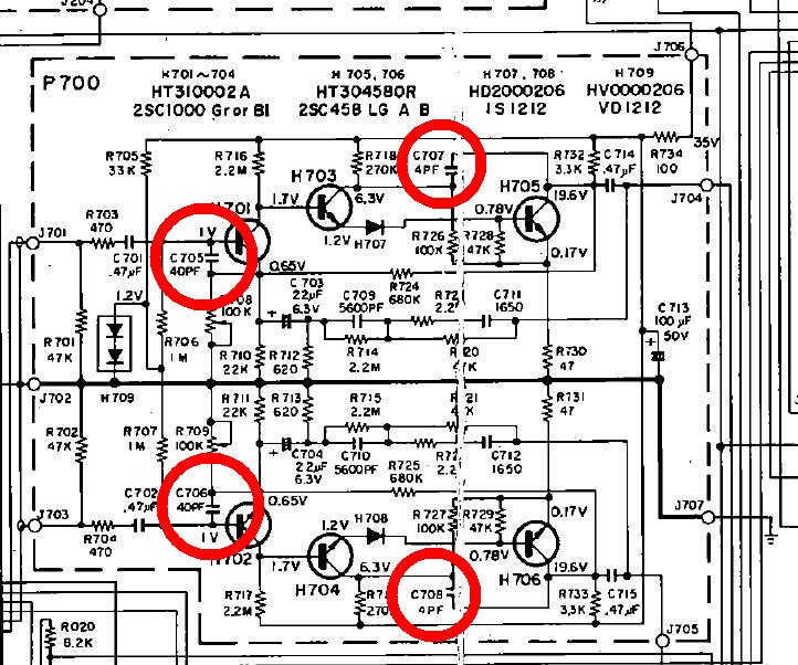

QUESTION:
As I'm going though this receiver, I want to replace
all the old 51 year old ceramic caps with either new
films, or Micas, or new C0Gs.
I haven't done anything with the AM or FM boards, yet
and probably don't want to replace those tuning ceramics.
However for the other boards, like tone amp, etc, is there a
reason to keep the old ceramics in there? They get noisy with age,
they become micophonic etc. I assume even the 51 year old NP0s
on the phono board get that way also.
I'm upgrading Transistors, diodes (and caps) as I come across them
board by board for new modern replacements.
This receiver is for my little girl who loves music.

...I'm fairly certain that C0G/NP0 capacitors didn't exist when this receiver was built. What's there doesn't get noisy with age....
I'm sure "NP0" dates to the early 1950s, in tandem with N1500 and P500- designed-in tempos really helped radio stability. (Coils have a mechanical tempco so you assort cap tempcos to compensate.)
I too never heard a ceramic cap get "a little noise". I have heard them go NOISY, dominating the output, but that seems rare. And there is far too much to go wrong in wholesale re-capping.
Yes the tubular ceramic capacitors with the numerical value in colored paint on them as per the resistor color code were in production in the 50,s , silver mica was very popular in RF sections of receivers previously and I have many dating right into the 60,s .
In large quantities Germany produced ceramic capacitors in disc form in the 40,s and I have a collection of them in "rutile " -titanium dioxide which had a linear temperature dependence .
As the small value RF capacitors held their values and stability I pulled them from uneconomic old tube radios + communications receivers . It paid off as polystyrene capacitors were only pennies back in those days now you are talking a $1+ for each one and the bigger values shoot up in price.
Wiseoldtech, H713, Duncan2, Planobilly, PRR:
Points well taken. Two of the caps actually have NP0 printed on them.
I do have plenty of polystyrene caps and many silver micas.
I also have supply of films and some in smallish values.
The ceramics in question are in the phono section the section I'm working on.
We have 4pf 50v and 40pf 50V ceramics,
I was going to replace the 40pf with modern 47pF 50V C0Gs.
4pP 50V, I do have silver mica RF caps in that value, 4pF 275V,
These are the open frame RF caps, with one mica wafer in the middle
with the silver pressed fit to the mica. I was going to conformal coat these
caps before placing in service on the board.
My standard silver micas I have 10pf or 7 pf have to check.
I've replaced all six transistors with modern KSC1815.
They were the following:
2x 2SC458
4x 2SC1000
The only other thing left to do is installing the new electrolytics.
while ridding the board of the 22 uf solid tantalum caps.
The receiver is 51 years old, it worked when received.

Well just to satisfy myself, I pulled the 40pf caps and tested them
compared to to sets of 47pf C0G caps. The 51 year old NP0s test
better than the new one's from Vishay or Kemet.
Farard value within 0.1pF vs new 2-3pF variation
& d where Marantz d = 0.000 or 0.001 vs new 0.007,0.006.
So, okay I'm glad I asked, and that I confirmed.
I guess I'm just a doubting Thomas, go figure.

I recently sold a Marantz 2230 that I bought new in early 1973. In 48 years of constant use the only repairs it needed were:
-a failed power switch that wouldn't latch (very common failure in these at about 10 years.)
-failed output transistors (one channel failed at about 40 years of age taken out by a failed resistor so I replaced these parts on both channels.)
-the light bulbs that illuminate the dial, STEREO light, tuning meter, etc. (I think I redid these twice over the years and they were due again when I decided to sell the unit.)
All of the caps in the unit were OEM factory units and when I replaced the power transistors an output test showed it meeting original factory specs.
The fact a unit functions does not mean it is working or sounding as good as it should. I recently rebuilt a Marantz 2216. One problem was that the FM sounded bright; it had a broad hump to +3dB in the region from ~2kHz to ~13kHz. Yet it met factory specs because the factory spec was +/- 2dB 20 Hz to 15kHz on FM within which the 3dB lump fitted. Turns out that the deemphasis circuit was a cockup by Marantz with two ƒc, one at ~6kHz and another at ~10kHz, instead of a single ƒc at ~3.2kHz; so the filter starts too shallow and ends too steep. FM is perfect now the deemphasis is implemented correctly.
The same receiver responded amazingly to a capacitor refresh with carefully up-spec capacitors in appropriate places. That diminutive 2216 ended up being the greatest Cinderella to Princess transformation I have heard yet, an absolutely astounding improvement.
