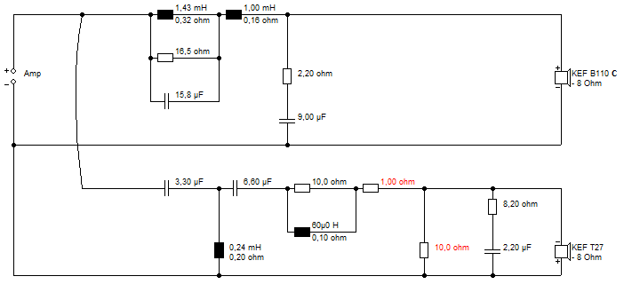

Looks a nice and tidy build but I am curious about the motivation to go for this old and not particularly popular design rather than a modern one? Did you follow the plans exactly or did you make some modifications? Have you take measurements that show the performance of the unconventional line?
I don't see a schematic there. Now, TBH, bass loading and cabinet size is a moveable feast with any design.
The BBC Ls3/5A, which I have heard, was an impressive small monitor for voices.
The 11 ohm version looked like this:
695527d1533501705-crossover-advice-bbc-ls3-5a-schematic-png
Once you get the basic idea, and this is best done by modelling it, you can really do it with any well behaved 5" polycone and 3/4" tweeter. But it is never going to go loud or bassy. 5" doesn't do that.

The articel may be old but it's a typical/usual Transmission Line concept that you can find in many current proposals. There is truly nothing unconventional here except the size. This design never has changed and as all concepts it has it's cons and pros. But the Kefs are outdated.
So I was looking for a chassis whose TS parameters came very close to those of the B110 and luckily found the Monacor SPH-135C. And maybe this speaker can also replace the B110 in an LS3/5A - certainly not without changing the crossover. But one could try to recreate the general concept of this speaker by installing the Bodega kit in such a cabinet.
And Yes, I did measurements. Frequency response exactly follows the "Bodega's". I did some extensive tests before I sealed the enclosure which included variations of the crossover and damping.

I was pretty aware that I was using a kit designed for a vented box in a TML. It was try and error but to my surprise: It is working really really good. If the attempt had failed, I would have built the Bodega and accepted a loss of 30€.
I had been experimenting with the Cobra horns and an active subwoofer for quite a while and then connected the TML the following day. When the music started, I rushed to the subwoofer to turn it off. However, it was not switched on. A friend brought his 2-way Dalis over for comparison and I saw him pale. This may leave an impression what you get for 400€.
