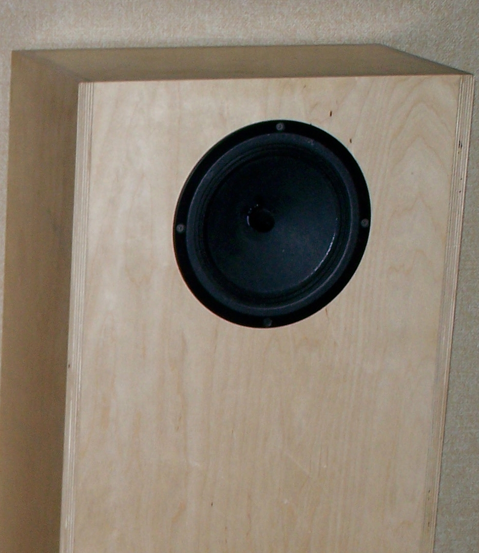

As I own the set of FR8C drivers that Dave cut the whizzers off of, I can say that with a set of his (Dave's) phase plugs, I don't miss the whizzers at all. In fact, I believe that the top end has improved losing them and going with the phase plugs only.
The damage to the whizzers could have ignored...one of them had a small crease in it, but I did want to try phase plugs only.

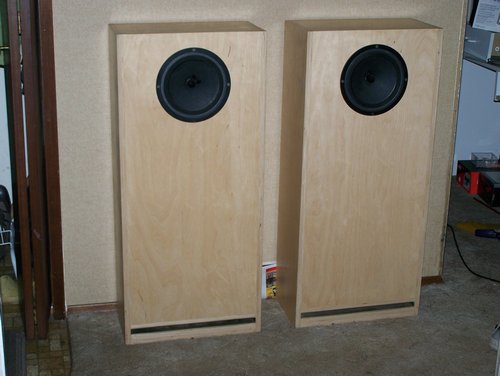

not a great picture....
hope that is viewable.
