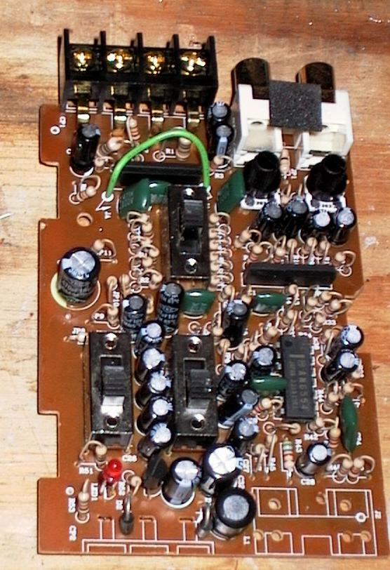

I just bought 2 of these things from parts express for $15 each. I was actually amazed by what you get for your money. I have evsicerated them for other purposes, attached you should find a pic of the guts.
There are 3 opamps on the board, the dip14 is an6554, the sil8 parts are njm4558, I haven't taken the time to check these out yet, but I figure for sub 100hz work, they are probably fine. Caps are mainly electrolytics from YEC, lowest voltage I've found is 25, so the 12v supply could probably be increased to the limits of the IC's to give more headroom...resistors look like generic 5%, probably carbon, but no way (I know of) to tell. There are a handful of green non-electrolytic caps...
As soon as Im done hacking them into the subs I'm constructing I'll be able to give a better review of the sonic quality or lack thereof.

I don't think products could be judged by their brandnames.(although there are some exceptions)
I have acquired a "konzert" car electronic crossover which cost me about US$17 for the unit. and when I had a look at the insides, I get all metal film resistors and metallized caps. gain control is an alps pot, all electrolytics are 25V and 105°C op amps are LF353. it has very good SQ and headroom. local stores over here which carry high end equipment say that this brand is no good. I have one eq/crossover from this store (supposed to be from a good brand, I'm not naming it) and the cheap crossover has much better parts than it (it has greencaps, carbon resistors, etc but the op amps are TL074/72 and have good quality pots)
