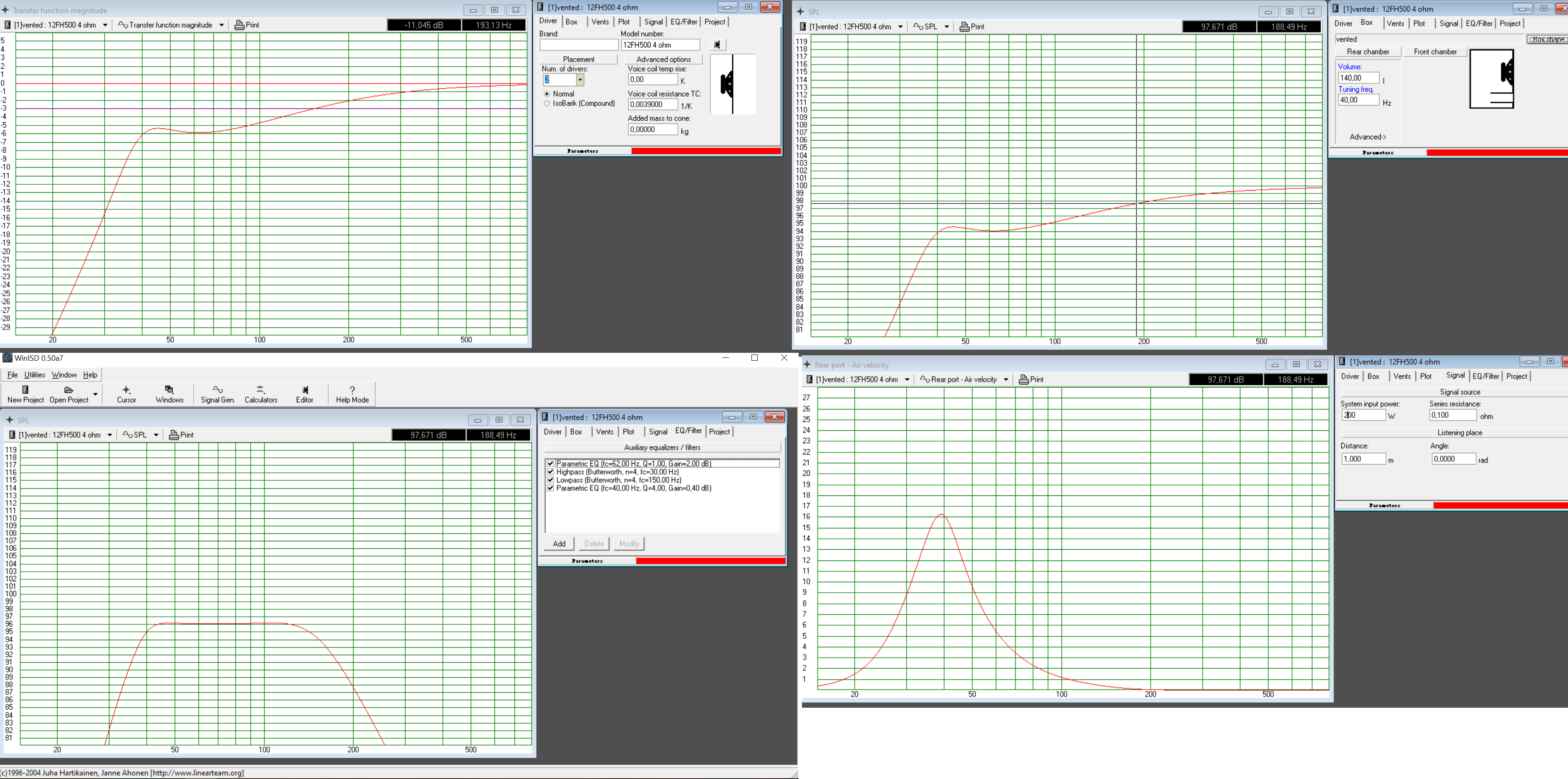

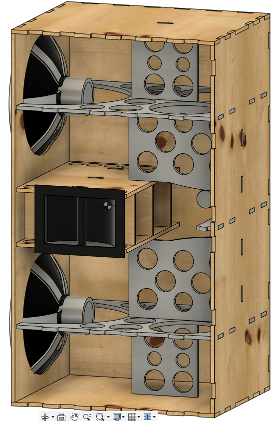

I've spent quite some time designing a reflex sub, which is both compact yet reaches low enough while keeping a good sensitivity, which should be adequate for smaller parties.
The main 3 goals were:
- Under 200 L external (and light), 1 man portable and dimensions for 2 to fit in the trunk.
- Go flat to 40 Hz (ish) with sensitivity of minimum 94 dB
- Cost under 500 euros for the entire thing
It's designed with 9 mm baltic birch in mind using finger joints for easy assembly.
The driver of choice right now is the Faital Pro 12FH500 4 ohm, since I want 2 ohm resistance to be able to draw all of the power of the MA12070 amp, and the driver simulates pretty well.
Fusion360 simulation shows the first modal frequency at 285 Hz, well out of operational passband. I've attached some pictures, both of the design and from WinISD simulations. Group delay peaks at 36 ms at 37 Hz.
Are there any big issues, that I have overlooked, or any good recommendations regarding design?

I will extend the center brace to the back side, thanks

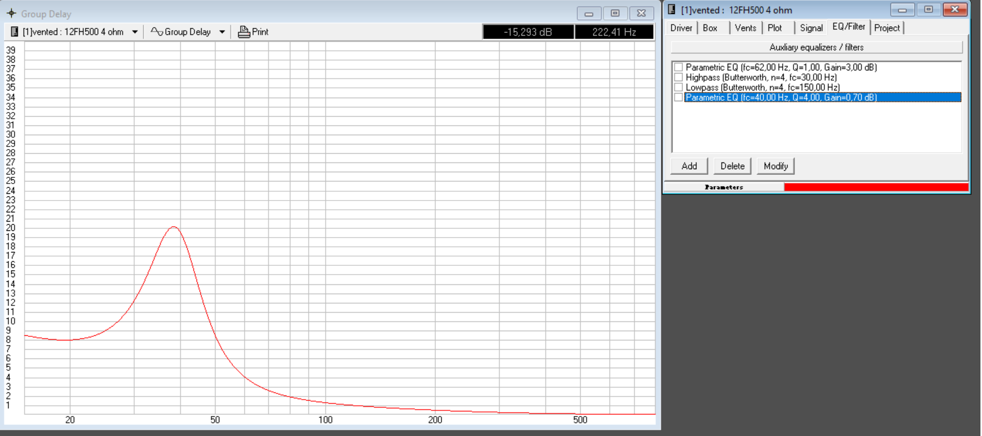

As far as the group delay, the reported delay mentioned was with EQ active. The group delay looks like this without any EQ.
I know I'm giving up some headroom with the EQ, it was done to achieve a flat response.

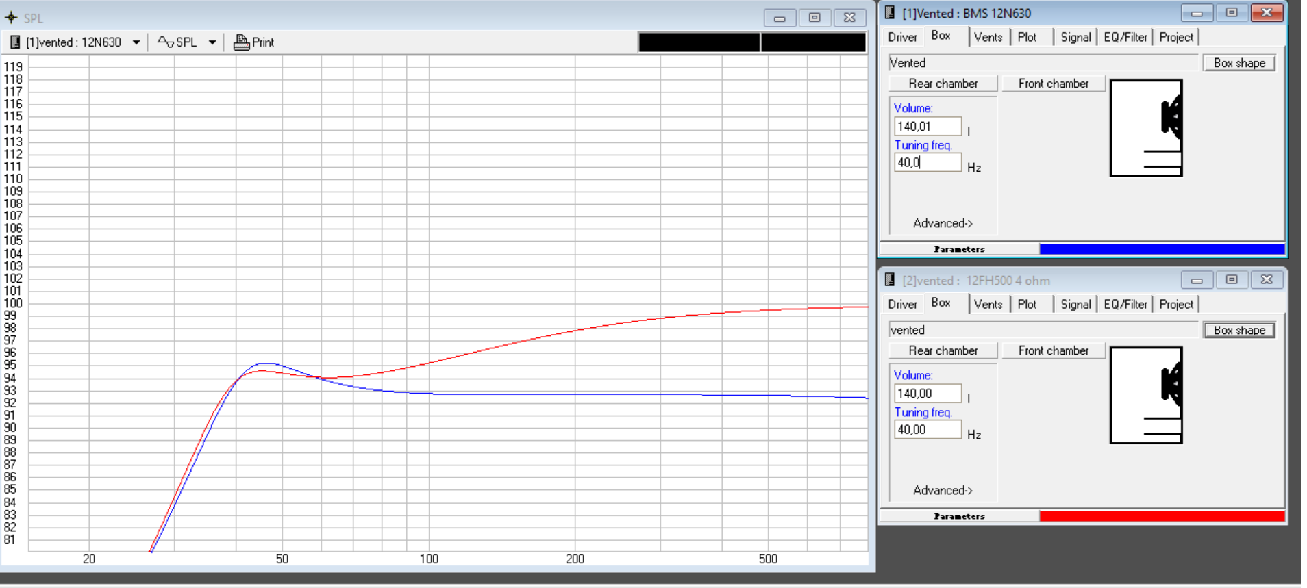

Yeah, I forgot to mention that this is a battery powered system, so the sub will probably never see more than 120 watts. That's also why I've mainly looked at drivers with relatively low mms and high motor strength in order to keep a good sensitivity.
The BMS 12N630 driver looks nice, simulations however show no significant improvements and the cost is 100 euros higher compared to the 12FH500.

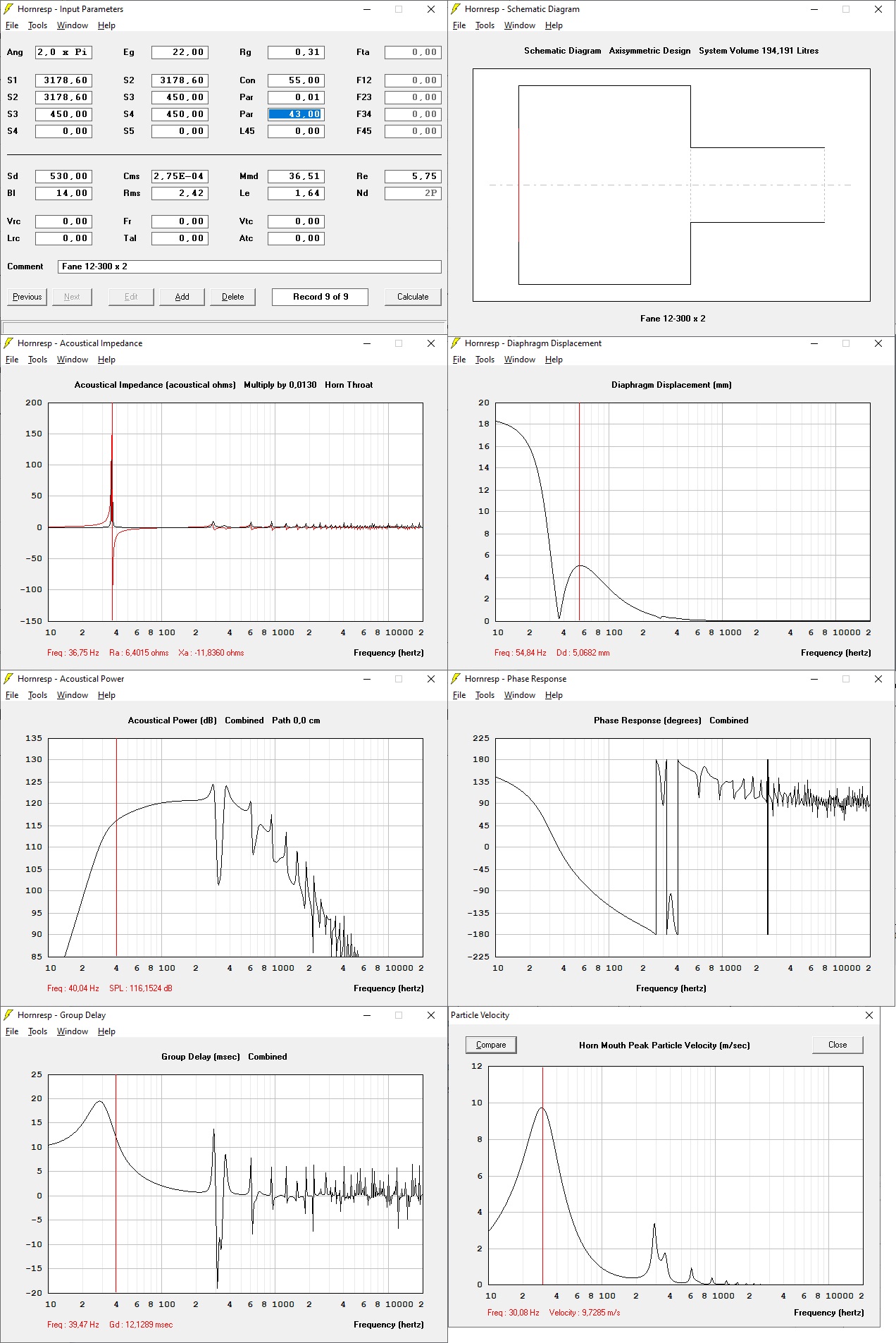

The Fane 12-300 is value for money, even the cast frame PRO version is not that expensive.
I'd prefer using 15mm ply on a box this size, but 12mm should be okay too, still need a bit of bracing but much less. 9mm might need a lot of bracing, so not sure how much weight you save on that compared to 15mm or 12mm.
I have extended the center brace and re-run the nodal simulation without pinning the entire side of the speaker down. Results now show a very small area with resonance at 200 Hz, which I would consider benign. Next resonance is at 300 Hz, so I expect this to be good enough for the amount of power I'm going to use.
I've thought a lot about push-push driver configuration (already have one designet actually), but this box is going to be used in many different configurations, so can't guarantee optimal placement. For that reason I'm going to go with the old faithful front drivers and front port.
I've simmed alot of the driver recommendations, the CL64 is a nice driver, however the 4 ohm version (which I only found on toutlehautparleur) is out of stock for at least 114 days, so I'm sticking with the 12FH500-4.
Handles, flange and speaker grill has already been added, the grill is just very resource intensive for Fusion360, which is why I'm not showing it. Handles are placed right smack in the center of mass.
So far Fusion360 estimates total weight including drivers to be 16 kg, my goal was under 20 kg. External volume is 158.7 L and net volume is 141.5 L.
