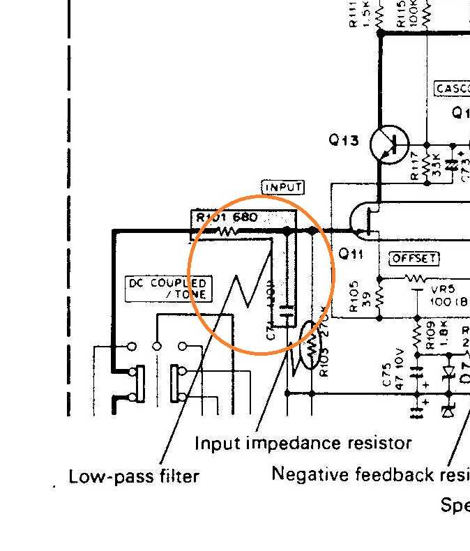

Predicting exactly what conditions will trigger a parasitic oscillation are a bit like predicting the weather; possible in principle, but not always in practice due to chaotic behaviour. Try simple waveforms first, at various levels. You already know the volume control setting which makes the problem appear - that may suggest that the parasitic is in the next stage after that (and affected by impedance), but it could be somewhere else.
Three thoughts in no particular order:
1/ It uses an STK output chip. Prime suspect number #1
2/ Speaker relays can do odd things as current through the contacts rises (signal dependent).
3/ Scope it under the conditions you hear the noise. You should be able to winkle enough info from the scope display to get a hint of what is going on. Use DC coupling for the scope.

I would work with various sine tones to determine if the problem appears on a certain position of volume pot, at a certain voltage of the input signal or at a certain output power.
I got it!.... The low pass filter at the input of the power amp made of 680 ohm series, 120 pF ceramic parallel elements. Corner frequency: 1.95 MHz (WTF?).
Not only the frequency is stupid, but the ceramic cap was in a suspect condition.
(its case was cracked, I guess it worked as a ceramic resonator circuit at some frequencies)
Replaced it with a 1 kOhm - 330 pF styrene cap combo, et voilá, problem solved.
Clean as a bat's whistle....
Big thanks for all of your help guys....

Hi Dragonweed
I'm sorry to spoil the party, but your calculation is wrong.
The impedance driving the the original 120pF capacitor is, 680 Ohms more the output impedance of the volume pot, that in the worst scenario (middle point) can be 25.000 Ohms, (25K) for a 100K pot.
