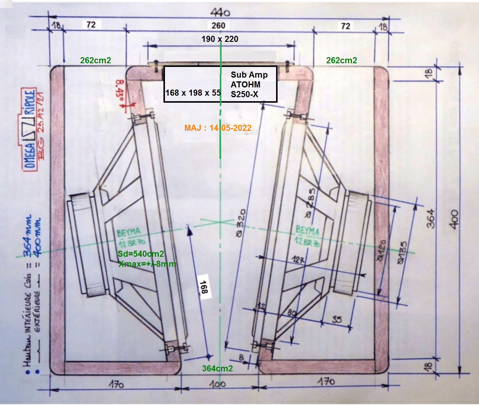

@tubelectronThe drivers that I used are the BEYMA 12BR70 (trusted reliability units for years), Monacor SPH-170 (7") and Audax HM130G0 (5"). My pal used SB Audience Bianco 18SW450-8 on his 2x18 Ripoles.
I have seen drawings for your very nice Omega Mini and Micro.
But I can't find any for the 12" in any forum.
Would you be kind enough to share a link, or maybe post a sketch here ?
Many thanks in advance,
Patrick
PS, I am actually planning to test mini or micro.
A bit undecided, but think that more piston area cannot be a disadvantage.
Any hints ?
You welcome @EUVL - Here you are :
https://guilhemamplification.jimdofree.com/hi-fi-other-projects/
https://diyaudioprojects.com/Forum/viewtopic.php?f=11&t=7327
The major problem with my Mini 7" and Micro 5" Ripoles design is... To find a suitable/quality/practical/compact sub amp module to integrate in the cab ! When I made my tests, I finally found none... That's why today only subsists the Omega Ripole 12", as above.

What is important in the cabinet sizing ?
The front / rear chamfer exit area, or the total volume, or throat-area/depth ?
You also mentioned somewhere that there's no real advantage in having non-parallel walls.
So if the filter/amplifier is external, the width of the cabinet above can be as small as 316mm (with the woofer motor sticking out) ?
Patrick

Why not just use separate amp boards and SMPS which are plentiful in compact sizes too?To find a suitable/quality/practical/compact sub amp module to integrate in the cab

I answered your PM request @EUVL : check it out ! 🙂 😉
About the non-parallel walls : well, that's probably a plus against resonances... But the real reason for me was to gain the space in order to house the sub amp in the cabinet, for an all-integrated, standalone unit.
