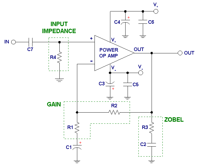

Doing It Right........
If this is your circuit, you need to keep the earth connections of R4 and C1 (electrically) right away from each other, and away from C4//C6 and C3//C5 grounds.
The Zobel network is best across the speaker output terminals.
Understand that if the ground of R4 is modulated by speaker/psu currents, this constitutes positive feedback and will encourage oscillation.
If the ground of C1 is modulated by speaker/psu currents this further contributes intermodulation and maybe instability.
It is ok to run a single psu module, but the grounds of these R4, C1, C4//C6 and C3//C5 components require their own clean connections back to psu central ground.
The input ground and speaker grounds need to reference back to this psu central ground also.
Maybe this is clearer for you now.
Eric.

Please accept my apologies Eric;
I'd claimed that the schemos were posted elsewhere on this thread and that was in error. It was in an earlier thread when I was having trouble getting one channel off the ground (progress of sorts in that now I have one very reliable channel).
Hopefully I've done this right and they're visible here.
Thanks in advance for any help or advice.

Hi Eric;
I just read your most recent post. Okay, I can use a common PS module, but it looks like I need to put some larger decoupling caps next to each chip. Aside from 'buddying up' the grounds between V+ and V- on each chip, I think I'm following your grounding schema closely (lots of discrete ground wires, and the signal leads all ground to the chassis at the volume control at the front, though the output ground ties directly to the star ground. Perhaps I should have a separate 'substar' for it?
Doumo arigatou gozaimasu for your help!

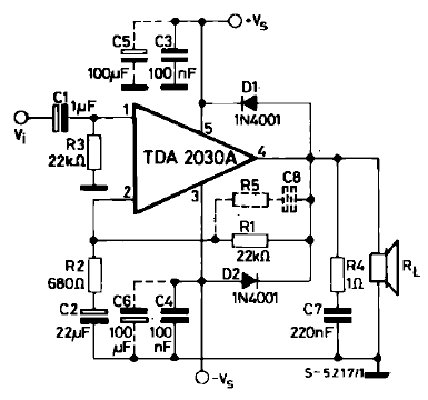

Actally, my schematic is the first one on the datasheet. Basically, it is the same as the one mrfeedback posted, but with a 1M resistor before the input to ground. I guess it isn't neccesary, though.
So, am I to assume that my layout will not work well? I would be powering 2 channels off of a single transformer.
Thanks!
-Mike
Thanks!
-Mike
A zobel network redirects hi-frequency oscillations to ground, if your amp is suffering because of them.
It may or may not be necessary, depends on your system
The Zobel network ensures that the amplifier is loaded at high frequencies.soundNERD said:Another stupid question,
what does that zobel thing do in the schematic anyway?
-Mike
It also provides a loading to induced external pickup in the speaker leads.
Eric.
Will it be needed for the 1875. All the schematics i've seen for it have that on it. I would like to save on parts.
-Mike
-Mike
Yes put the Zobel networks directly across the output terminals - and the component cost is minimal.
