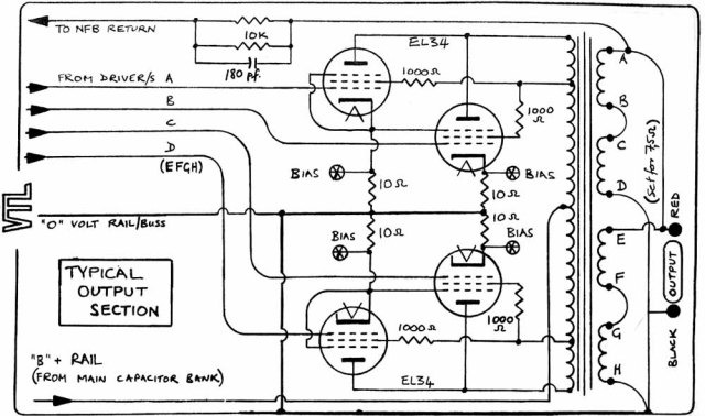

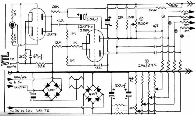

In the moment I have for a VTL compact 100 MONO - go to post #2 under
https://www.diyaudio.com/community/threads/vtl-compact100-monoblock-blows-fuse.170592/
the need to replace the (op amp based with classical and modern TI op-amps) 18db 700hz high-pass sallen key active crossover against a solution with better sound and less active gain stages. Voltage gain factor according the NFB network is a bit less than 100 (< +40db)

2) implementing the sallen key network in the VTL compact 100 mono - basically as described under
http://www.electroniccircuitsdesign.com/audio-circuits/tda2030-active-speaker-audio-systems.html
Advantage: lowest effort regarding parts - possible
Downside: maybe oscillating and additional changing THD character
3) Modify this mono tube power amp to one for an inverted mode and implementing a MFB topology
Advantage: due only NFB best THD behaviour
Disadvantage: heavy efforts to find best topology therefore.
Maybe one of the members have implement such an active crossover network in a tube power amplifier.
