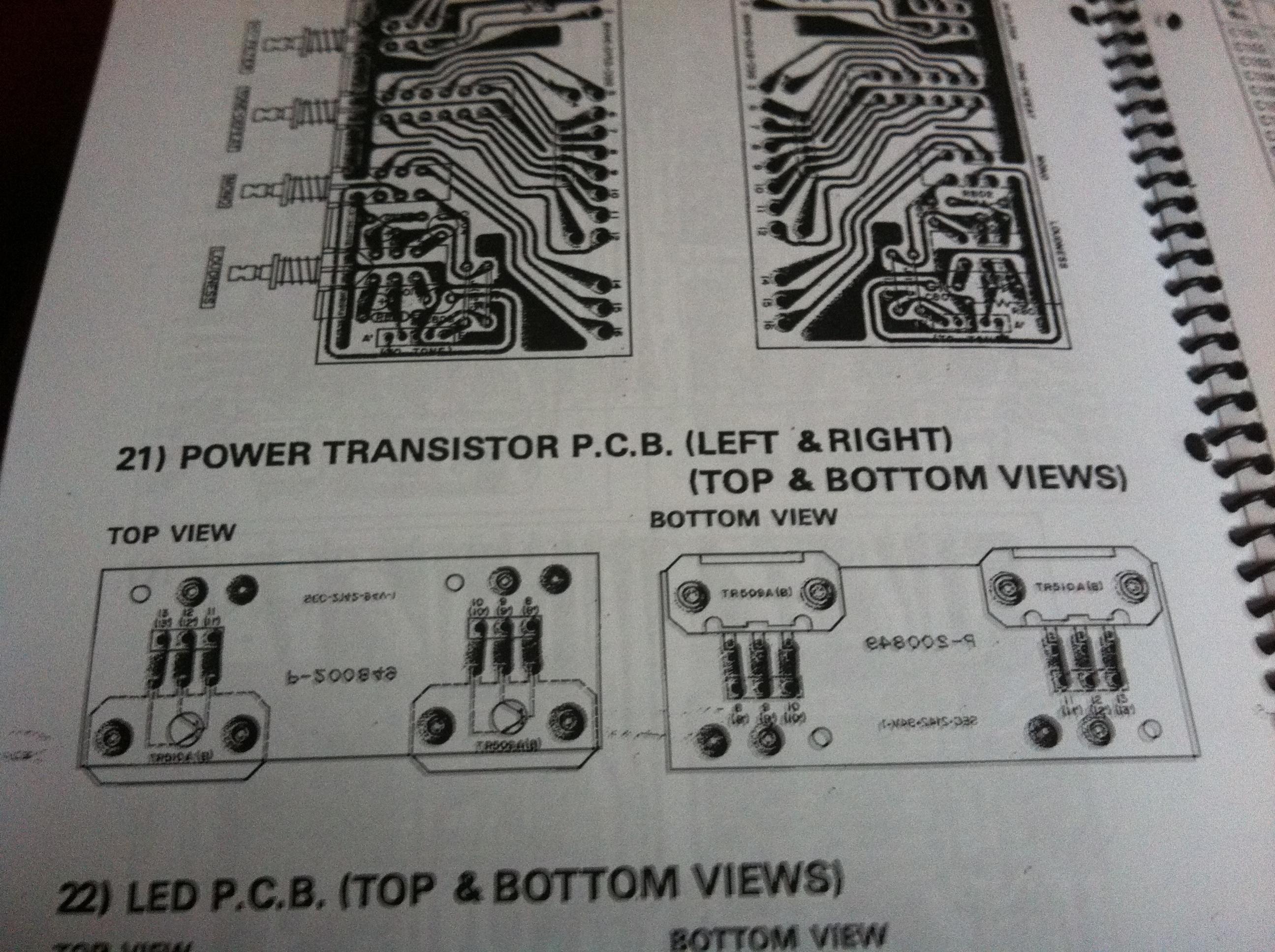

Hi Sofaspud, im new to site. trying to figure out how to navigate website, can you help me on how to post pictures. I have picture of transistors parts list and power transistors P.C.B., want to send to you. just having a little trouble doing so. Im still under moderator review, dont know how long that last. But as soon as i figure this out i'll get you this info. Don't know if exchanging emails is legal, so wont ask.
Thanks much. Could you tell me what the letter codes are that are in parentheses following the parts listings?

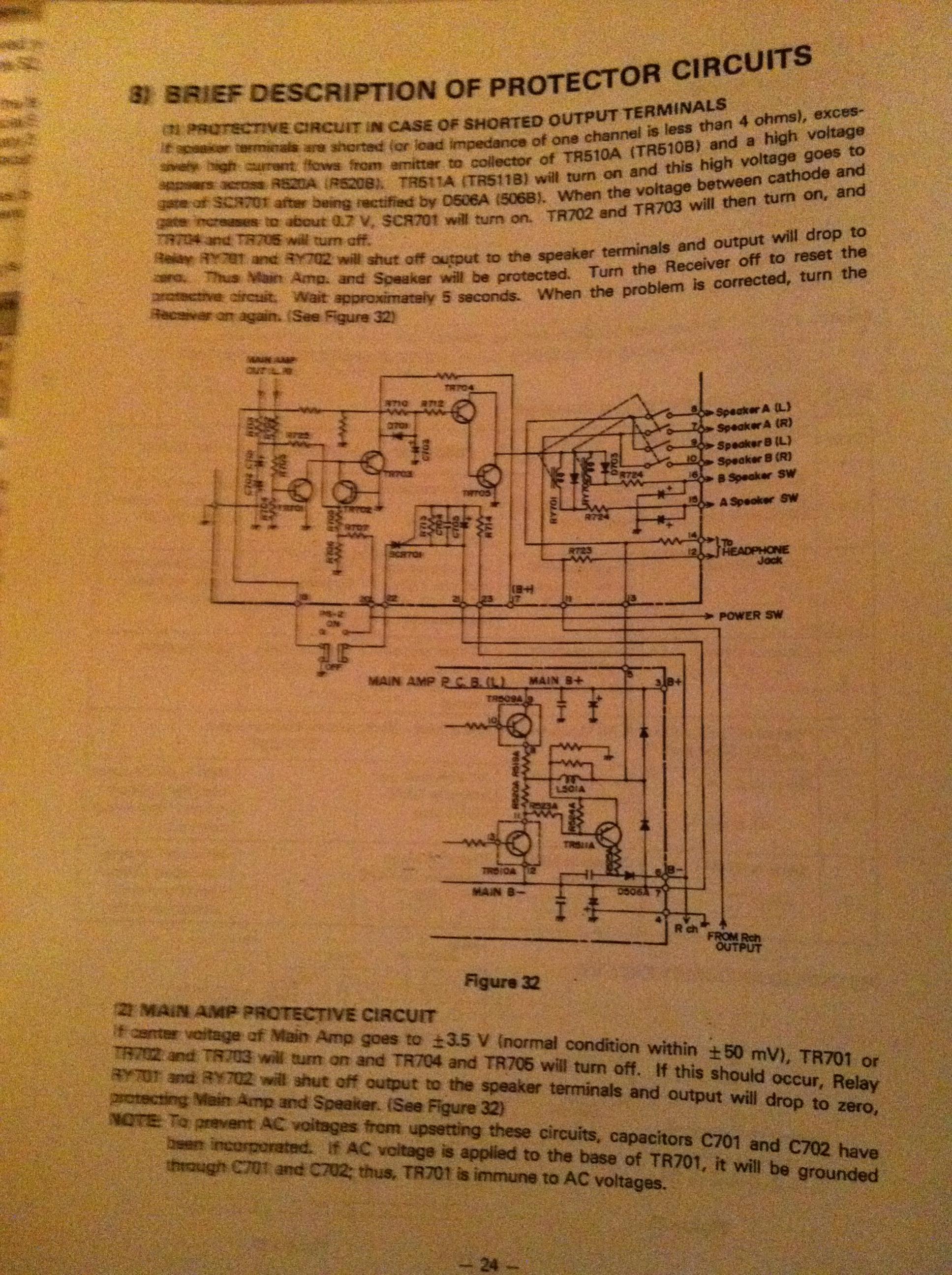

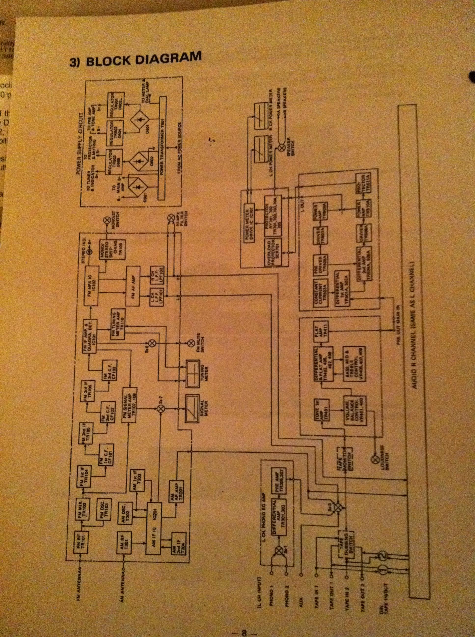

Hi Sofaspud, sorry went out to Academy Records, got some new vinyl. Im sending a few more pics, let me know if u need a specific P.C.B. board wiring diagram. Not sure on suffix for transistors, service manual legend does not provide that info. Im not an electronic engineer, but im sure someone on here can help you out.
hFE / beta ranks. You'll also find these in the datasheets for the respective transistors with the ranges they correspond to.Could you tell me what the letter codes are that are in parentheses following the parts listings?
No apologies necessary. Especially for new vinyl! I see no more pics, but that's probably alright. I had gleaned from the web that this receiver is "prone to channel failure", and that is the problem with mine. So knowing the outputs is helpful info. My best guess is that the letter codes are schematic and/or circuit board navigation aids, so wouldn't be particularly necessary. But if anyone knows for sure I'd appreciate that info. Thanks sgrossklass!

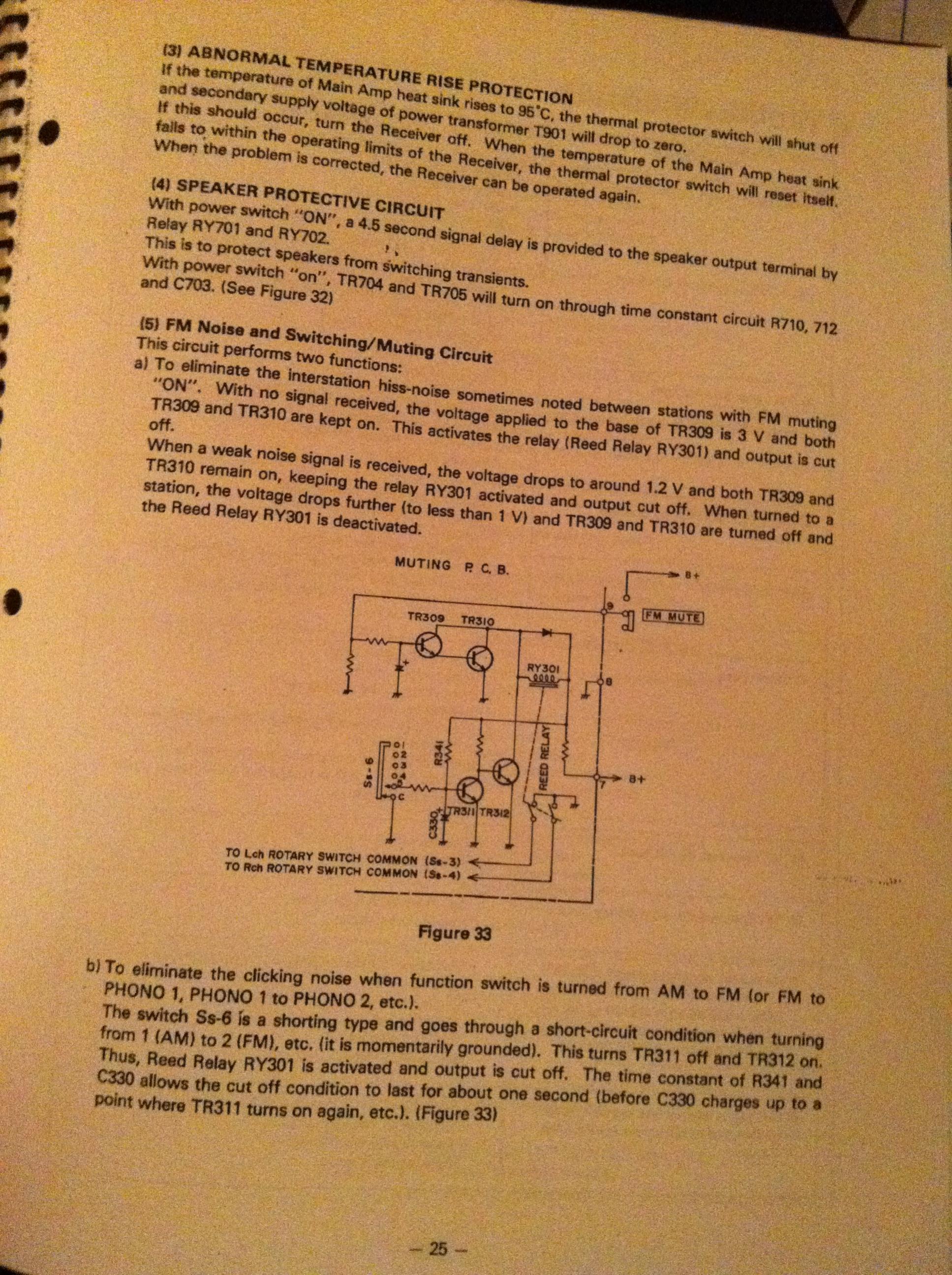

Here are pics again, let me know if i can provide anymore info. Im having issues with a security token missing for the pics i guess. Have to contact the administrator.
STA-2080
Dear Sofaspud, here you go. I hope they help out, let me know what you find. Let me know if I can provide any further documentation, I have been fortunate with my STA-2080 very few problems. Plus I have two backups and a parts unit i picked up cheap. I have a Hitachi HT-550 turntable, love it. Let me know if you run across a parts unit for sale or just one for sale.
