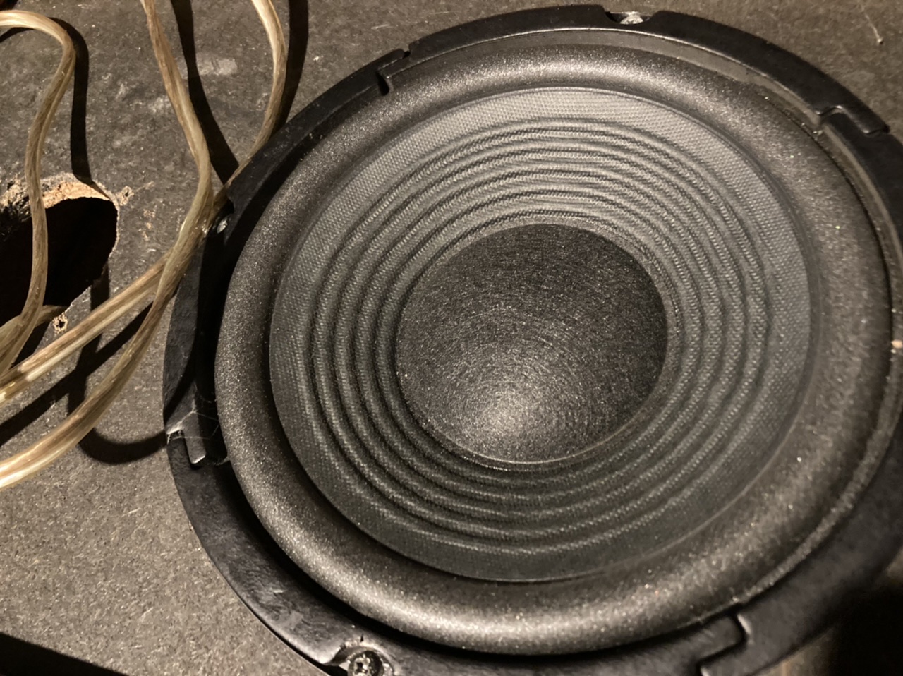

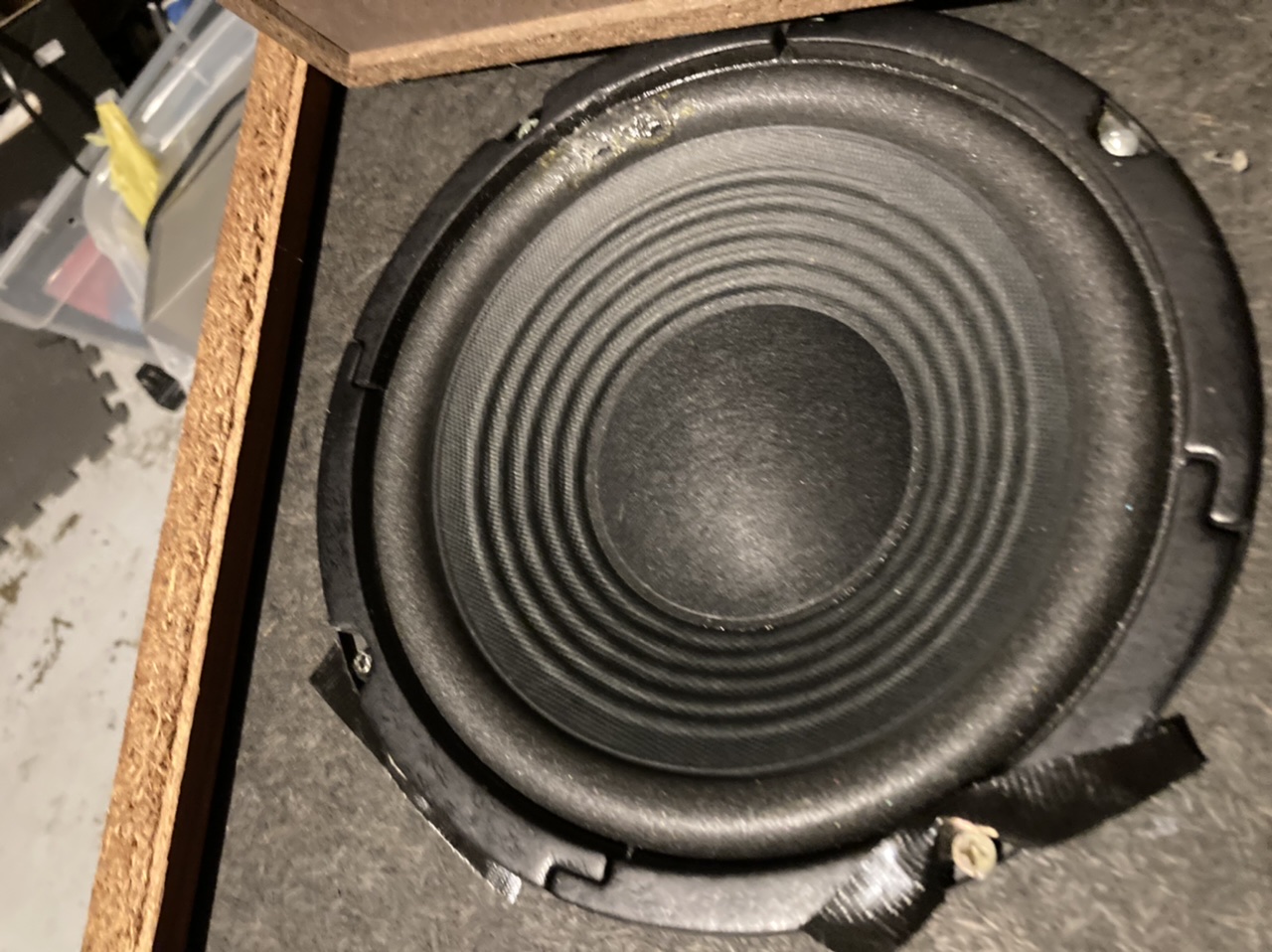

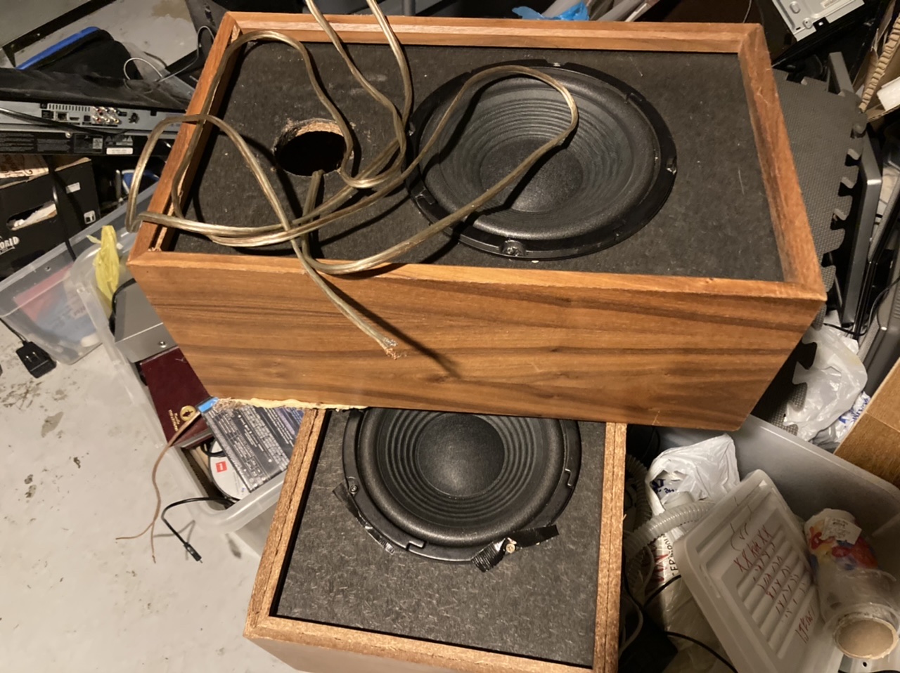

Was wondering what isn’t too expensive but good enough quality to try with this speakers original crossover and diff tweeters . or do I got to buy passive x overs ?
The original tweeters are misplaced somewhere but weren’t that spectacular anyways and very old .. woofers are new visiton, and sound pretty good .

Should really be posted in Multiway section, but the lack of response is probably due to the fact that more information about the speaker system and the current crossover is required.

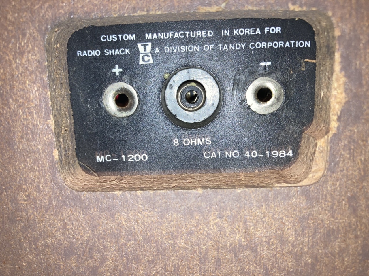

OK, what model?

Realistic MC-1200. Check to see if the cut out hole is 56mm. Galu's tweeter suggestion will probably work fine, if so.

The upside-down photo
Thanks! Shows how well I see without my contacts. 🙁

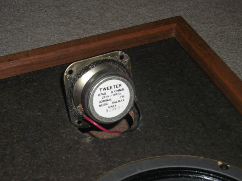

For interest's sake, I attach an image of the MC-1200's original cone tweeter.
I see reference to the tweeter having a single 2.2 uF capacitor as the HF filter, which would give a 6db/octave slope from 9,000 Hz.
The suggested replacement Visaton cone tweeter (resonant frequency 1,500 Hz) should be happy with that.
