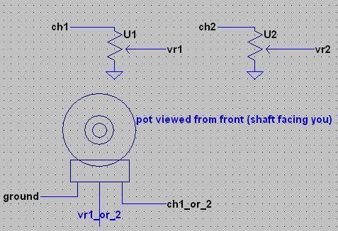

I'm looking for schematics for a realistic solid state amp model# 31-1982B
mostly I just want to figure out how to wire the stereo volume controls cause there was two broken pots.
on the left channel you have 2 points that say "L CH" and two that say "VR1"
same with the right only they say "R CH" and "VR 2"
I have a stereo pot to put it becasue I don't see the point in having two for what I'm doing with it. it's got 2 in put lefts and rights "+" and two input lefts and rights "-"
so what goes where? I've never heard of VR1. if anyone has could you let me know.
VR1 and VR2 are the schematic locations of Variable Resistor 1 and 2.
you could replace the two pots with a dual pot, but if i remember some of that radio shack stuff, especially if it's as old i'm thinking it is, they had separate volume pots, because it saved the price of a second dual pot- the balance control, and two single pots were cheaper than 1 dual pot.
yeah, i got it working, probably not they way it's supposed to be wired, but I just found a couple of guitar pots and just wired both VRs to the right lead on the left channel and the two CH points to the left lead and vr 1 to lead 2 and vr 2 to lead 3.
it makes no sense but the unit turns on and I can control the volume. I just have to turn the left pot to the left to turn it up and to the right to turn it down. I do know from experimenting that you can't wire them the same way. that seems strange to me.

assuming the CH1 and CH2 wires sre the signal coming into the volume control, and the VR1 and VR2 lines are the output lines, here's how they should be wired:

oh man, thanks for all the help guys! I really appreciate it. I think I'm going to order up some parts and get this thing cooking. I was thinking I may as well give it an upgrade. anyone ever upgrade a cheap amp like this? I was thinking just replace the caps with metal film and the opamps with higher end TI or that chips.
a recap would be a good start. i notice there are 4 in the signal path and 1 in the feedback path (C102,C106, C109, and C112, also C110 in the neg feedback path). these are the most critical. next on the list is the bootstrap C111, which if it' marginal will decrease the output swing, and cause distortion. C105,C108, and C114 are essential for keeping AC ripple out of the output (comp-symms like this one and Dynaco amps never get rid of ALL the hum without regulated supplies). you could replace C114 with a 2200uf, but don't go much higher than that. in the process, change D102 and D103 to 3 amp diodes. if you're feeling particularly brave, you could replace D101 and R118 with a real bias transistor (but know what you're getting into first, since a mistake can cost a pair of output transistors).
the (B) taper on the volume control is a log taper, and the control has a loudness tap, which boosts the highs and lows at low levels to keep the amp sound spectrally balanced.
the other pot is a linear (A) taper, it is the balance control.
