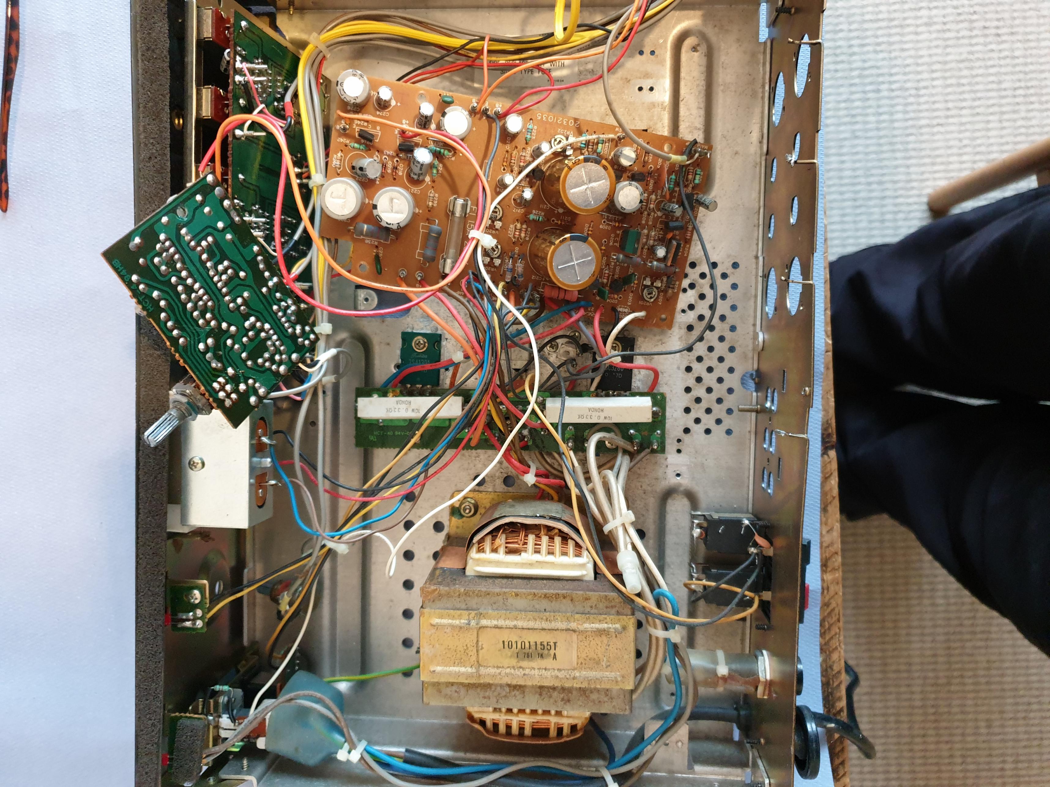

Well found out what those items are one attached to chasis then soldered to rectifier board and the other attached to the transformer there UCHIYA thermostats rated 95°c. Quite high thought be around 75°c. Anyhow I'm assuming they are adjustable by one of the trim pots on the main pcb. Looking for a reset switch but cannot find one so obviously as resistance drops the unit fires back up. Almost done now well over 40 electrolytics in there they have even used ALPS pots. Having looked at a lot of the components now there not cheap rubbish. So they spent a bit of money on this model. Well hopefully the sound is descent after all this work. Surprising since it's a realistic/radio shack most people would not even give it a second thought.

Sorted total recap bit of re wiring gave in there needed doing.
Sound mixer filter mic aux all spot on. Vu working perfectly the reset and clipping lights now extinguished. When first got it they where on permanently.
Sound well can’t fault it. Being a realistic first school of thought crap!!! sure many think that? We’ll I’ll chew my words on that one. Those 2SA1301 & 2SC3280 very nice output.

Oh and by the ways if you do a re cap on one of these I’ll tell you now it’s a nightmare. The rectifier board again is a nightmare to get off and clean up and removing the full wave rectifier well even worse as it sits under the pcb then screwed to chassis and greased up. The transistors easy as pie.
Plus the phono again forgot to mention spot on run my Dual 714q through it nice. You can do a lot with this unit.
