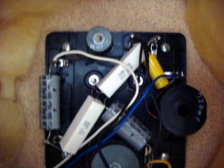

Nice read! Mine has the brown spray painted bottom. I've attached a pic of the crossover. Three inductors, three caps and two resistors. Can anyone tell if this is this one of the cheap crossovers/speakers?

Most any polypropylene cap is going to be a world apart from those 30 year old dried out electrolytics. For cleaning the L-pads I have had good results using Cramolin De-Oxit . What I usually do is remove the back cover by bending the little metal tabs back and then use a small piece of silicon carbide wet-n-dry sandpaper 400 or 600 grit with some of the de-oxit sprayed on it and then finish with a shot of the de-oxit followed by an application of Cramolin preserve-it . these cleaners Can be found at www.partsexpress.com at least I think they still carry them. cleaning or replacment of the l-pads is important even if they are not scrachy as oxidization of the contact point can form a diode causeing rectification of the signal making them sound spitty and gritty .
