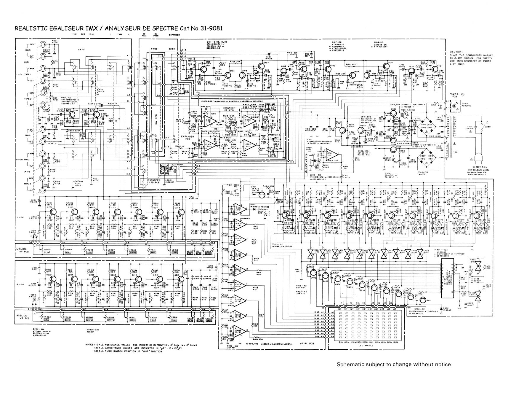

simpler choice is to improve the power supply...
C505/506 in the emitter of the regulators Q503/504
can be increased from the current value of 47uF to 470uf...
C520 and his symetrical (C521?) can be increased from current
22uF to 100uF.....

Wahab is quite right about this, theres a night and difference between those two opamps, 4558 is terrible, ne 5532 is a much better drop in.
I'm not arguing that 5532 is not a better opamp, I'm saying that it would be wasted here - look at the schematic and keep in mind what this unit is designed to do.
Also, don't take this the wrong way but you are one of the "magical component" types who puts exaggerated importance on each part. Sure, it's nice to have the very best in each position but is it necessary? Not really.

So here's how I see it:
Rick wants to get this thing working properly - he wants to reduce that awful hum he recorded (over-the-air and my program had no problem picking out the HUGE spikes at mains frequency and its harmonics - see post #32).
Changing the opamps will not do it.
I have a similar unit and I've done some testing on it. It is dead quiet and it has 4 of these terrible opamps in it.
Help him with his problem, don't fill his head with nonsense.

If filling your head with nonsense is saying that a 4558 is as good or will make no difference you have much to learn, dont forget you said this even before knowing what the opamps did in the circuit.
As for what to do it has already been said, change the 20 year old caps, replace power supply circuit, it has most probably a simple zener circuit, something better and simple would better the original circuit, like voltage regulator or build simple shunt regulator which is another step up, depends on how much trouble the owner wants to go through.

It's true I have much to learn but I want to focus my learning in a sensible way. For example: Understanding the limitations of the equipment you are attempting to improve. It's like putting a dress on a pig, changing opamps in this unit - everyone seems to miss my point here (except jleaman back in post#13 oddly enough).
You see an opamp and the immediate urge is to change it out with a better speced one? That isn't smart. The smart thing to do is assess the benefits of any action before you take it.
Look at the PS, it's regulated - it should be very quiet. Changing the caps is the first, easiest step but it still may not solve his problem.
Fix the hum first, then "improve" the design.
Exactly. The hum is not being caused by poor opamps - it's being caused by a bad supply. Dropping in OPA2134's is only going to make it worse, because they will oscillate.
OK all thanks for your input. Tommorow i will begin with recapping the whole equalizer and give the ne5532p a try.
For the powersupply, Do you think it`s beter to build a new one, and to disconnect the old one. First i will give it a try with new caps, if that not works fine, i will build a new one i think. Some suggestions for a really good power supply wit any schematics?
Use either 7815/7915 regulators or if you want to be a little more posh, use LM317/337. I wouldn't bother with anything more complex than this.
You could simply remove Q503/Q504 and connect the regulator inputs to where the collector pins were, and the outputs to where the emitter pins were.
