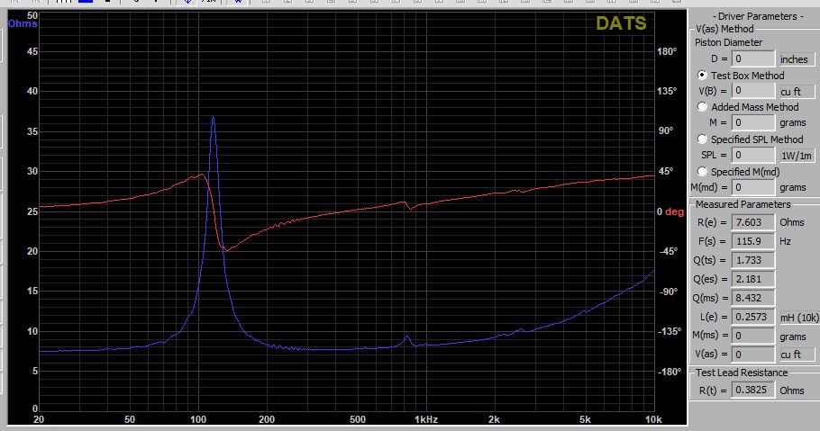

Hard to say, the baskets do not look Coral. The 2nd driver, if those measures are at all accurate, suggest that it is toast.

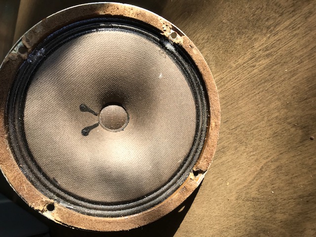

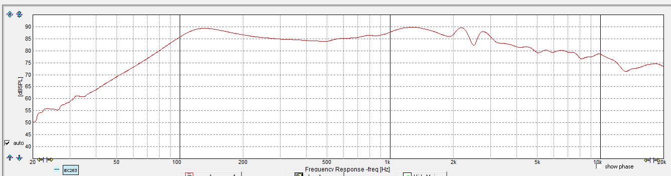

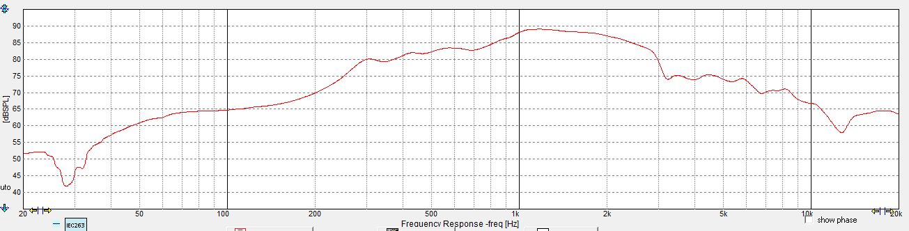

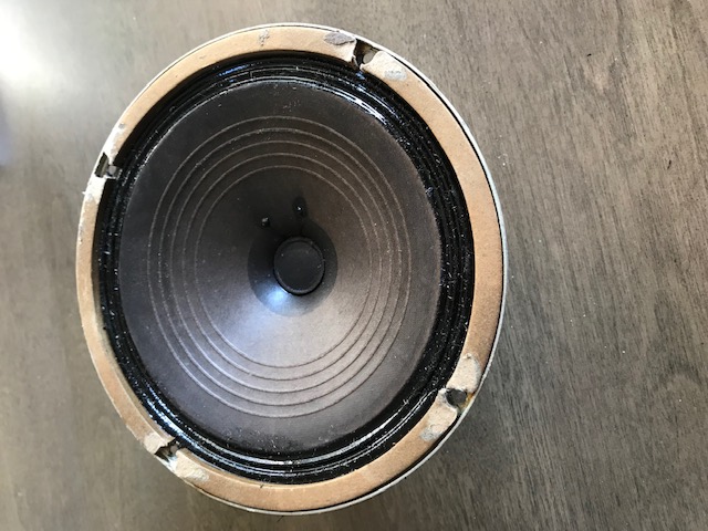

Yes, I thought the driver that has the concentric circles on its cone (ribbed) must have problems but it passed the buzz test and produces sound. I re-tested a couple times to make sure that the values above were correct. Below, I have done nearfield frequency responses for both drivers.
Smooth surface mid-range driver
Ribbed surface mid-range driver
Also, is the roll-off that starts about 2k - 3k on these drivers the reason that there is no inductor on the mid-range?
