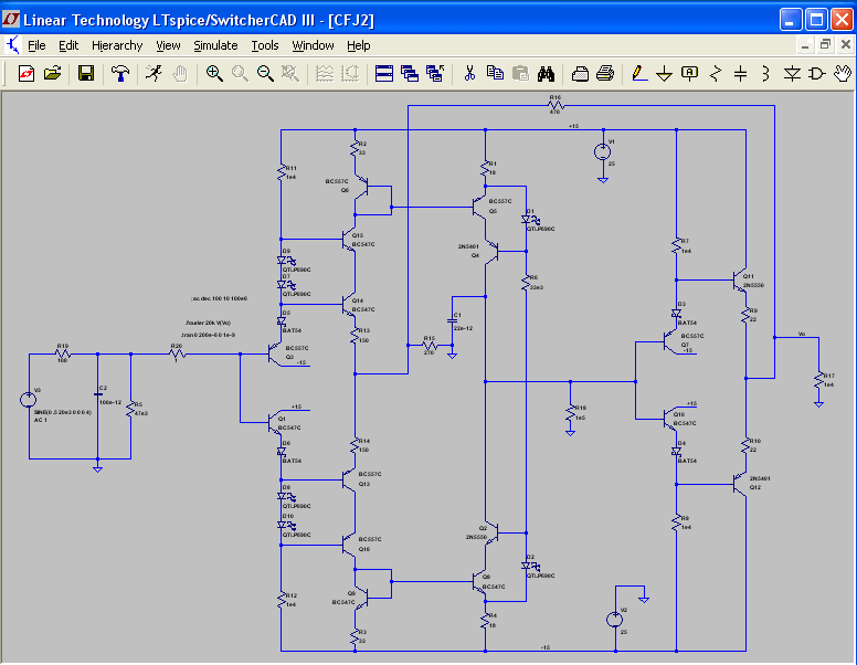

Heres my discrete op-amp effort. Will need the addition of a shunt regulator - something similar to Edmonds/Syn08 PGPA topology.
Distortion simulates at nearly -130db ref 0db output. Output flat to 10MHz (-3db) so in practical application it would require some input filtering. In ppm terms this distortion is around 0.7ppm. There is no discernable 2nd harmonic and just a hint of some third if you look at the FFT plot.
Yes, it does have feedback. However, you can change the loop gain by altering the value of R18 - also then you can lower the value of C1. The distortion does increase, but even with c. 15db of loop gain (so R18 set to 4k7), the 2nd and 3rd harmonics ref 0db out are below -100db or about 12ppm. Again, after th e 3rd harmonic there is nothing on the plot - its very clean. not bad for this level of low loop gain.
These figures are admitedly simulated. They still don't come close to a $4 LM4562 which can deliver better performance but with all the bugs ironed out (eg PSRR, offset etc). I guess a big challenge converting a paper design like this to a working discrete op-amp is in the physical execution. Syn08 can comment here!

bonsai, the thing with taking a simulated design and actually building it is that your simulated components aren't imperfect. real components are imperfect. real transistors have different betas and Vbe. 1k resistors aren't always 1k, with a 5% tolerance a 1k can be anywhere between 950 ans 1050 ohms, components also have lead inductances and resistances. they hace pin-to-pin capacitances. electrolytic caps have ESR. all of these things (and more) will affect your circuit's performance.
Looks like a Spice file
for some simulator.
Not LTSpice what I can see.
CFJ2.asc
CFJ2.plt
The plot file has got this for Fourier FFT

Thanks Salas, Thanks Lineup.
Unclejed, Yes, I know the components in a simulation are not perfect remeber the fully balanced current mirror loaded amps - simulate perfectly but cannot be built in practice) - but its pretty easy to change the values in th e simulation and then check the results - I have not done that yet.
Right now I just finished laying out my LM4562 based balanced pre-amp. I'll be looking into a discrete based design in the near future, but I still have a lot of work to do to decide exactly what topology to use, whether is bipolar or JFET based f/end, VFB or CFB etc.
