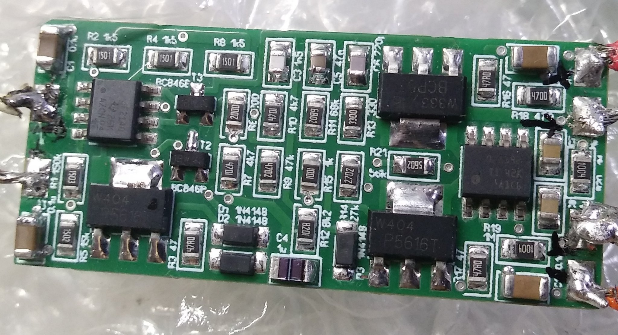

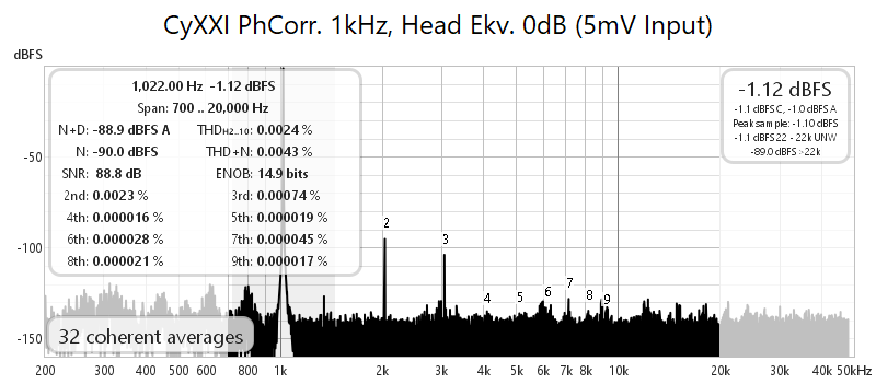

real measurements of phono S/NR
PCB 20x45x3 mm, THD with "tubeslike" 2d and 3d harmonics, but at levels much lower.
