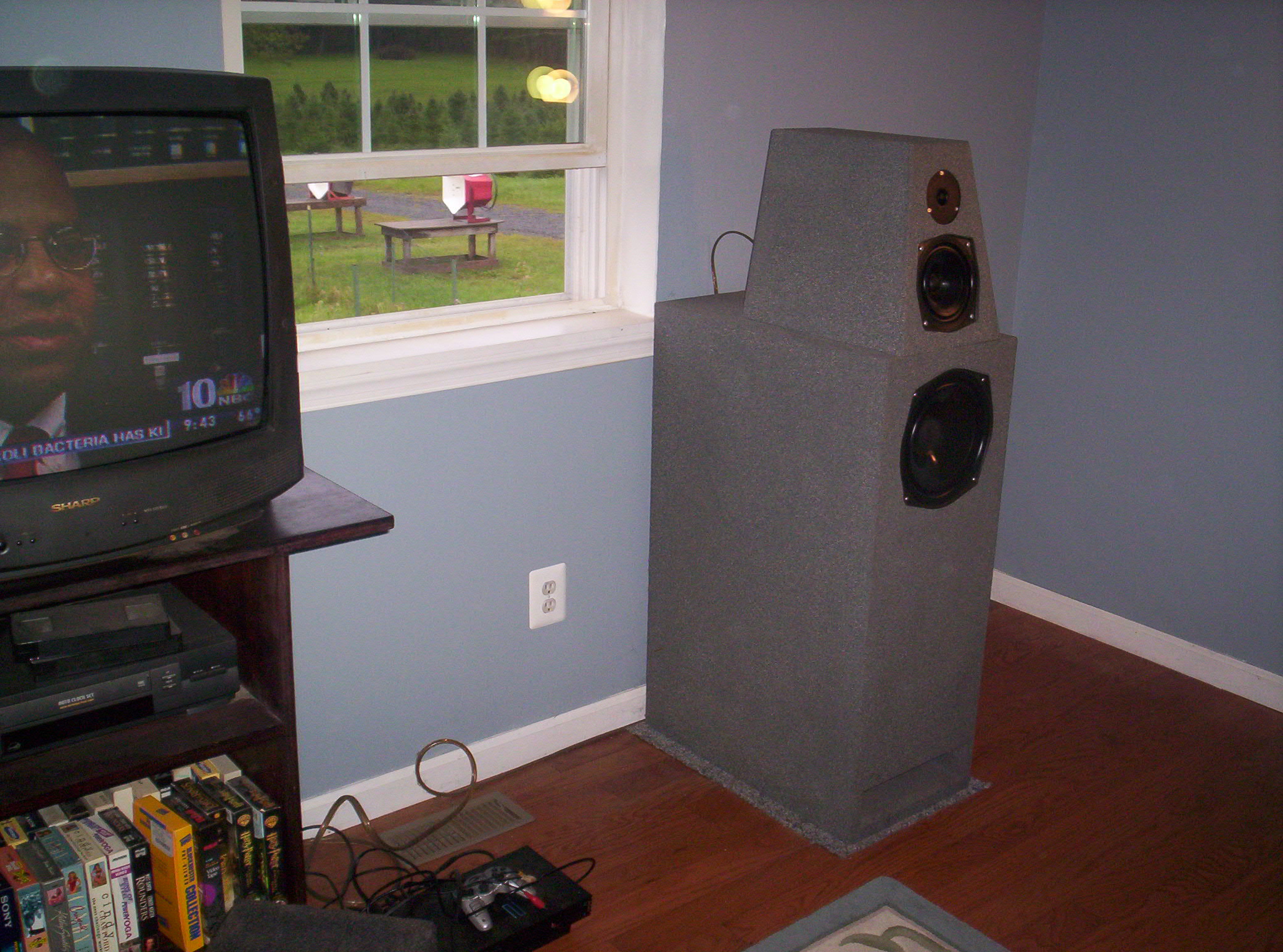

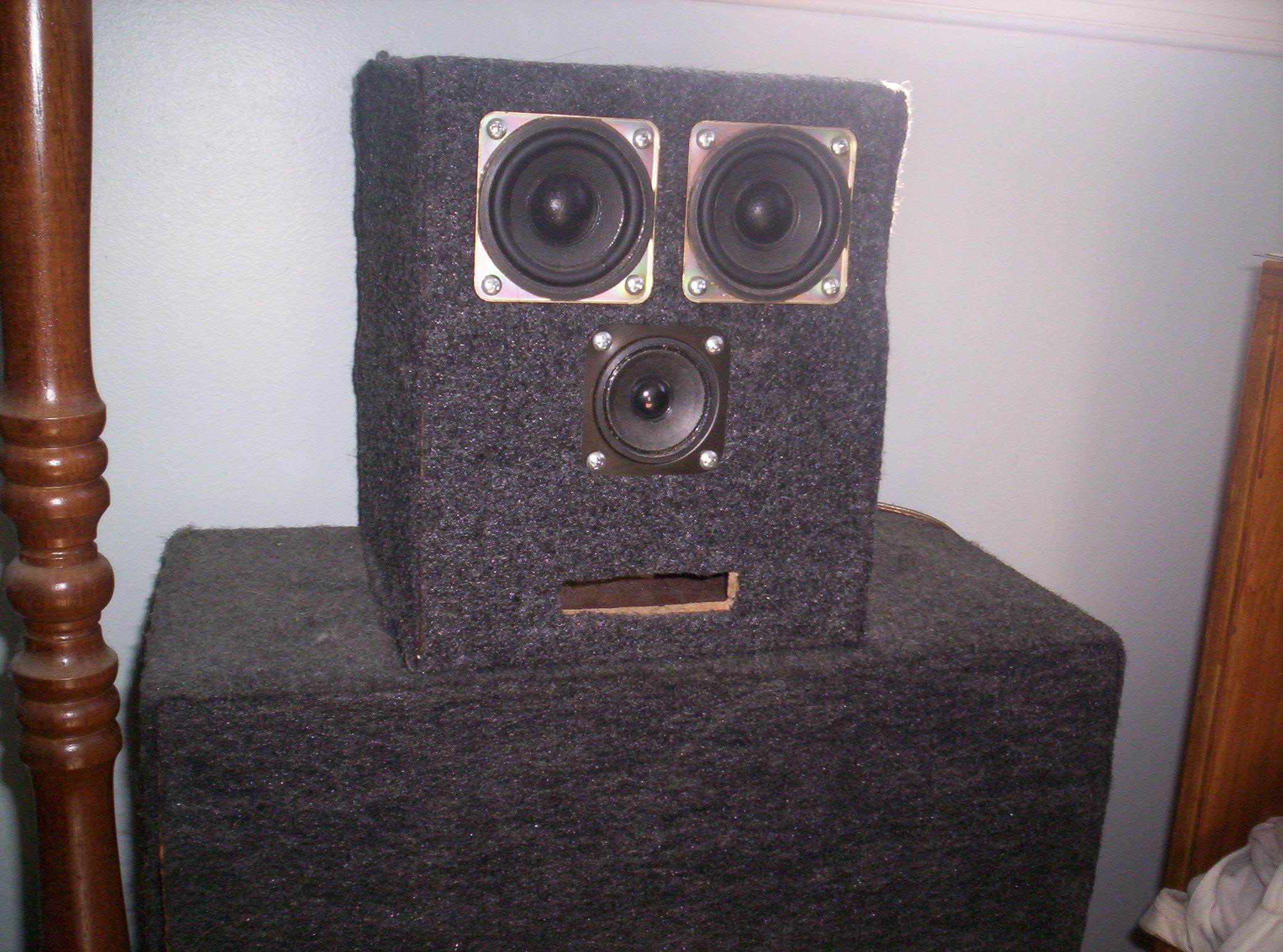

Does any one know why Fried stuck with open cell polyurethane foam and did not use Acousta Stuff in his designs. When I purchased some new Fried drivers from him in late 90's he told me the foam was better. I think it has to do with the way the lines were stuffed. Using Acousta Stuff all of the sound passes through it. The Fried lines were true llines Only part of the sound passed through the foam due to the vertical spacing. I would think there would be less of a time delay at line terminus. Time delay is critical in tweeter and mid bass enclosure and crosoover design. I know from purchasing many of his kits that he developed universal boxes. He changed stuffing density for each driver used in exactly the same t-line enclosure. Not all the drivers had similiar overall parameters. The size of the box was determined by driver Sd and F3. Many people will disagree . I have used wide variety of drivers in these encloures and easily get them to test flat by making a few minor changes in stuffing density. Drivers with Bl of 10-12 and large Vas, low qts., low Fs sound the best. I once tried Bose 6.5" woofer I bought from Martin Sound for 4$ a piece in the C3L cabinet and it tested ruler flat to cutoff as did an old Audax HD17B37R4C12 driver, and Fried Dalesford 6.5" I chose to use the Bose and Audax woofer in a simpler t-line cabinet since the C3L are complicated to build.
I think it was unfortunate Stragiato was banned . I have talked to the guy and he is highly educated. A lot of his opinions coincide with what I derived Fried did in his t-lines. Most forum users I think are buying software and thinking they are producing ruler flat t-lines. The types of t-lines vary from from the type of design they are derived from. There is more then one way to design a t-line. Look at all of the Speaker Builder articles dating back to Gary Galo in 81. Bailey's Radford designs. Whose t-line design is the most acousticaly correct . Are any forum users members of the Yahoo T-line Group. Many people I have come to know have patents and copyrights on their t-line designs. There is far to much hype over their design. I was fortunate enough to become a Fried speaker customer at age 17. I live 25 miles from where Bud sold his speakers on City Line Avenue. I had many conversations and visits with him over the years. It was pretty easy to know when I was correct on his theory designs by his change in temperment. I have been building designs based on his work since the early 80's. Fried sold the business and relocated to Norristown,PA . The first owner Bud sold the company to wants to remain anonymous. Later Bud sold it to Shaynet Tenace. before Dr. Raines became the new owner. I think it unfortunate for moderators to ban some one that might have a higher understanding then them. Most people would rather argue that can't see the trees for the forrest. Try the older Fried designs on imfelectroncis using half decent drivers adjusting foam and measure results the old fashioned way. Look at these designs and do the math. If any one asks what math to do it shows how little they really know. Does any one want to discuss series crossovers?
The link Strangiato posted is correct.When the author states using low cost cheap drivers in t-lines he is correct. Not that I would buy one what do you think Bose did in the Wave Radio? Bose used cube drivers in 1/4 wave lenght enclosures. I have done the same thing with the same exact drivers. Maybe this forum isn't for helping each other out. I try to give my fellow man helpful information to improve his listening experience. Many forum users are trying to put themseleves on a pedastool. Martial arts, powerlifting, or becoming a skilled marksmen might be a bit more challenging experience for these people rather then speaker building. I try to learn from other people's postings.. Every one can learn from each other's experiences. Most of my friends in the business stay away from forums. I can see why.
