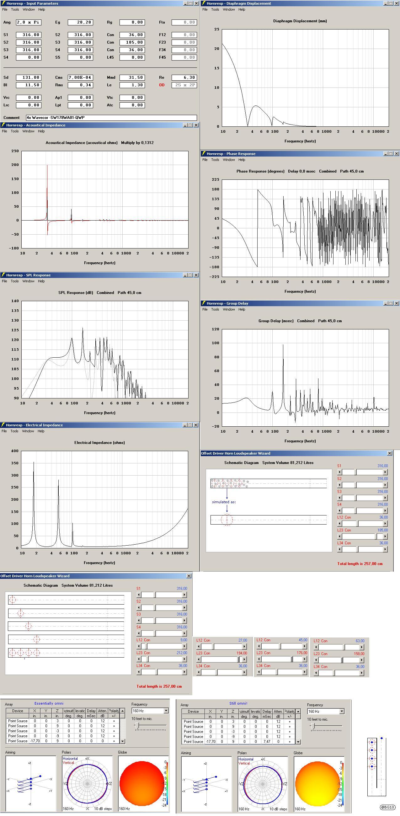

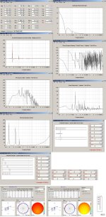

Of the two sim's above, the bottom one is essentially the same as posted earlier. It includes a port length of 5".
The top sim needs to replace the previous which was posted incorrectly. I chose an image I had saved from my earlier work without checking the background...I beg forgiveness...
The top sim above has a port length of 2.5 inches. That is the only change. Some work could be done to smooth the bumps @ 200 hz and the knee @ ~40 hz. For simplicity I chose not to.
Both display the same infinite baffle response, ie. the blue dashed line.
As they are, I believe they support my assertion that the MLQW design process allows tailoring to a desired response to complement room gain.
When was it ever in doubt?

GM posted: When was it ever in doubt?
I wondered after posting it that I was stating the obvious. However, I know for myself that it only became obvious after doing several sim's.
Some things I just need to see and manipulate to gain an intuitive sense about them.
